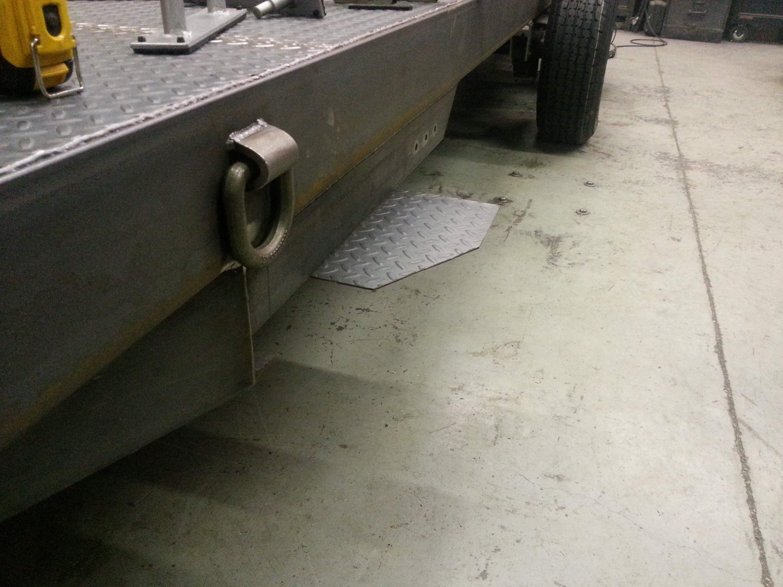

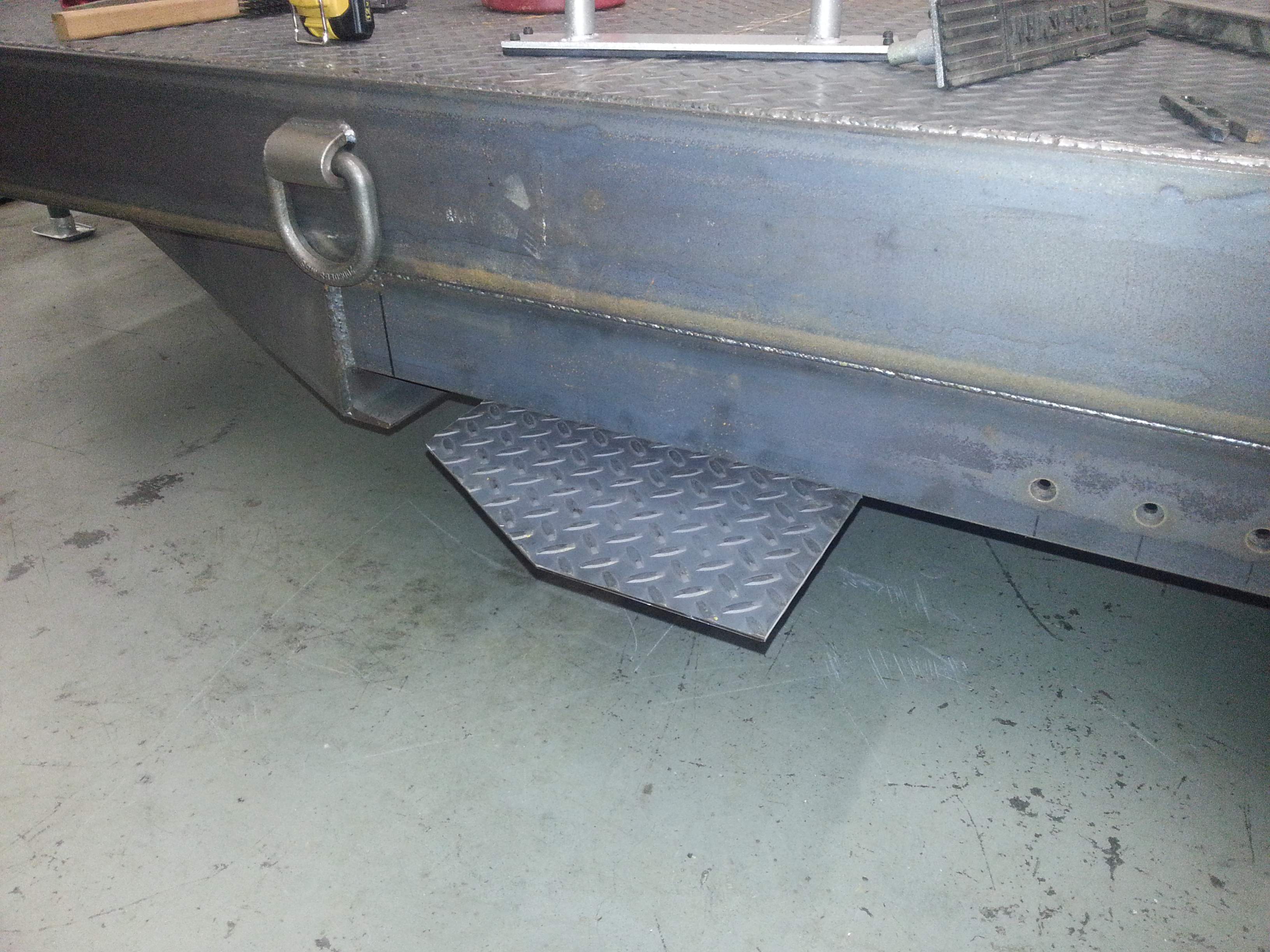

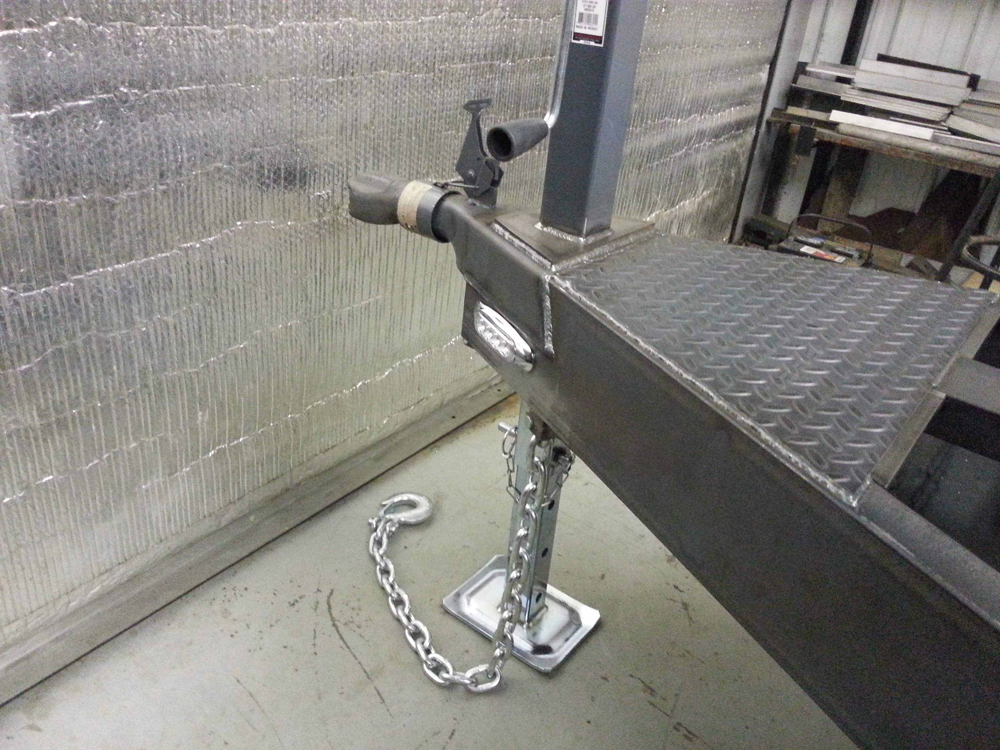

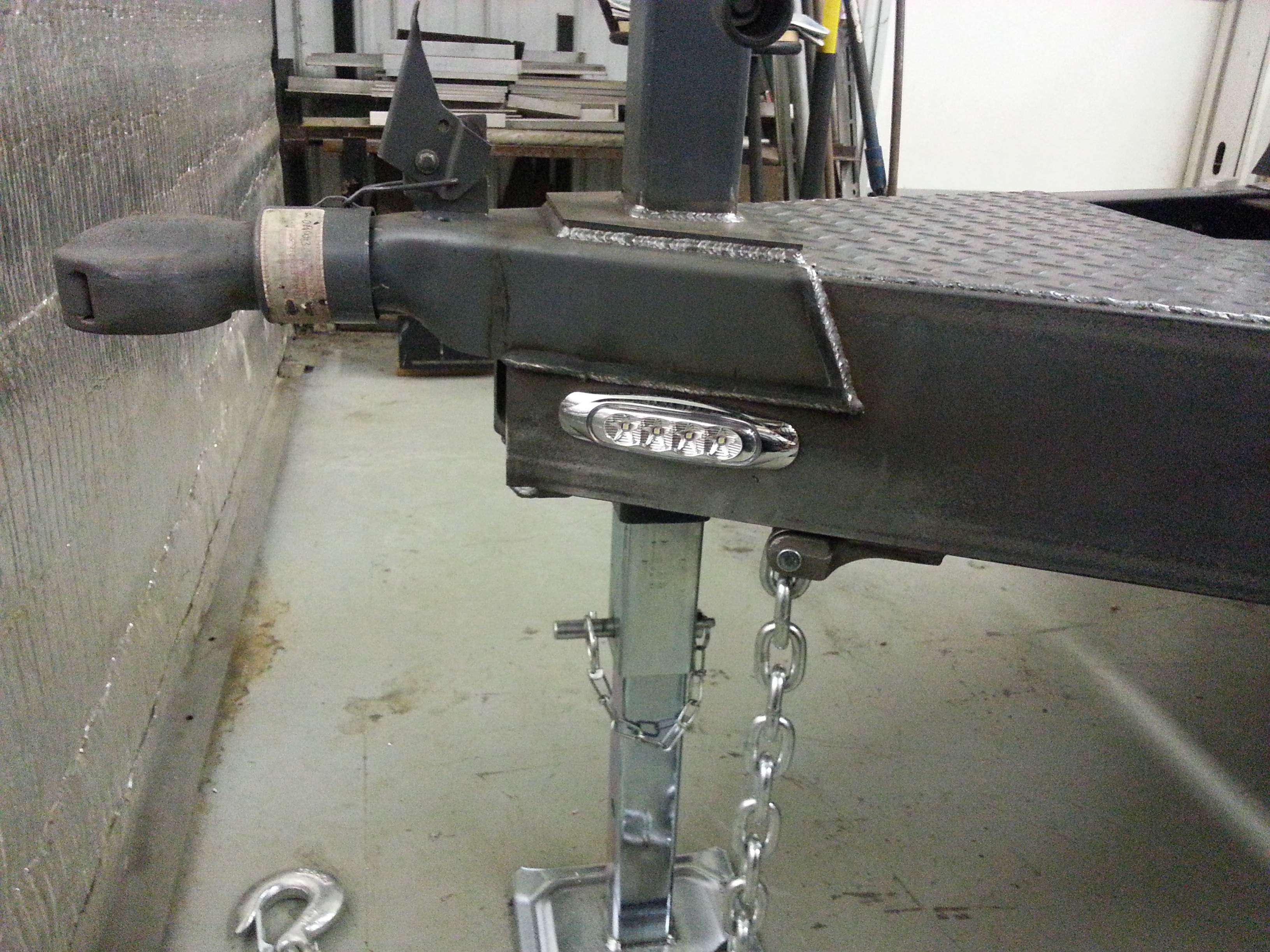

I reworked my safety chains, got the old mounts off with my grinder and welded the new connectors on.

I also added a hitch light, not sure if it'll work with the angle its at, we'll see, I hid the switch under the trim piece of diamond plate. I also added a light inside the toolbox, hope to wire it so it come's on when the lid raises. The weather is supposed to be good Wed. and Thur. and i'm off work...time to paint.

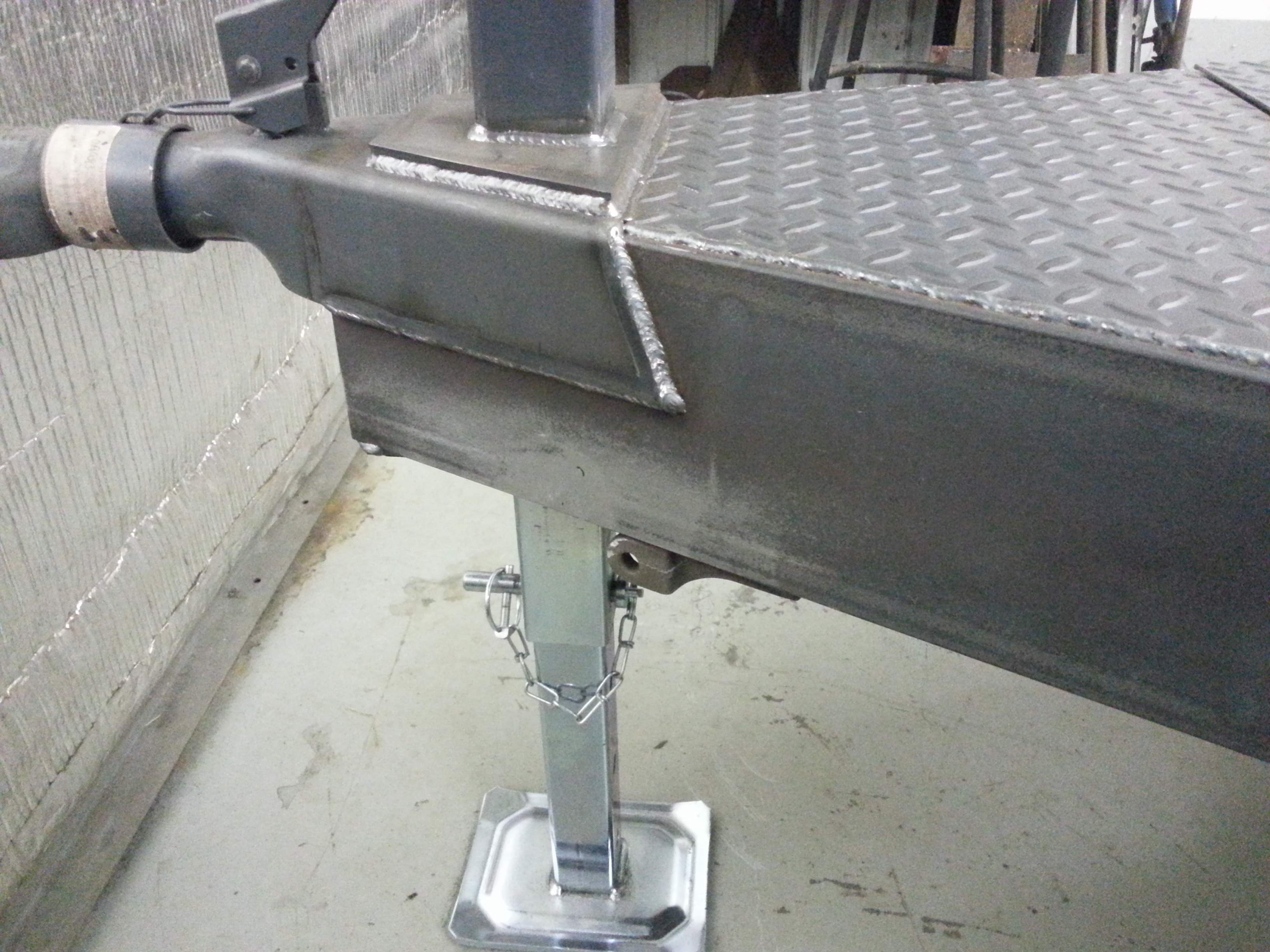

have you thought of adding a hanger in the side of the tongue to hang the safety Chains from when them trailer isn't hooked up? Something so they aren't just sitting on the ground?
/ Split-dovetail car hauler trailer
#252

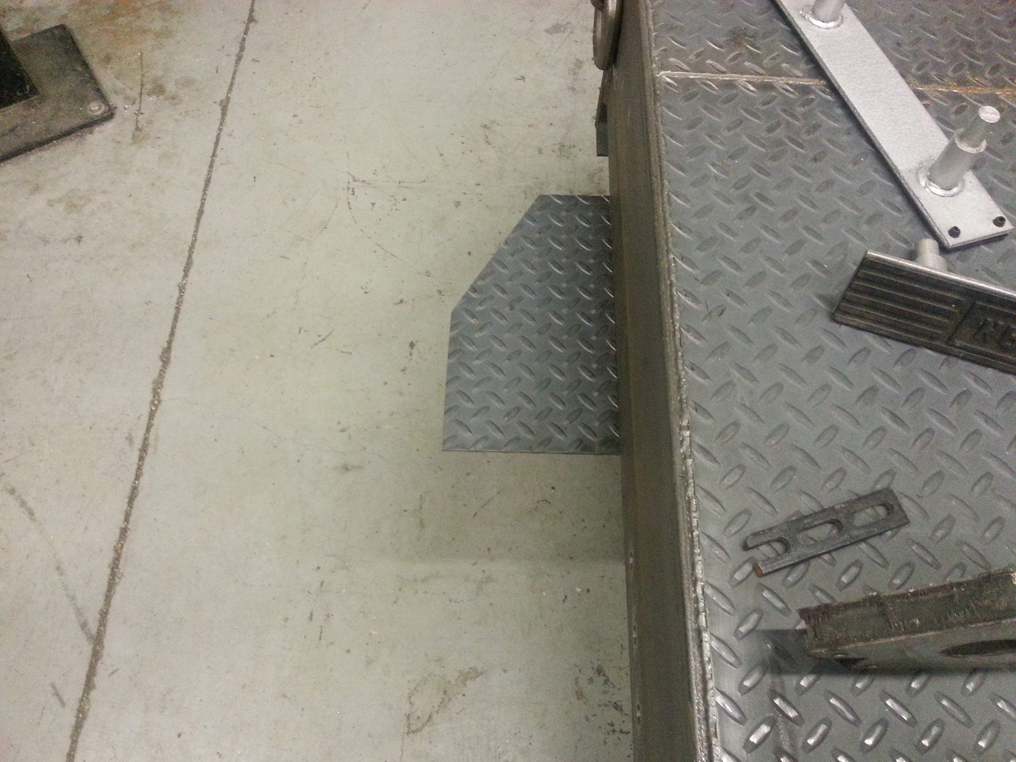

I already did.

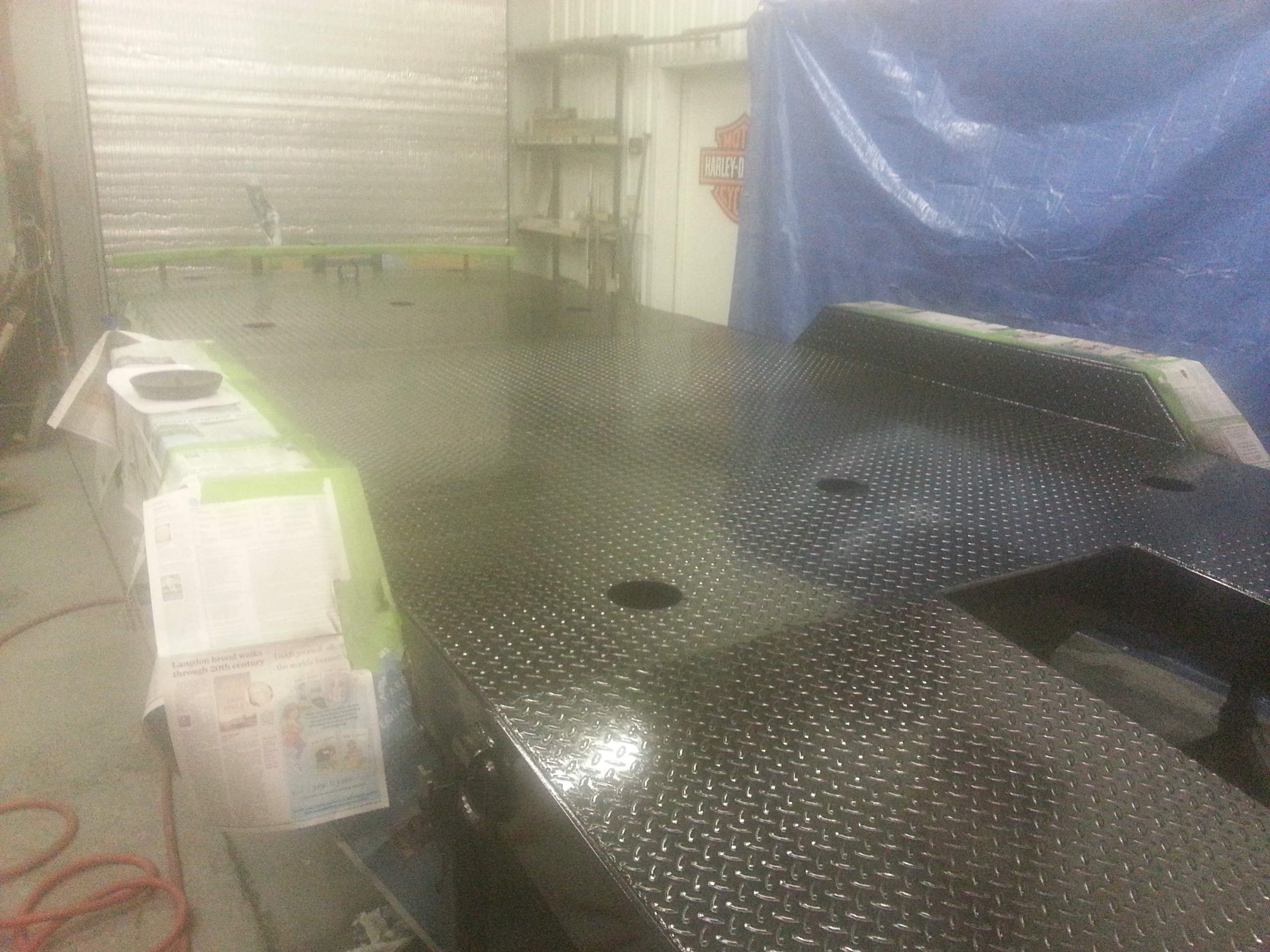

I decided to use this paint for the underside, I figured i'd waste a lot of it trying to get it in all the nooks and crannies on the bottom. I didn't want to chance getting it half painted and it getting rained on, so i'm painting it in the shop.

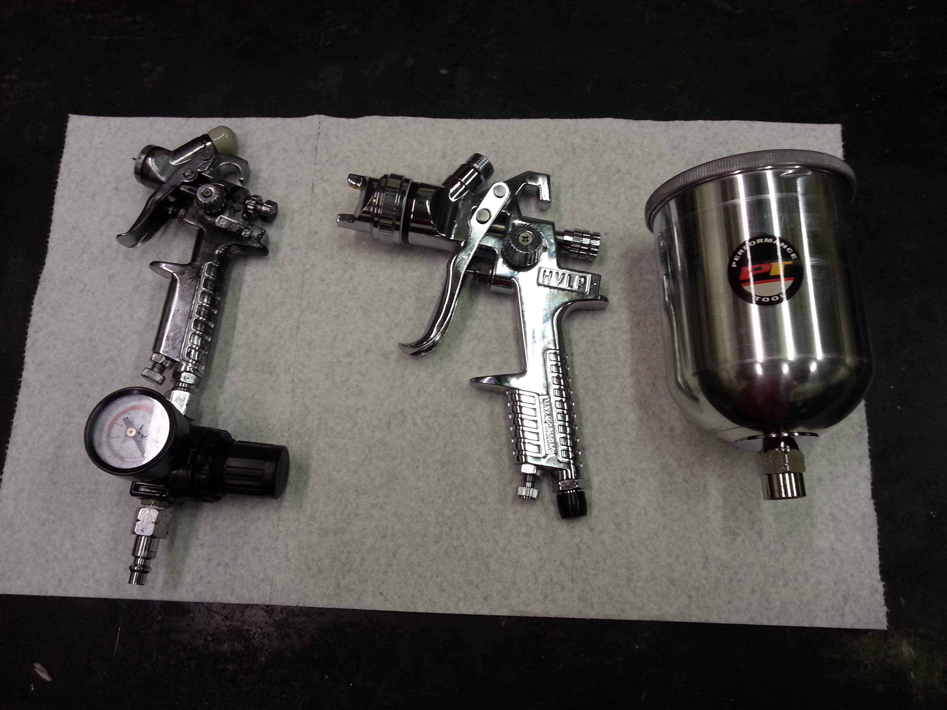

I had to buy a new paint gun, the one's I bought from Lowes were basically junk.

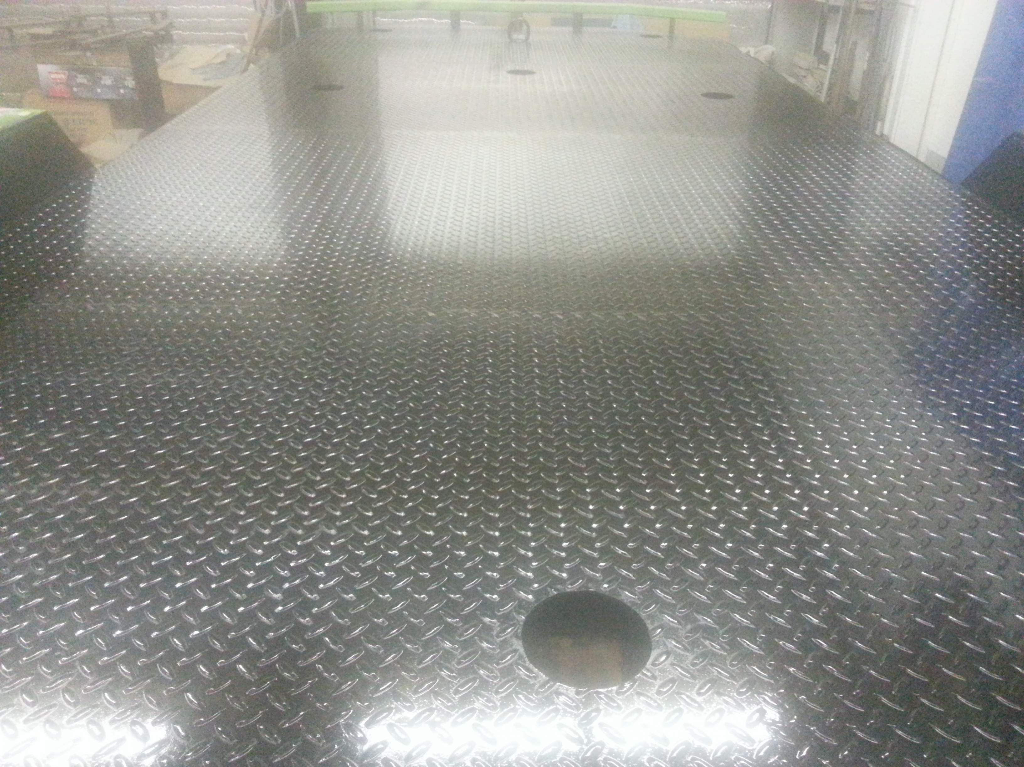

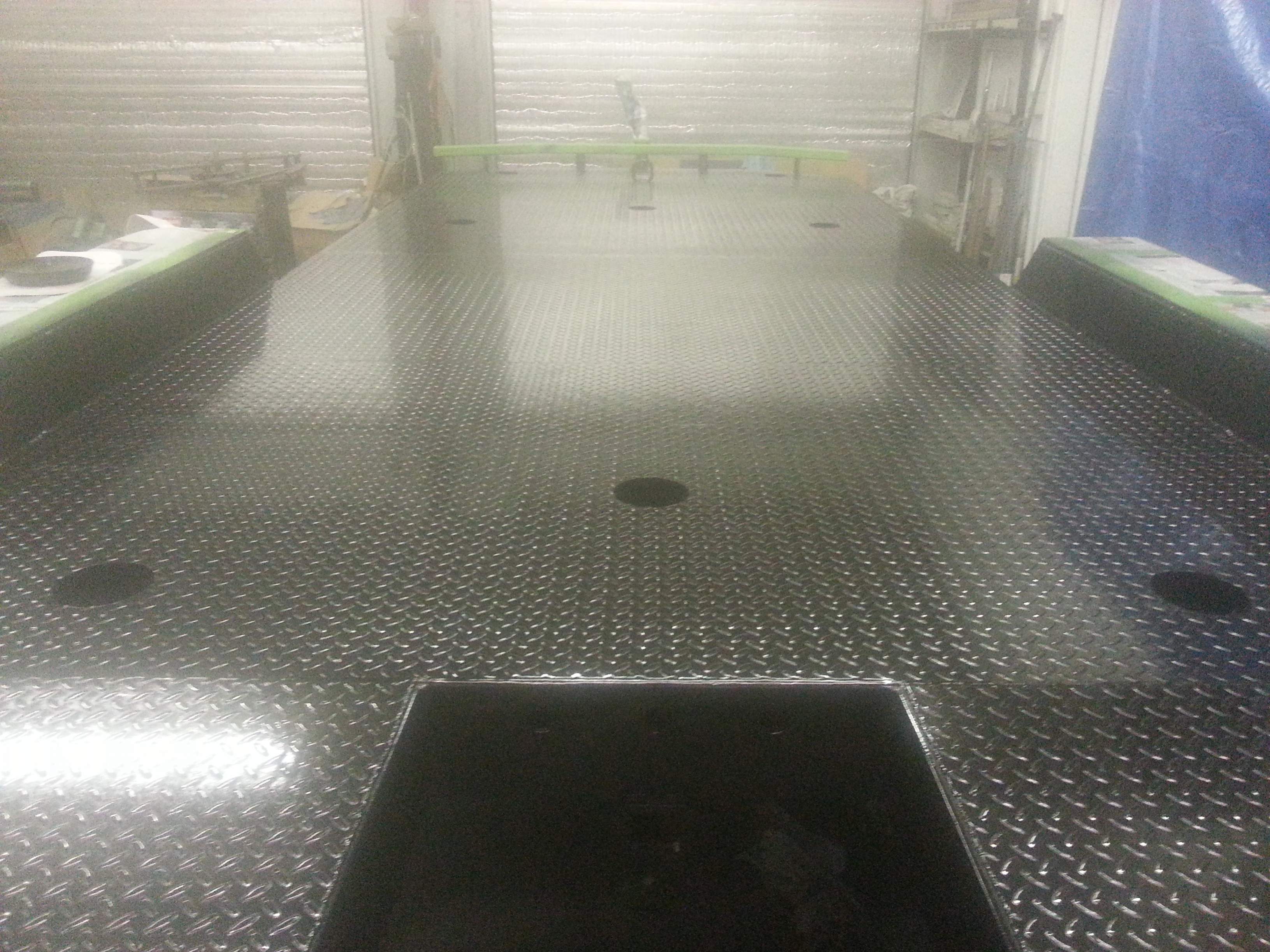

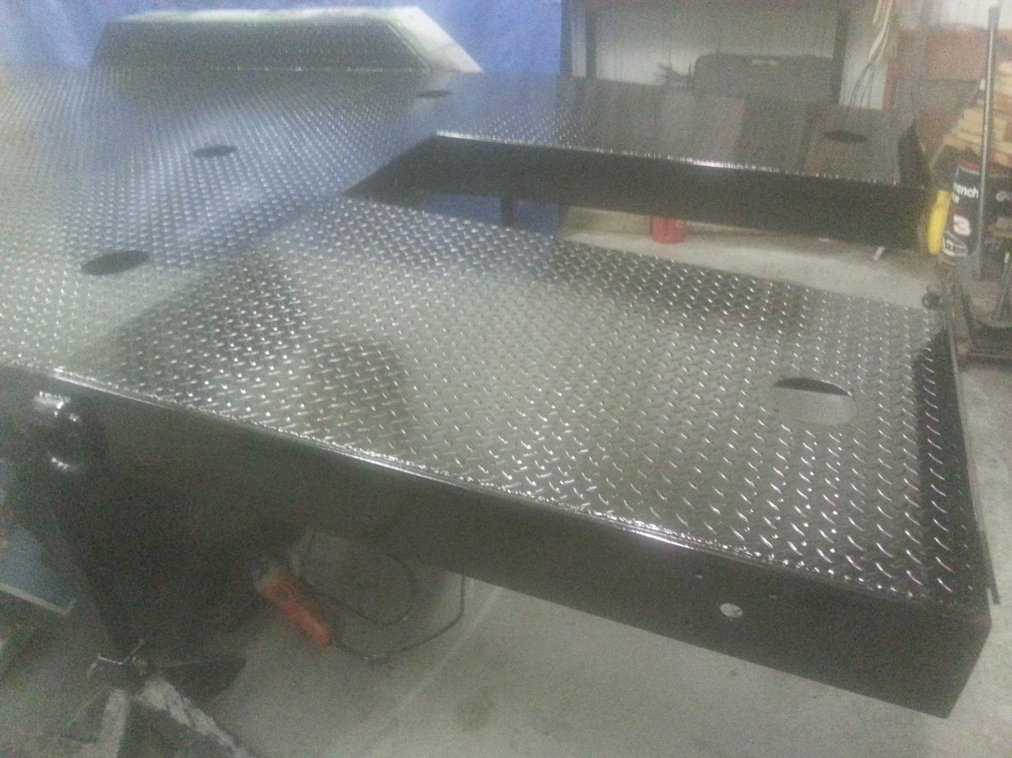

After wire brushing the entire trailer with a grinder, blowing it of, washing it with simple green, spraying on the priming etch and rinsing it off with water, letting it dry good, I started painting. I masked off the sides and fenders and with booties on to cover my boots I got right on the deck and painted the whole thing from the front to the back. After the rust coat dried, I did the same with the top coat. When the deck was dry, I masked it off and did the sides and fenders pretty much the same way I did the deck. I used a box fan to help vent the fumes outside. It worked pretty well.
