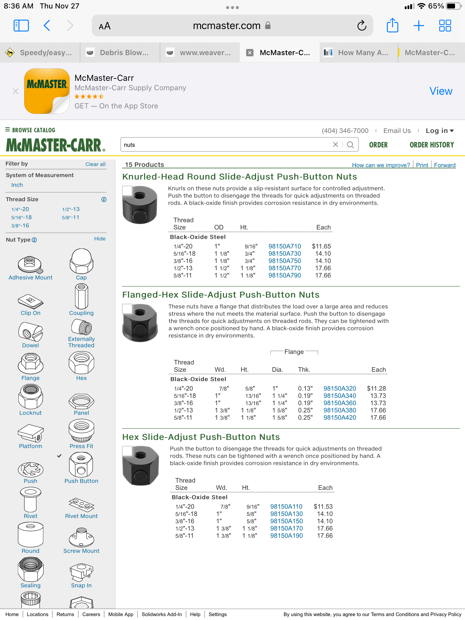

McMaster.com search latches. Might see something you like, there's a lot.

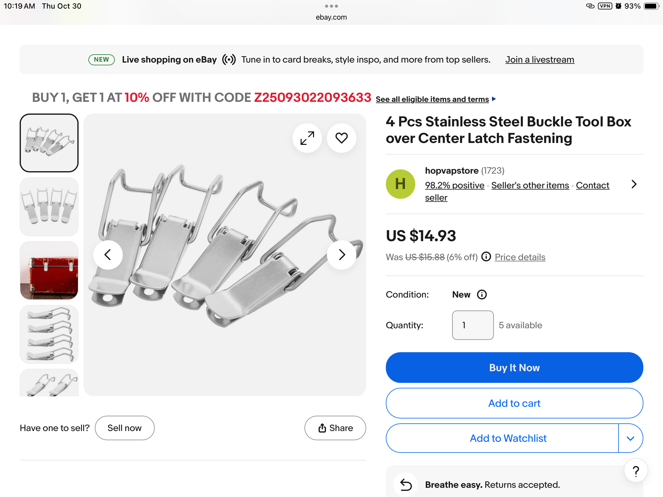

This is more specific to my UTV than my tractor but I am trying to find a replacement for the 4 wing nuts and screws that hold the battery cover on. In my mind there must be something like the clamps on my tractor's air filter where it is as simple as flipping a piece of metal in the opposite direction to release. I thought of using a hairpin and bolt but I am thinking that is going to be too lose of a connection. The wing nut holds the top down tight. I would need something similar.
Can you give us a picture?
/ Speedy/easy replacement for wing nuts #25
Something like this? Metal toggle latch.

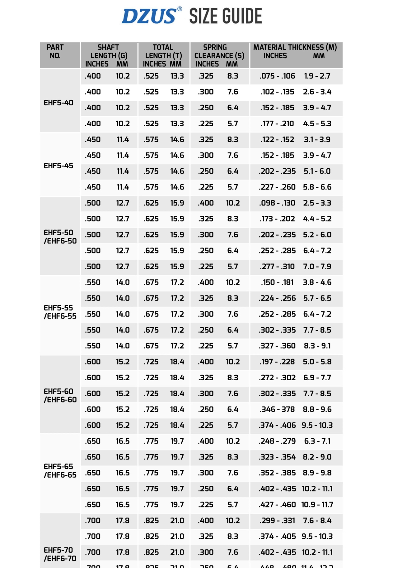

/ Speedy/easy replacement for wing nuts #29
You want aviation DZUS fastners. They can be wingnut style or slotted screw head, and are captive, won't be lost when you loosen them. Find a local aviation mechanic or a race car body tech. Or you can buy them on line and put in yourself. Need 2 3/8 holes and 2 pop rivets to install. Look them up.
Every aircraft mech hates ZDUS fasteners. They have to be the right length for the two panels and if you bend the wire that goes across the hole (because you didn't line up the screw with the wire before pressing down on the head and do it multi-able times) then then the wire will brake and you need to do it all over again.

Amazon, search for, "Quick Release nuts and bolts"
Lotf of different stules

The issue with DZUS (1/4 turn) fasteners is that they don't have any adjustment range, to speak of.
They do not, you do need to buy the correct combination of parts for what you need done. Not like they only make one type, lots to pick from.
