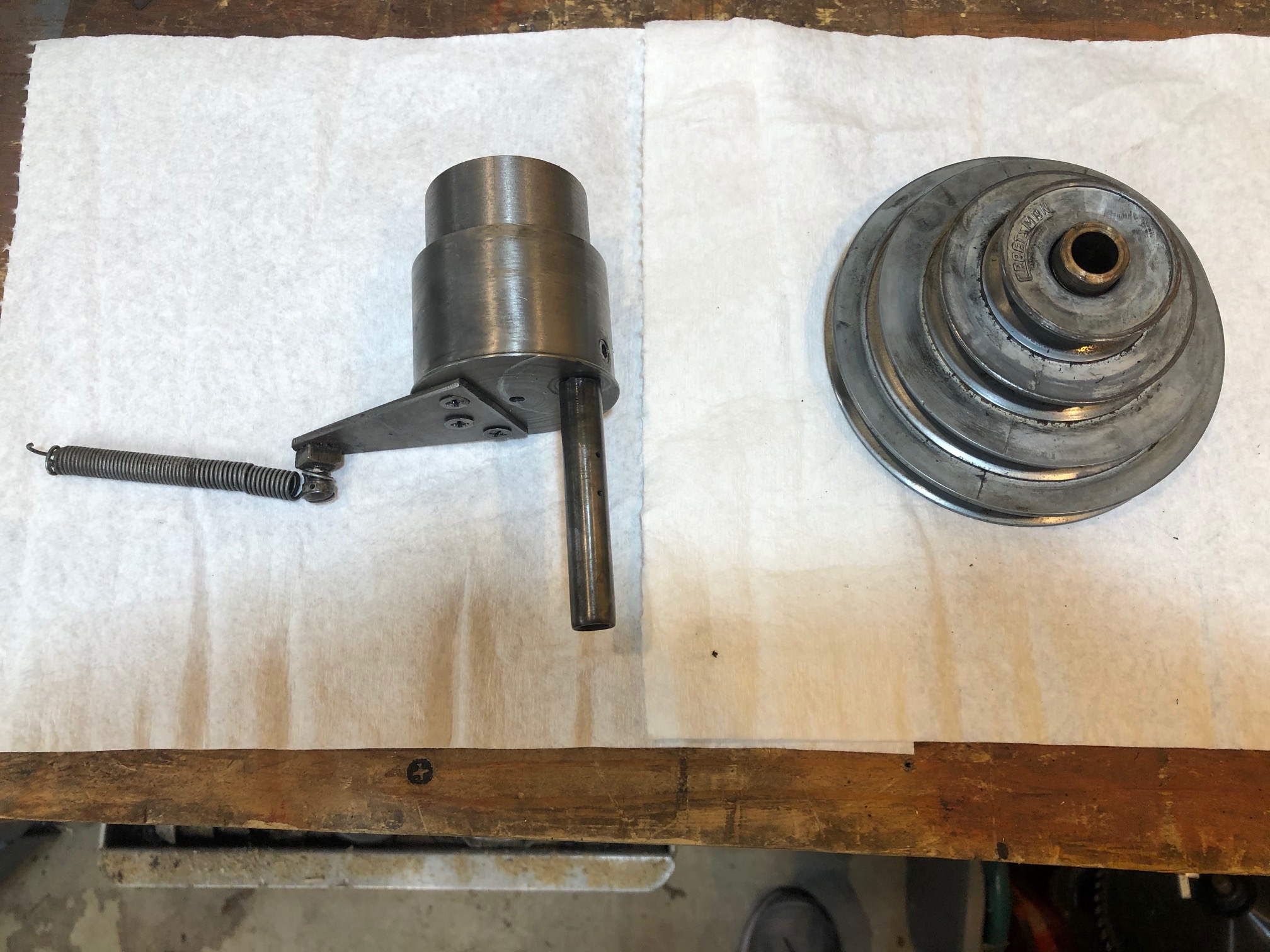

I have an old Craftsman drill press about the same vintage. Someone added an intermediate pulley. The pulley goes on an arbor that is mounted off center on a plug that just drops into the upright tube. Very slick. Spindle speeds down to 290 rpm and much higher that I never use.

Like SR said mine is pretty routine but that little gem is really really clever. All you need is one small pulley for the motor and two new belts. And if that plug is free to swivel in the tube both belts tighten at the same time with the adjustment that is already there. Too simple.
gg
