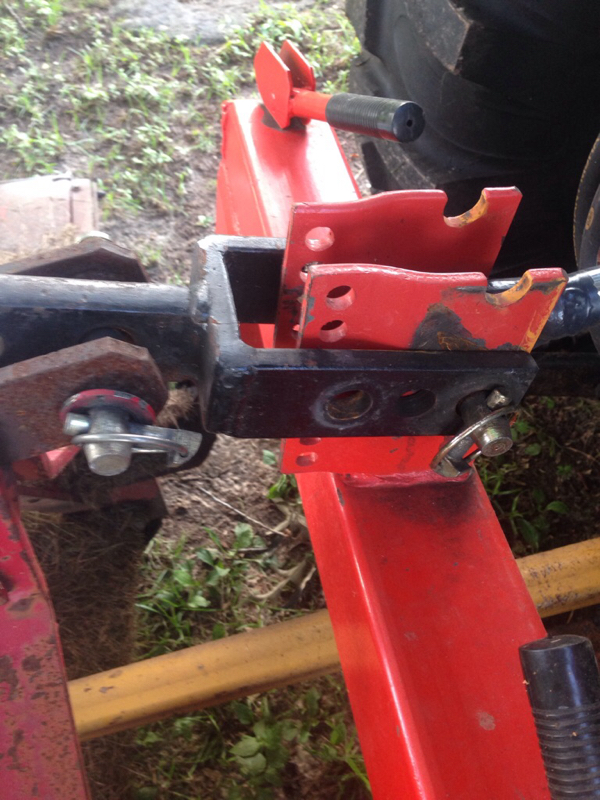

There is an extra piece that attaches the top link (especially a floating link) of the implement to the quick hitch, to provide a positive connection. Needed sometimes to prevent the top link from coming loose! HF has it available, but the part number isn't listed on their website. I've not needed one, and will make one if the need arises.
Top Hitch Adapter-Quick Hitch

The link as I call it is used instead of the hook it looks like a y with the bottom of y being rounded they are available at Rural King and Agri Supply about 20 bucks it hooks up on top link where it pins to QH stays on unit when you hook up to lower pins then you put pin in Implement gives more adjustment than hook hope this helps probably clear as mud I have found it much easier than having to have every piece of equipment modified to fit hook

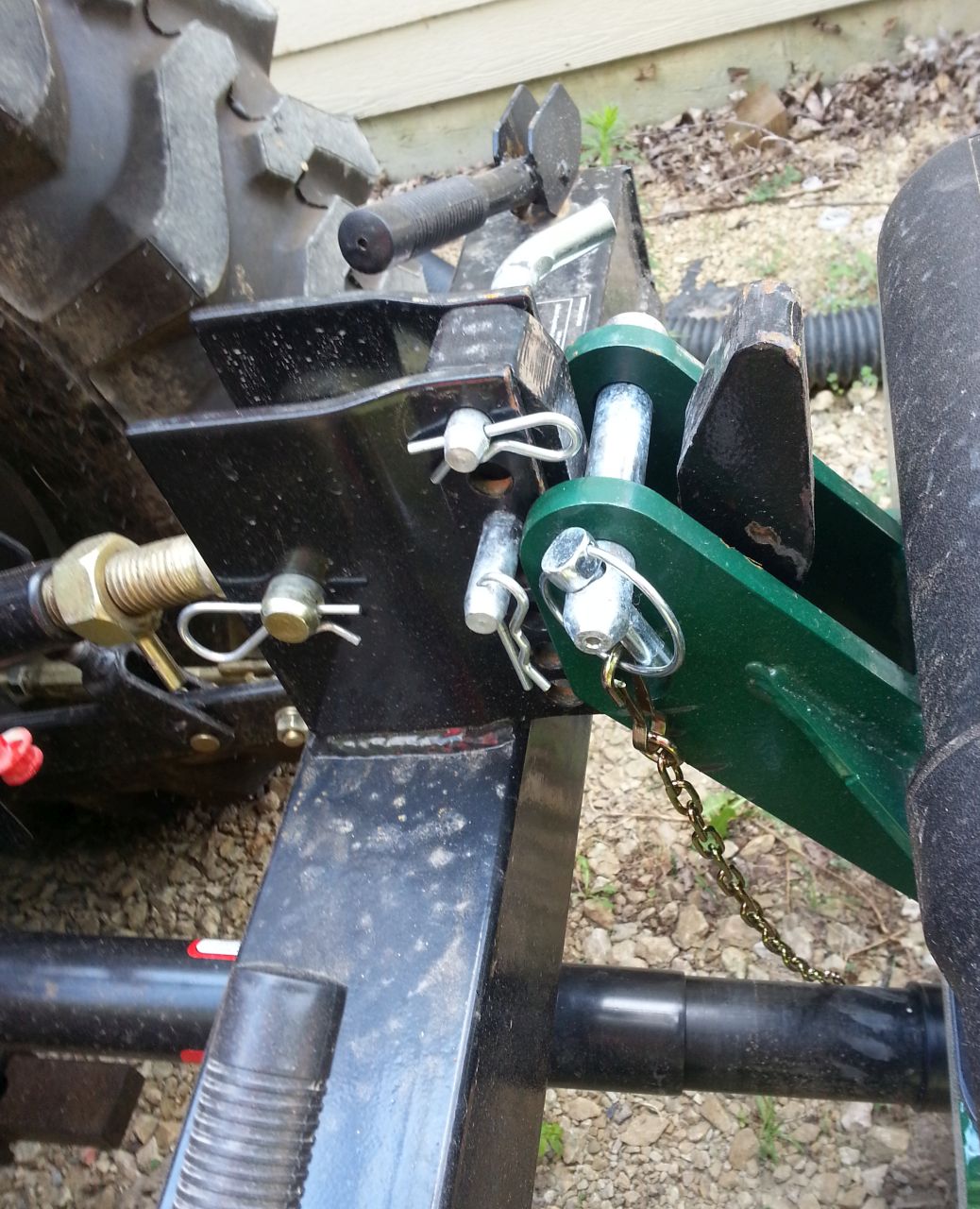

This is the adapter they are referring to, I built this one and it's all I use.
