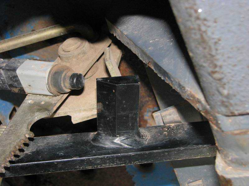

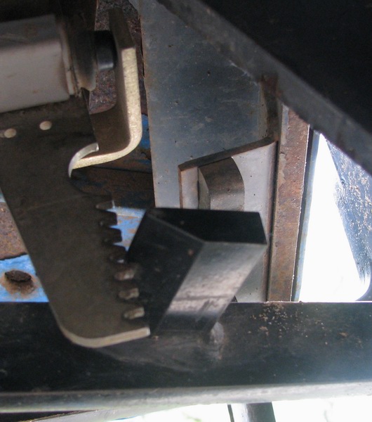

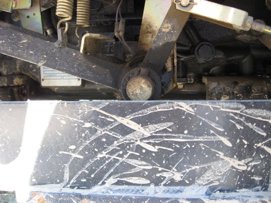

Success! Well. . .sort of. I got two out of three clear pictures. The one with the pawl mated to the wedge is slightly out of focus, but you can still see that even on my tractor the fit is not perfect. As a matter of fact, the pawl is not perpendicular to the wedge. If it were twisted just a little, it would fit much better. Anyhow, you can clearly see that my pawl teeth are not worn and that my wedge has no V-cut in it. That really has me baffled. Now, I want some others folks to crawl under their tractors and give us some feedback to see if their's is more like yours or mine. This is getting interesting.:confused:
EDIT: I also noticed my pawl has a half-moon shaped cutout that yours does not have. That must have been in the original part to allow clearance for the pawl to engage, but there is no reason for this cutout even on my tractor. On later parts, they must have eliminated the cutout on the pawl as your photos show, Charles.

Charles, your wedge looks like someone cut that notch with a grinding wheel. The pawl teeth are worn a lot if it's from wear, no matter how soft the steel. I wonder if the previous owner tried to improve the design and really messed it up.

Jinman & Ford850, Seeing Jinman's photo I am convinced that we have the same parking brake design with our NH TC45's. I thought that the groove was supposed to be there, but now I see that it was never intended to be there. I am now convinced that both the ratchet pawl and the wedge were made from very soft metal, and both are showing extreme wear. I can't solve my problem by replacing the ratchet pawl alone, the wedge also needs to be removed and a new one welded on. This is definitely a case of two defective parking brake parts causing a very early and predictable failure. Pictures speak louder than all the words that I have tried to use to describe my problem, and Jinman's pictures show me what things should look like if properly manufactured. Thanks for this clarification. Anyone else like to weigh in on this?

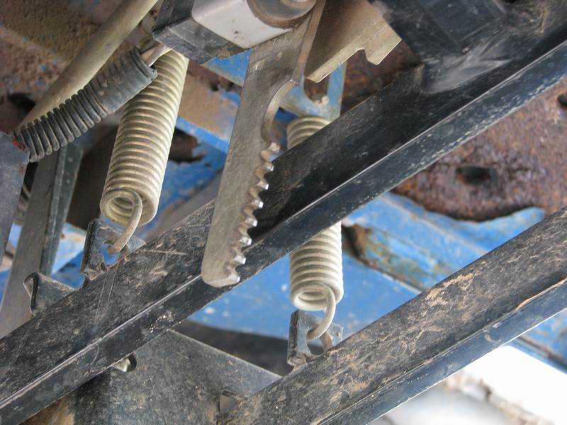

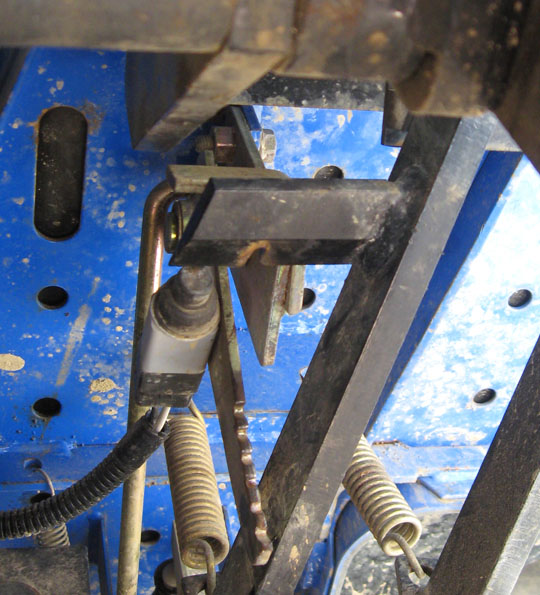

RickB & Jinman: Today, I was going by a Kubota dealer and saw a lone blue tractor there, so I stopped with the idea of checking out its parking brake. It turned out that it was a TC55, the same year as mine, a 2006. It had the same design as my TC45, not a big surprise. Its parking brake was in pristine condition, but then I checked the hours on the tractor--it had 38 hours. I inquired about the price; $21,500 with 2 rear remotes, 18LA loader with large quick attach bucket, and a rear 5 or 6 pin electrical jack (what is that all about?). Looks like a deal! However, let me get back to the parking brake issue. I looked at mine again, and hope that I can get some new ratchet pawl and fix it myself. Changing out the parking ratchet pawl looks straight forward, as RickB described. Getting the parking brake off so I can "seal" over the groove in the engagement tab that is welded to the pedal shaft is not as straight forward. It looks like I would need to do the welding and grinding with the pedal still in place. That is, unless I want to remove the Woods backhoe subframe. Some pictures, below. Is nothing ever simple? RickB, is brazing and grinding the tab with the brake pedal in place something that you would attempt--that is, should I attempt that? I just went out and purchased a grinder, hoping to do this, and hope I can convince a neighbor with a welder to do the brazing. When I look at that groove in the engagement tab, it suggests just how soft that metal must be. If I tried to do that with a blunt saw I can't believe that I could have done a better job of hacking into it.

Brazing yields a soft metal deposit that probably would not last. My suggestion to use a MIG weld was based on my experience that the average MIG wire leaves a relatively hard deposit and the process can provide some hardening to the parent material.
Even with just a 16LA loader I had to drop the loader support running back to the rear axle in order to remove the pedals.
