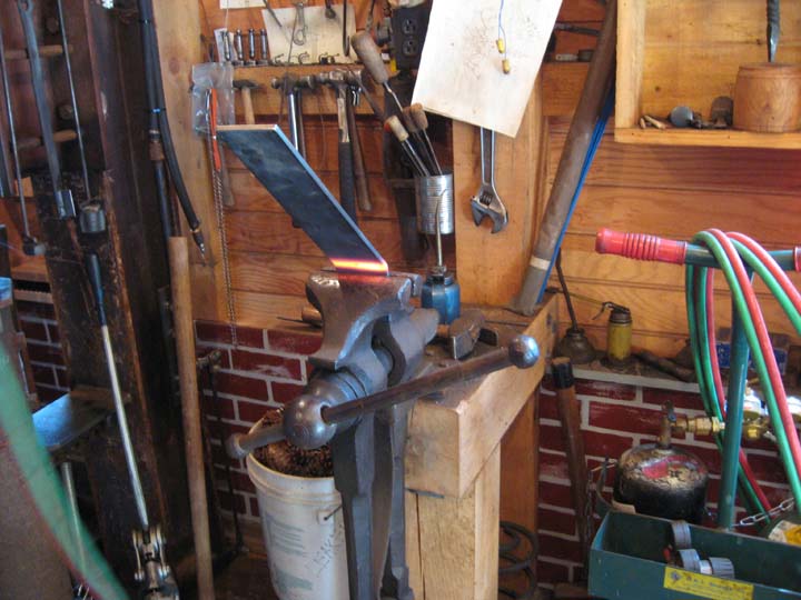

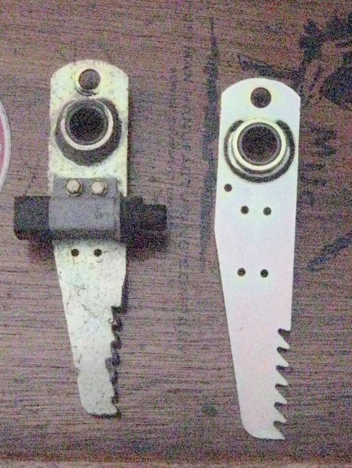

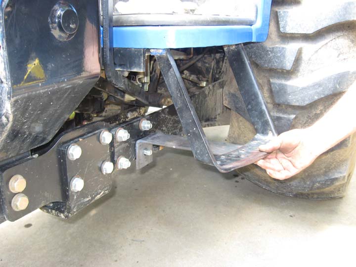

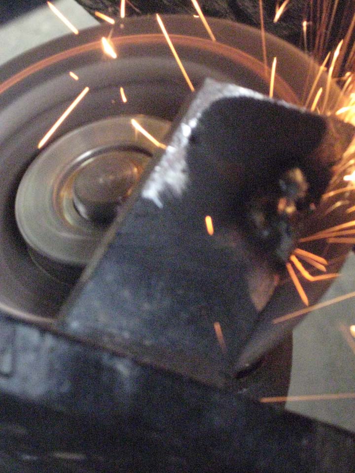

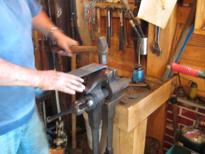

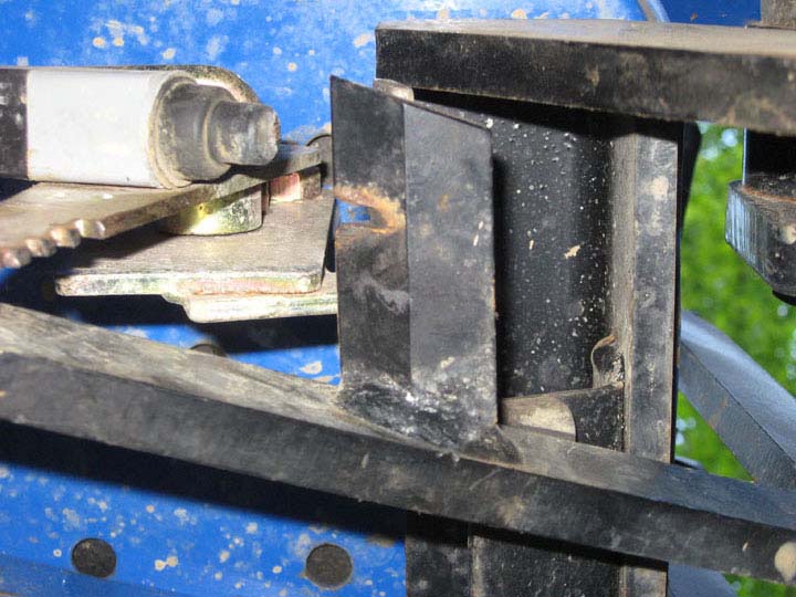

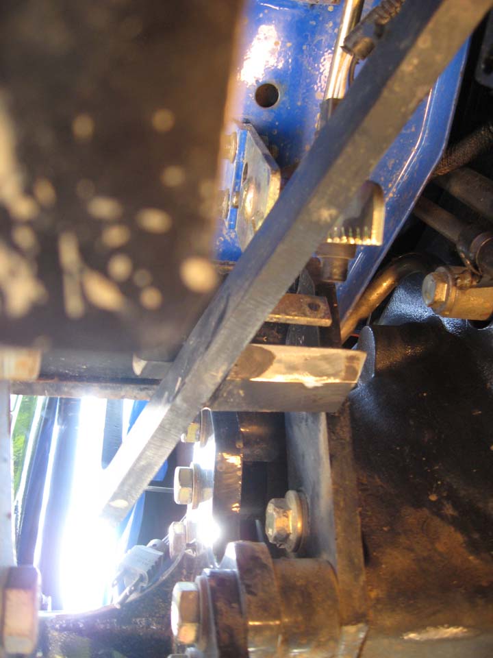

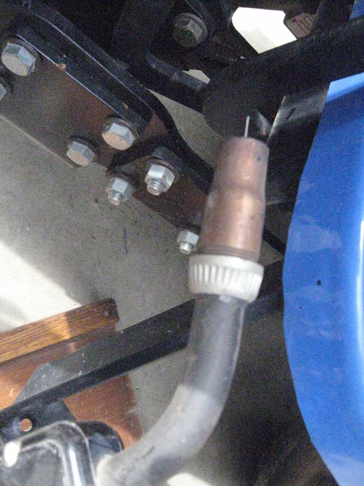

In my last post for this thread I indicated that my cousin Gary offered to help me resolve the parking brake problem. We have now done that and I offer a few photos to illustrate what we have done. The first photo shows the parking brake knife with a V-groove, which we think someone ground into it in an attempt to keep the parking brake from releasing when the operator's weight flexed the platform stepping on and off the tractor. The second photo shows the old (left) and new ratchet pawls. The old pawl still has the actuator attached. The new pawl doesn't look like it should cost very much, but its delivered cost was $63, the best deal I could find. The third photo shows the MIG welder that was used to close the V-groove in the brake knife. The fourth and fifth photos show the knife being ground and the finished knife edge. When the new ratchet pawl was re-attached it engaged perfectly with the rejuvenated knife at the third and fourth teeth (depending on how hard the brake pedal was engaged). We had one more thing to accomplish, which was to add a support to the steps that would eliminate platform flexing, which often results in parking brake release. Photos 6, 7 and 8 show Gary in the process of heating and bending a 5/16 steel bar to reinforce the steps and platform. Photo 9 shows the reinforcement bar being attached to the steps and the one of the bolts on the subframe. This setup did eliminate the flexing/parking brake release problem. Hopefully, people with similar problems will let their NH dealers know that there is relatively straight forward correction. This is the first time since I have owned the tractor that the parking brake has truly worked, and it feels like a new tractor!

Nice work Charles. It looks like you and Gary really used your heads and made some big improvements. Thanks for the detailed photos too.:)
