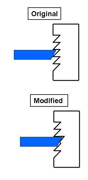

Yesterday, with some time for goofing off, I crawled under my tractor and looked at this parking brake issue. As I suspected, my teeth on my pawl are not worn whatsoever. I could not get my brake to release by stepping on the step or flexing the platform. Go figure?:confused: I did notice several issues with the brake. For one, the brake works off the right brake pedal only. If you don't have the pedals tied together, the left brake cannot be set. Also the right arm has a 3/8" piece of flat stock welded to it that is ground down with a bevel from the bottom side, but flat on the top. This makes a point to engage the pawl. I've created a drawing attached that shows this piece. It engages the pawl, but the shape and size of the teeth on the pawl do not allow this piece to fully engage. What I recommend for anyone having a problme is to do a little filing or grinding to remove the tooth below where you normally set the brake and make the tooth above somewhat deeper so the pawl is engaged much more substantially. If mine ever starts slipping, this is exactly what I will do.
I came up with several other solutions, but this by far the easiest to accomplish and I think it will produce the best results. It's certainly cheaper than spending $60 on a new pawl that is doomed to fail just like the first one.

I think you would want to change the tip profile of the blue part.
larry

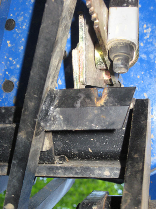

I think I didn't explain the V-Groove in my NH TC45 very well. The ratchet engages with this V-Groove plate, crudely drawn below, which is welded to the brake pedal. Yes, we obviously have somewhat different designs, but I don't think that it explains why my ratchet is well-worn and has failed before 550 hours and yours looks new with 3 times more use. Can anyone think of any other explanation, other than your ratchet was hardened and mine was not? I think with pictures from your TC45 and mine, it would be good to submit this to NH for an explanation. More feedback would be welcome, too. Thanks

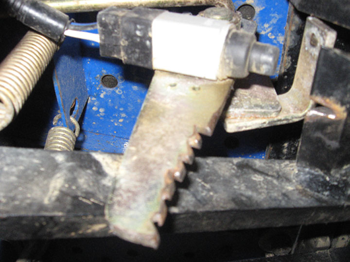

Below are two pictures showing the engagement parts for my 2006 TC45 parking brake. The tractor has 560 hours. The ratchet pawl shows worn and rounded teeth, the reason that it will not hold in the V-groove that is attached to the brake pedal. The question is why this part should have worn so badly and so relatively soon (problems with premature release occured with less than 200 hours) when Jinman reports no wear with three times the number of hours. It would seem that his part must have been hardened, whereas mine was not. Note that the V-groove looks a little rusty, but I don't think it has worn. If this is not the difference, does anyone have a better answer. Others have reported similar problems. :(
