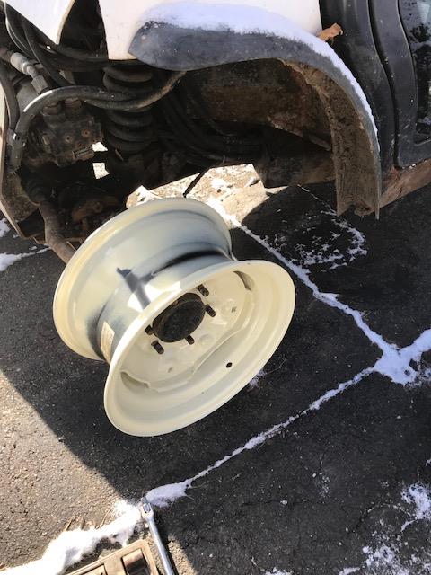

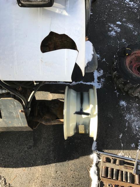

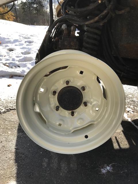

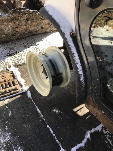

Wheels came in today, I plan on mounting one up soon to verify fitment before I get tires
   / Sourcing Early Toolcat Wheels and Tires
#18
Wheels bolt right on without issue, they are 15x8 with 4 backspacing, 6x6 pattern with 4.63 centerbore. Oem wheels appear to be 4.5 - 4.625 backspacing but extra outboard spacing doesn't look like itll cause clearance issues. I ordered another set of 27x10.50-15 R4 load range D tires for $375 shipped from simpletire. The wheels were just under $300 shipped so I'll be into them for around $700 total. If I have winter traction issues I'll get a set of chains

Here are pictures of one wheel mounted on the front:
