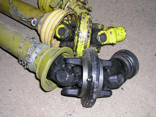

Just notice that use of CV joints significally enlarge length of PTO shaft, or for equal length, telescopic part is shorter, so usable stretching range (extension) can be narrow.

You can get them at nearly any tractor dealer. John Deere, Case or Newholland,
They run about $1600
