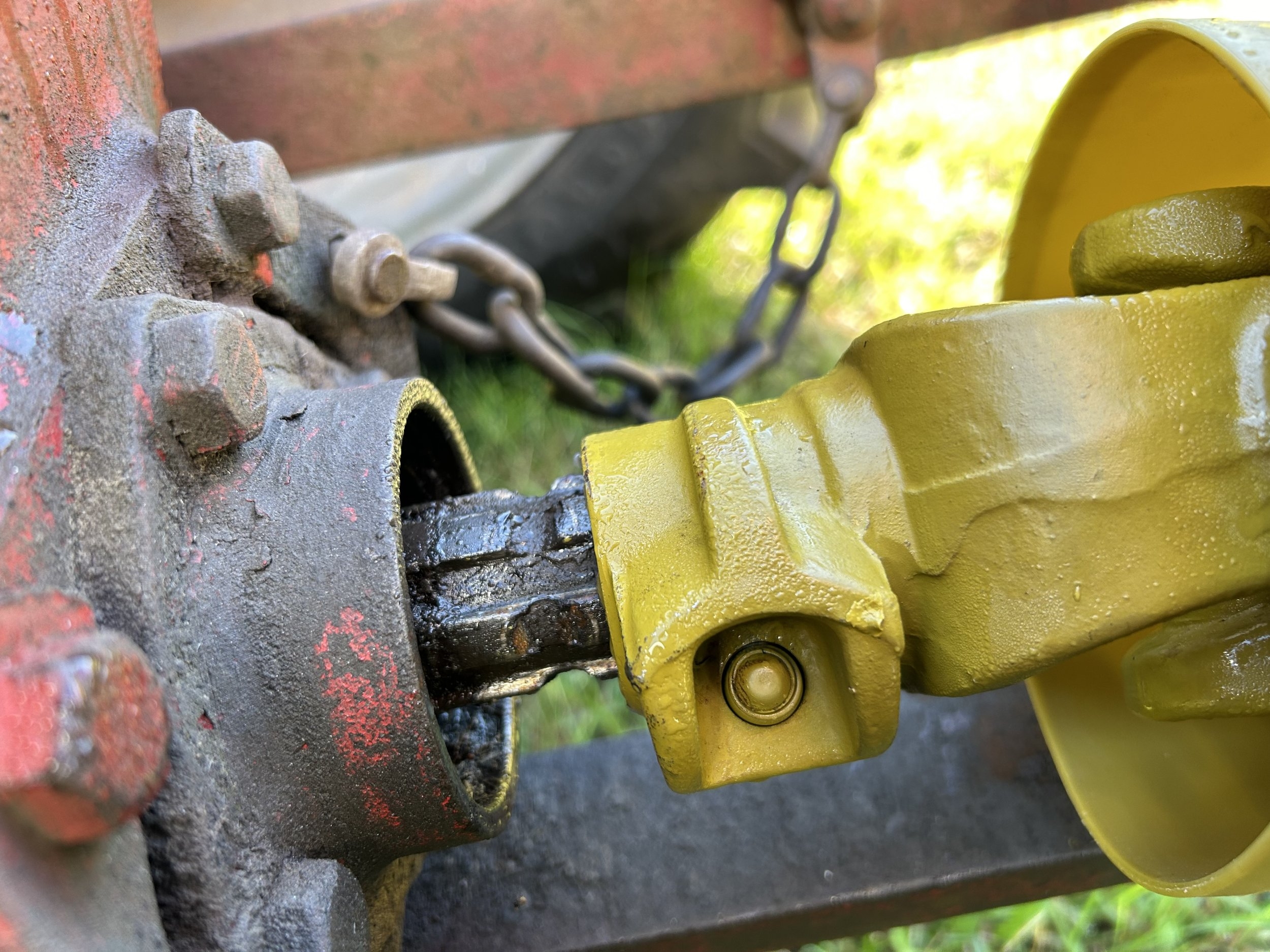

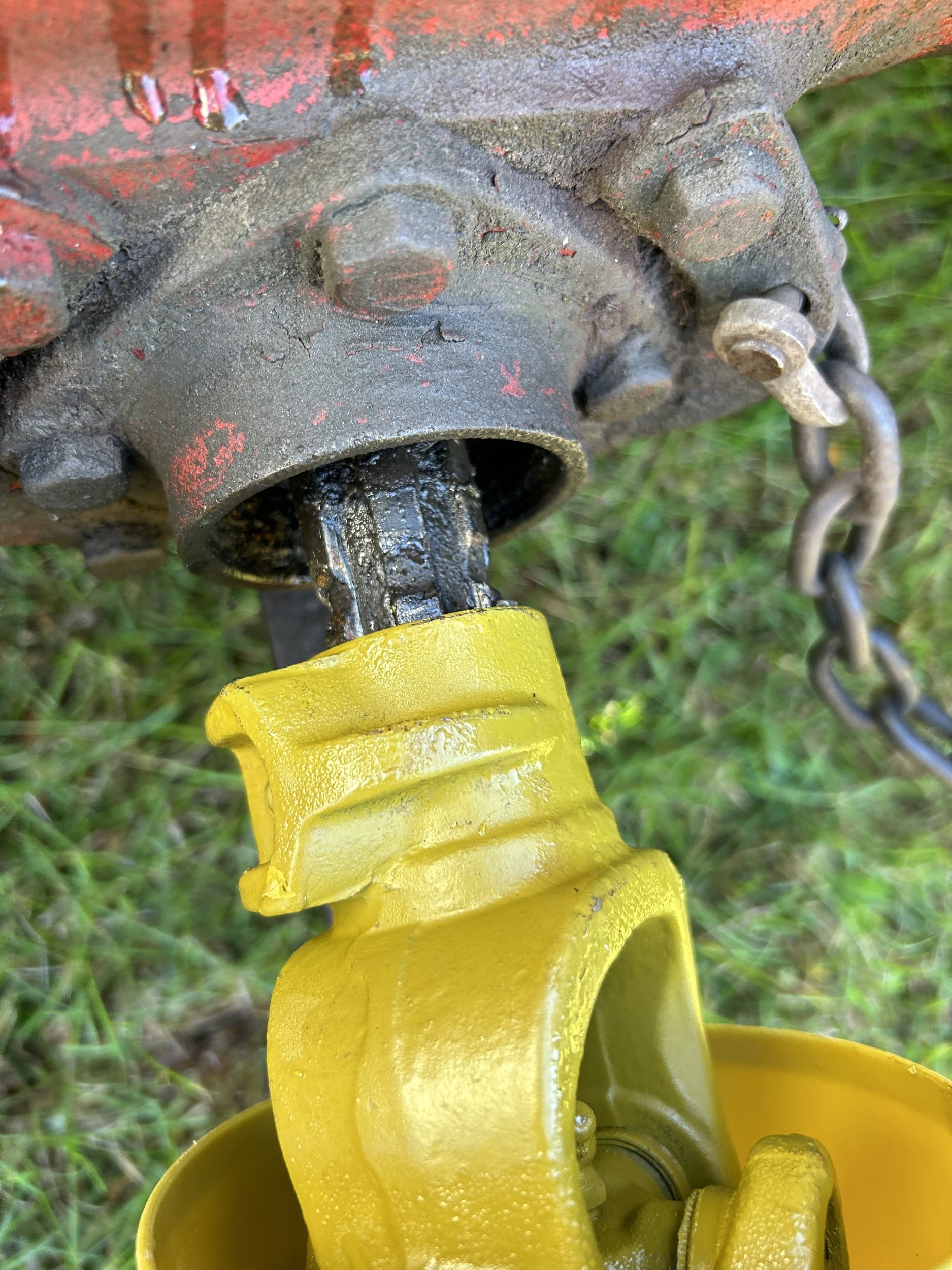

PTO on 8N won’t attach to mower shaft. My 8N PTO has a kind of slight flange around it that keeps the u-joint from sliding on enough to engage the button shaft that secures it. Anyone have any ideas?View attachment 827335View attachment 827336
I would grind away some of the flange around the release button so that the pto shaft fits. It probably won't take much. Most of the pto shafts I've used don't have that protection around the release button. Another option is to put a new yolk on the pto shaft that uses a slide collar to lock it in place. You can find them at places that sell aftermarket parts and equipment.

I have happily owned my 1949 8N since 1992. It is equipped like yours. My advice is install an override clutch no matter what! This will help you mate the shaft to the coupling.

Don't grind anything, don't buy anything expensive. What you need is an over-running coupler / clutch.
1. Will help keep the momentum of the mower blades from "driving" the tractor when you throttle down.
2. Will allow you to make your connection.
