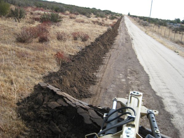

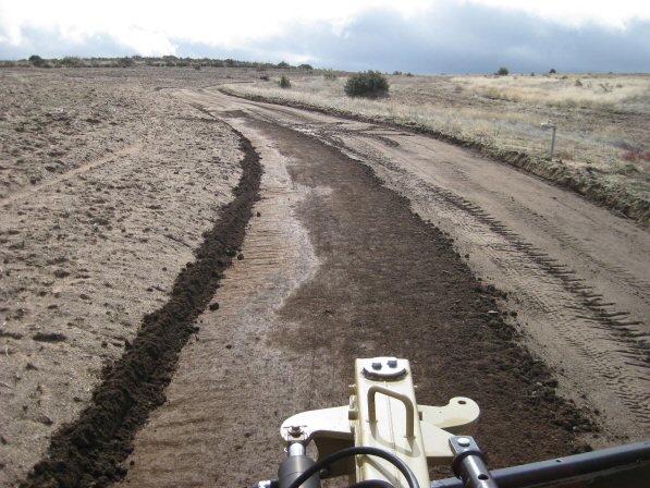

I'm just asking. I don't know why you'd want to pull a ditch in one direction vs another. Is that even a need?
Grading a road that has a ditch on one side only. Go down a mile and??? If you have a JD system you get to drive back that mile and go again. So now you have just traveled 50% further than needed.
Grading a road that has S turns, with the JD system you get to turn around at each turn and pull in the opposite direction, that's always fun. :rolleyes:
Pulling an angle where the tractor only fits in one direction, backing into an area that needs to be pulled out with a slope, but the blade tilts the wrong direction. Oh, wait, all you need to do is switch the hydraulic side link from one side to the other. Yes, that is most certainly something that I want to have to do.:rolleyes: No on second thought, screw it, it's good enough.
I could go on and on, hopefully you get the point now.
Another thing that JD has is one of their all hydraulic rear blades. Angling of the blade only works left, or right, but not both without changing the cylinder from one side to the other. Same goes for the offset, only offsets left or right, but not both with out switching the cylinder from one side to the other. :confused2:
Just another perfect example of someone designing something that they have never used and simply have no clue what so ever. :(
/ source for hydraulic top link? #51
Another case of a picture (or two) being "worth a thousand words".
Hard to understand why Deere would design a "one-way".
