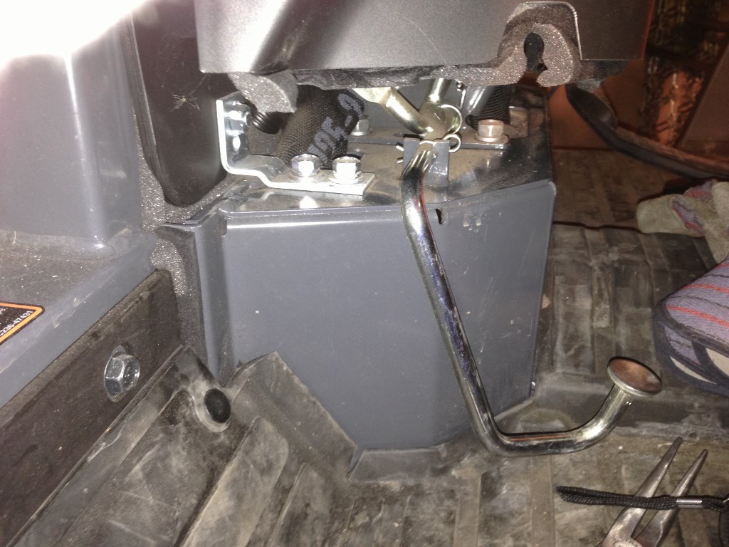

I added adhesive backed foam sound absorber to the plastic lever housings to either side of the seat, and put rubber edging material on the plastic housings where they sit on the fenders to cut down on the squeaking. I also added some foam padding up in the ceiling. I have also added additional foam padding behind the 2 pillar covers between the door & side window, but I may add either self adhesive foam sound deadener to them since they still are a bit tinny. Not sure I should add butyl mat to those because it could add too much weight for the plastic fasteners to hold. I also foam padded the small plastic wiper motor cover that sits above the dash panel.
I have a bunch of foam mats, etc. that I may use to stuff into some of the cracks & crevices, or just install self adhesive foam weatherstripping to deal with some of the gaps that are left. Trying to do it so things can be taken apart down the road for repairs.
I actually had a tough time getting the fenders & seat pan pieces all lined up to re-install them. Not sure why, as some holes lined up perfectly, then the next hole right in line was out of alignment. I assume it may have been that way from the start. I'll add some pics of what my project looked like.

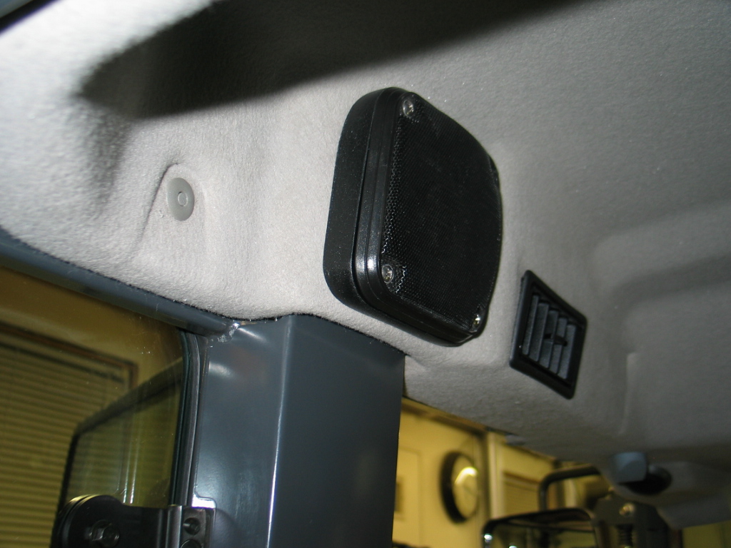

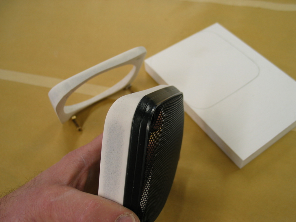

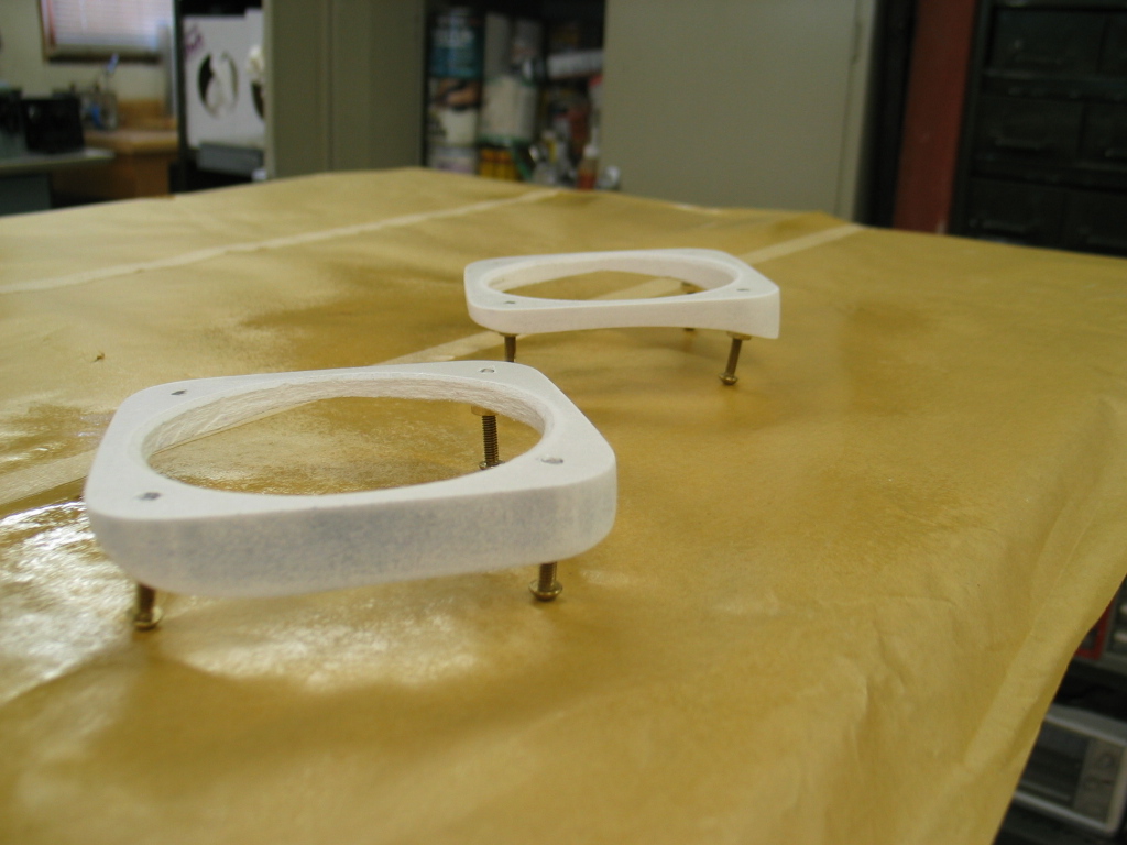

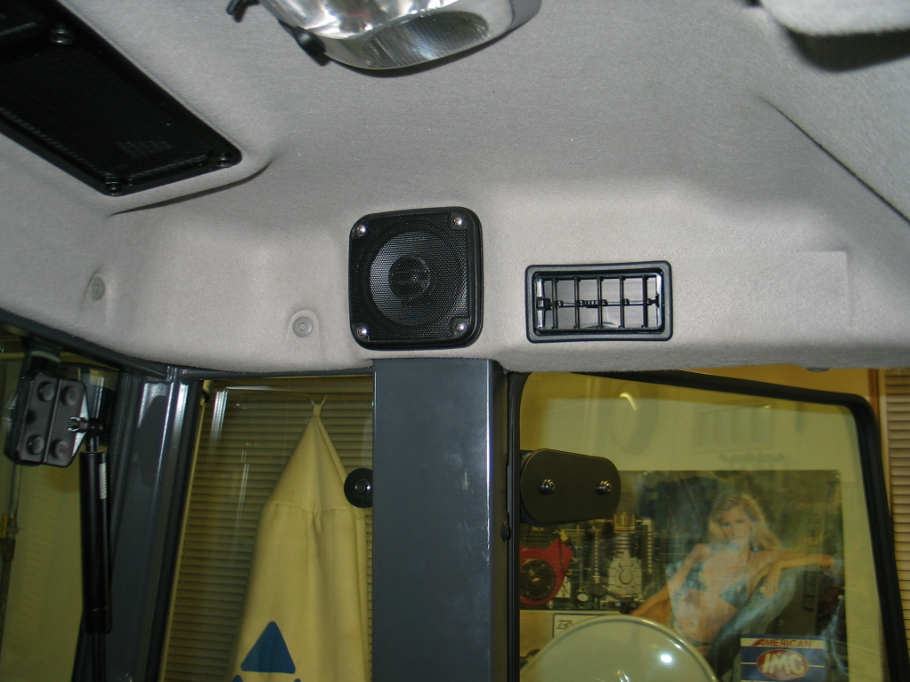

It makes it a lot easier to line up the holes if you put a round punch or a philips screwdriver in the hole your not putting the bolt in, and pry one way or another to line up the hole your putting the bolt in. The butyl mat does not have to cover the whole piece of metal your trying to sound proof. I found that just a couple of squares here and there are all thats needed. Like for those side panels.
The grills that I used are from the factory Kubota speakers, I made the spacers from 3/4 plastic board and shaped them to fit the curve of the headliner.

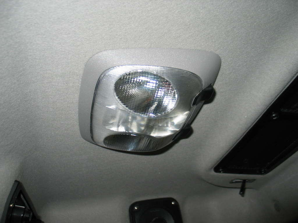

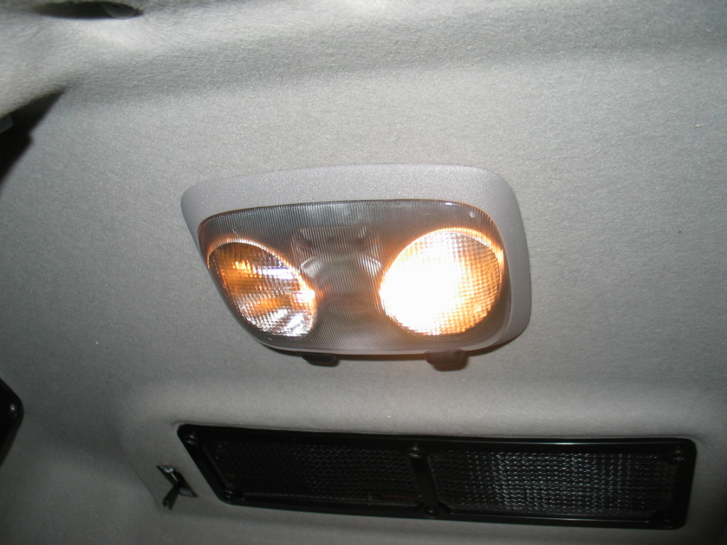

While the headline is down put in a dome light, I got this one out of a junk yard. I think from a Ford Excursion. The two side lights that are lit shine right outside the doors. The middle light not shown lit lights up the cab.

I have those pics of from back when you did yours. I don't think I have the patience to do the plastic spacers, so I have some 3/4", 2.2lb black foam that I'm going to try to use instead. I plan to put the speakers in the same spot you did. If the Kubota dealer is open, I'm going down tomorrow morning to pick up the 4" speaker grilles I ordered. At least I should be able to get it knocked out quickly, and if I don't like the way the foam spacers look, I can go back later and spend the time to make some nicer ones like you did.
I'd just like to get the stereo in and start the tractor to see how all the soundproofing work turned out. Then try my new Alpine Bluetooth iPhone compatible am/fm stereo. :D Be nice not to have to wear earphones any more. :thumbsup:
I like that dome light. Might have to do one of those.

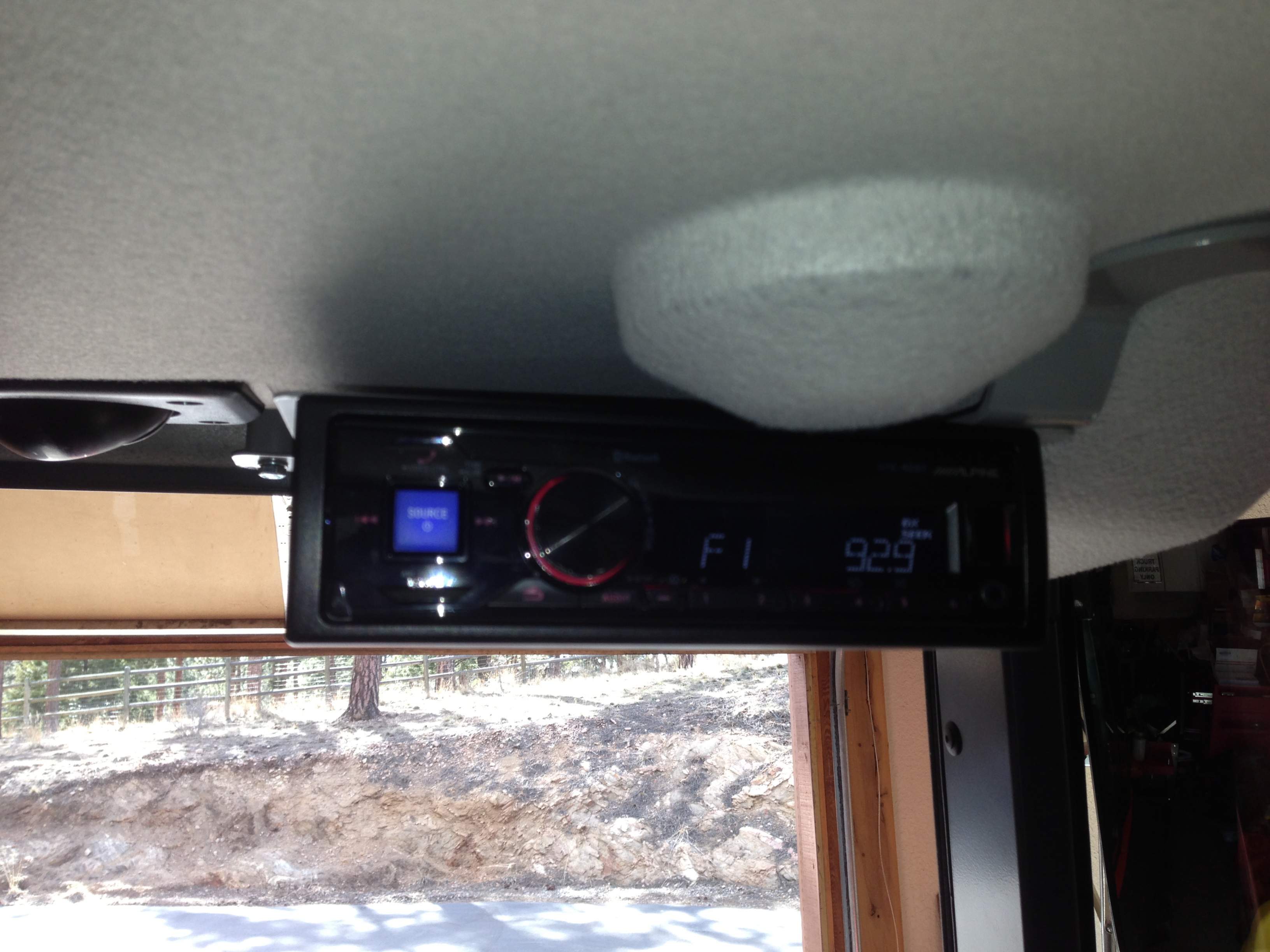

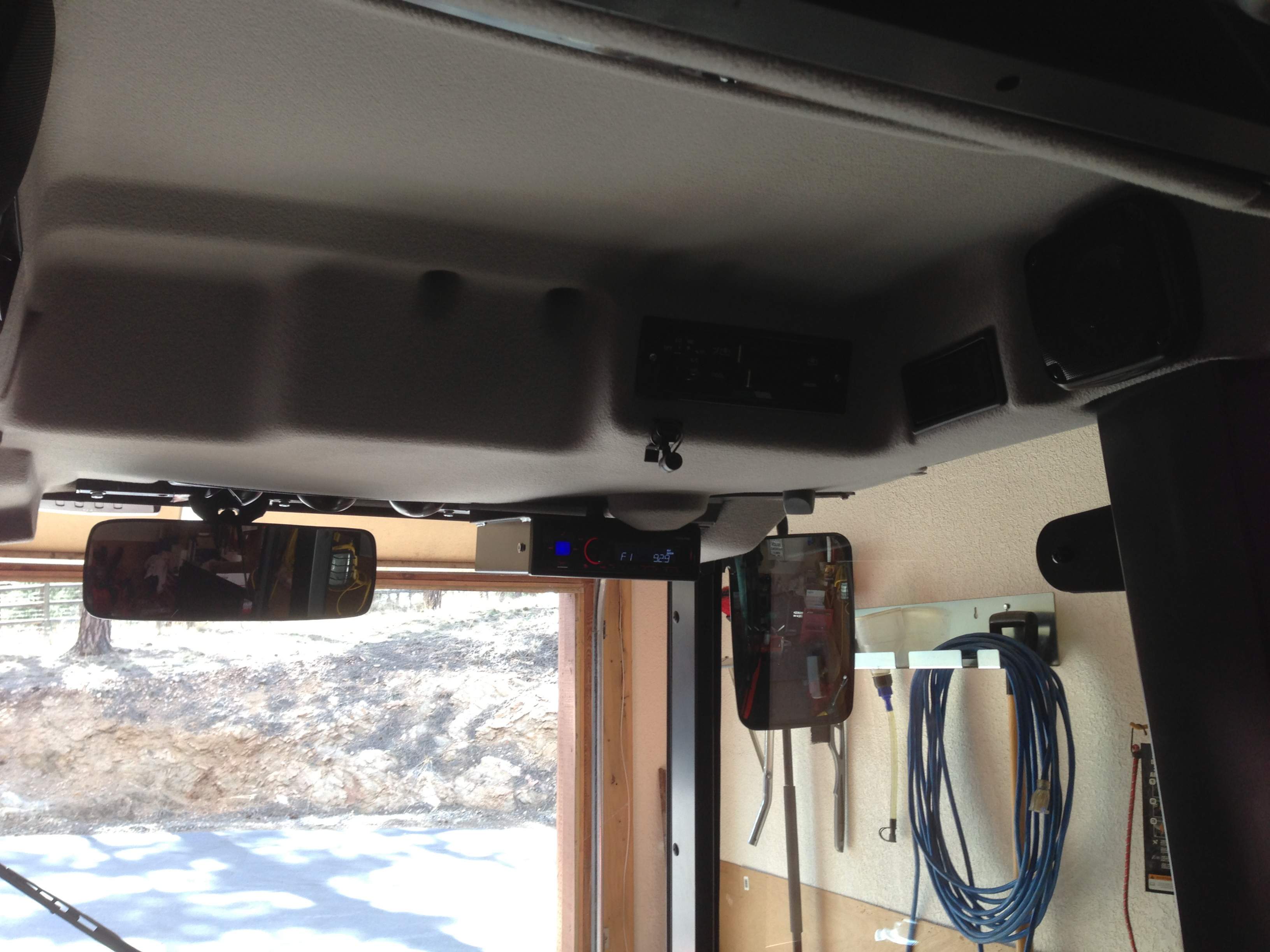

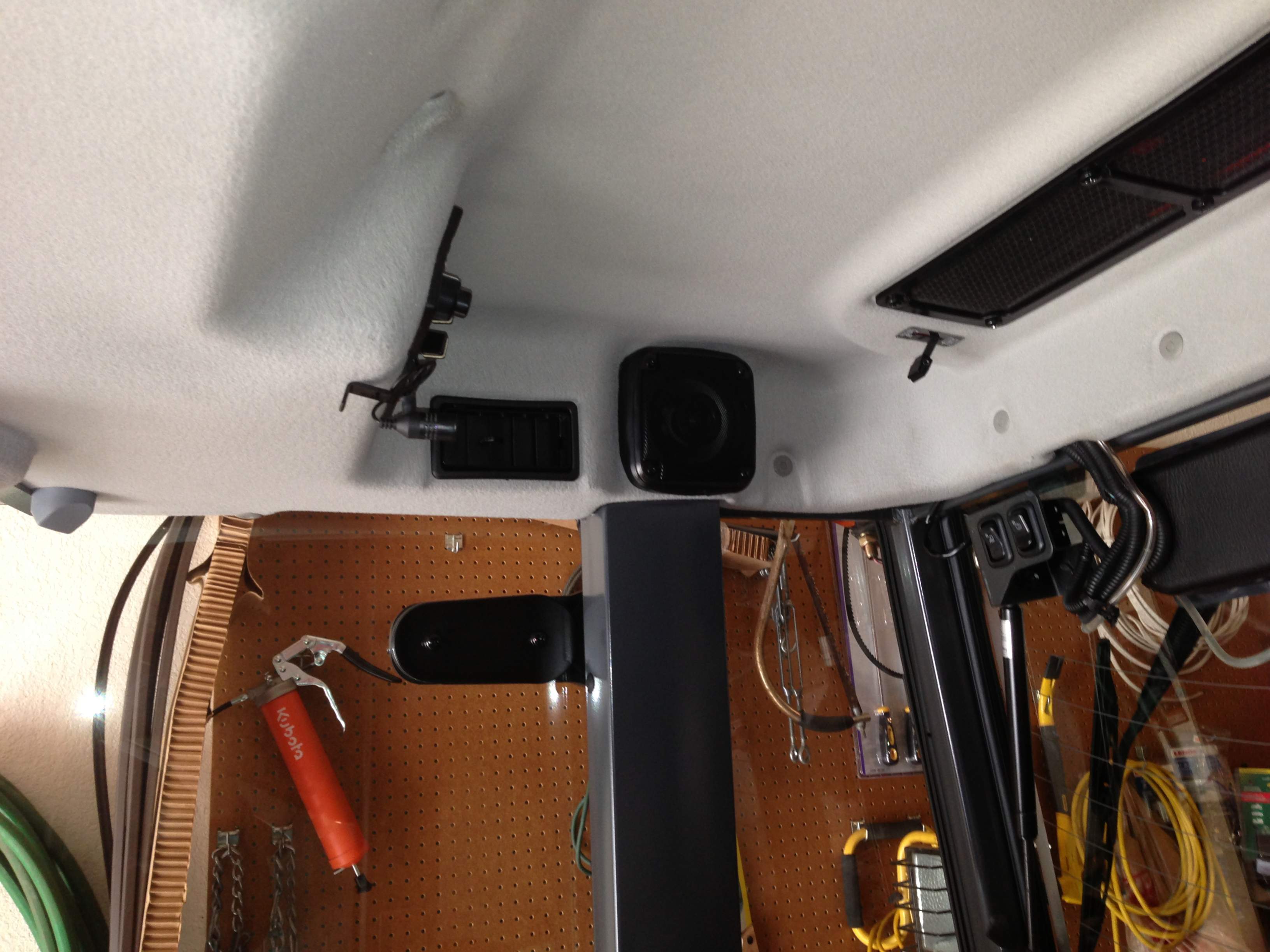

Also got the new stereo installed. I used foam spacers to mount the speakers since I could get those cut quickly. Doesn't look quite as good as Waxman's nice plastic spacers, but that's something I can do when I have more time. For now, the foam spacers are working nicely. The sound is impressive - much, much better than I was expecting, and apparently, these speakers need about 10 hours of play time to "break in".
I went with an Alpine mech-less AM/FM Bluetooth unit with sync that I can make/receive calls through the stereo (note the mic mounted on the headliner) and listen to music off my iPhone via bluetooth or USB cable. Pretty slick setup. I installed JL Audio Evolution C2-400x 4" coax speakers. I am very, very impressed with the stereo system, and am very glad I did this install, and think the soundproofing work helped quite a bit to create a decent listening experience. I spent quite a bit of time driving around at 2000 -2500 rpms to get a feel for how the stereo would sound with the engine running at working rpms and the hydro whine going up the hills, and can say that I am impressed. Glad to be rid of the earphones.
I also installed a ski boat rear view mirror because I didn't like the blind spot between the factory mirrors.

I think the rubber spacers for the speakers look good, good enough. The Bluetooth for the phone is a good idea, I have to get an adaptor for my Kenwood to do that.
I don't know how good the mike will work on the other end.
