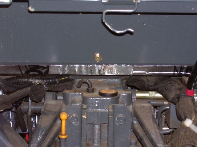

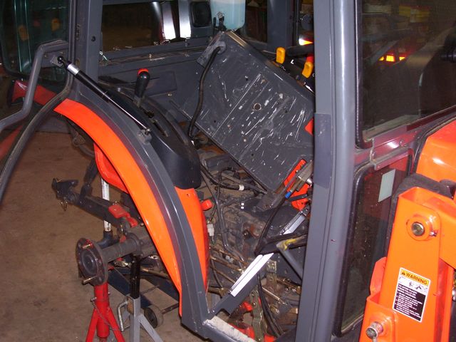

I hadn't planned on doing what WaxMan and Bandit did now but I was able to get some time to work on my B3030 HSDC. I just finished putting everything back together. I installed the Dynamat Xtreme under the seat panel, the "hump" panel, and both left and right floor panels. I also attached it directly to the transmission. I got the Xtreme through Amazon (free shipping) from a dealer Bandit recommended. I made patterns like WaxMan did but started off on the wrong foot as my first pattern was cut upside down. So I double checked everything before I cut things and the Xtreme went on relatively easy. I also had a heavy black rubber and foam pad (approximately 1/2" thick) that went on top of the panels and under the rubber Kubota mat. Putting the bolts back in got a little tough as some holes lined up while others didn't. That was a royal PITA! I also had to fight removing and reinstalling the rear turf tires as they are loaded and were a bear to manhandle by myself.
I made one mistake where I wrapped the Xtreme a little too high in the rear, see attached photo. I caulked every hole or gap that I found inside. I placed a floodlight on the floor facing up to see if any light would penetrate the cab. I found a 2" wide X 1/8" thick black foam tape at the Depot in the metal duct work section that I was able to seal up some areas from underneath. Really stuck good, not much for insulation but it will keep dirt out. Hard to really tell how much quieter it is but I'm sure it will help. Probably in the fall at the 300 hour mark I'll change over to SUDT2 to see if that helps, unless Bandit persuades me otherwise to go with 100% synthetic. Waiting on his results. Thanks to both of you, WaxMan and Bandit for all of your help and suggestions.
