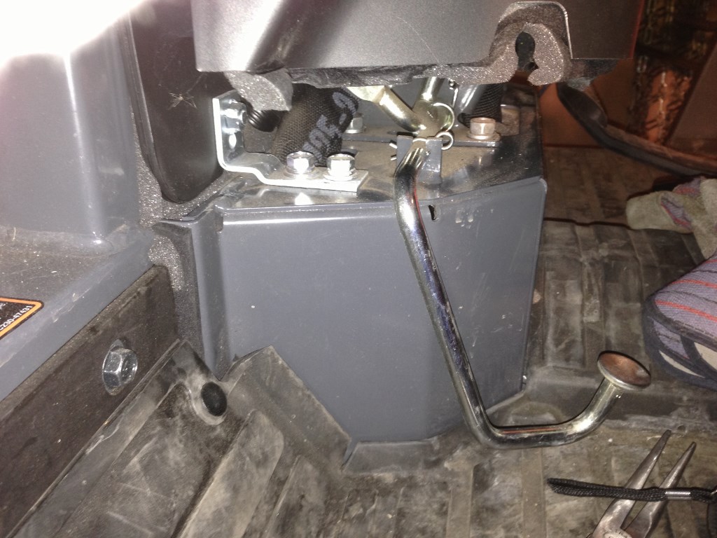

WaxMan,
I was digging around late this afternoon, and found an area that I think will be difficult to deal with, but am pretty sure needs more than the low density foam installed at the factory. I think it may be a big job to get to this section, as it appears to run both inside the cab and outside toward the engine compartment, but will have a better idea once I have things torn down. Have you thought about how to deal with this piece under the steering cover? It doesn't look like it'll be too easy to reach from underneath, and looks like it may not be able to be removed with the cab on the machine.

Bandit , did you put that foam in this picture at the cracks at the bottom? Near the floor mat?
If that is factory foam in those cracks then that is the reason my 2005 B3030 is full of dust and yours is not.
I have NO foam in these areas, just the formed piece of foam behind the plastic panel. From what I remember.
All of that is from the factory. I have not added anything yet, so yes, that is probably why I have much less dust than B3030 owners. Also, all of the levers, foot controls, etc. have either rubber or foam "gaskets" where they enter into the cab. However, I can still see bits of light making its way into the cab, so those areas will be addressed.
Let me know if that steel "toe plate" under your plastic panel has foam glued to the back side flat surfaces, as mine does. Either way, I can tell that foam is not dense enough to mute sound & vibrations, so more needs to be done with that.
