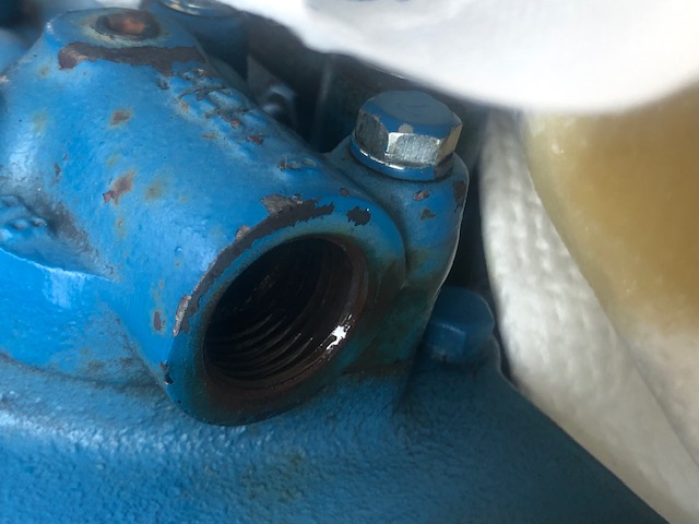

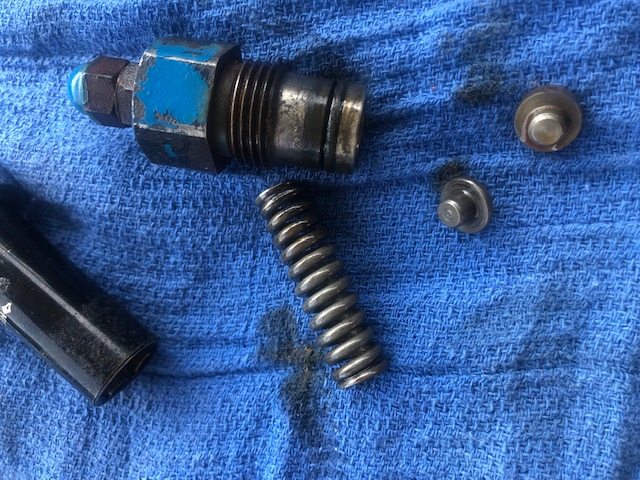

Here is the internals. Spring looks good and no dirt.
I have oil flow here.
Bone dry here.
Thanks!
Bone dry here.

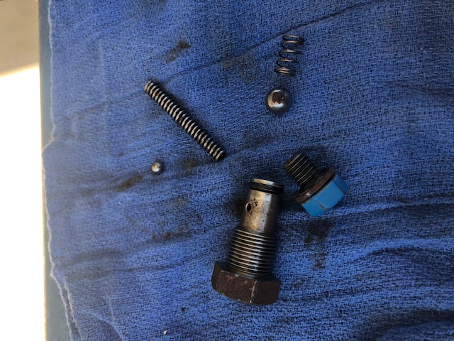

JC, No problems. I appreciate the help.
I pulled that valve apart. One of the ball bearings had a little rust but that was it.
I didn't have any oil coming from the hole.
   / SOS, I have my first tractor problem, Hydraulic lift issue
#44

We eliminated all the easy stuff that did not need a lot of intervention. We established oil coming out of relief device on post #41 with spring and poppet removed. I am not sure about quality of oil flow. What I mean is you have some flow but are you able to maintain any head pressure? It might be as the pump is pumping but it internally leaks and by passes the flow internally. The pump is a positive displacement gear pump but it does have an over pressure by pass so the pump would not self destruct. Although this is not sustainable as a lot of heat is generated. That is one possibility. The second is that the pressure relief is bypassing all the flow before it gets to the spool. The 3rd possibility is that spool vale is stuck at diverting all flow back to diffy. in your 3 point and another there is a feed back rod on the 3 point that bring spool to neutral position. when max height of arm is achieved then feed back move the spool in neutral position where In that fix all the flow is diverted to diffy and non goes to lift piston. Youu verified on post #43 there was no flow so either there was no flow to the spool or all of it got diverted. couple of questions here,
1-did you manipulate the lift arm handle as you were testing the flow?
2- briefly refresh series of event leading to this to see if there is any tell tale sign. How confident are you with the pump overhaul?
3- how confident are you with suction screen cleaning ?
I am sure you have an air compressor. On mine I have a discharge nozzle that is rubber tipped and is big enough. I would want to pressurize the open port on post #41. I might have to use a towel to keep it a bit tight, I would then check to see if I get any air pressure at the outlet on post #43.
Messing with the spool should be the absolute last resort. The thing is with a lack of quality flow good or bad spool would do pretty much the same. I wished I asked you to keep proper eye protection and rubber glove or somehow block the opening on the relief device by some rubber plug and test the flow and see what kind of pressure it develops.I wondered if you can make any pressure at all. Flow is not sign of pressure. Flow against the spring causes pressure. Let me know.

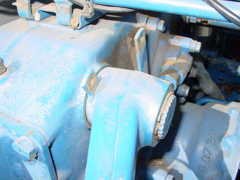

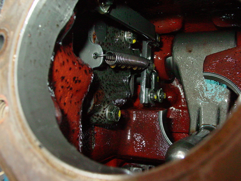

Just add a few pics of feed back arm to bring the Spool to Neutral position.
1st picture is the spool valve inside of diffy cover. I neutral position all the oil will be splashed back into diffy.
2nd pic is the cylinder head. notice 3 holes there, the middle is rate of return adjustment on 3 point. the one to the left of it where the piston get it's oil to move the piston .
3rd is the shock relief I was talking about. that is out side of the cylinder and it squirts some oil in to diffy to avoid shock loading when you carry something heavy on a bumpy terrain.

Hey Scott,
I started it up and the 3 point has no resistance when I lift it up and down. I also messed with the lift lever, no change.
The pump felt tight after reassembly.
I address this below.
I did have air coming out of port 43.
JC,
ps. another crazy idea, if you remove the lift cylinder, piston and lift cylinder head and start your tractor you should see oil gushing internally from the spool in the diffy or outlet port of that connect to the cylinder head. if no flow, them pump is very weak.
I'll try this next and get back with you. This should let me know somewhat if the pump/screen are an issue.
View attachment 620512View attachment 620511View attachment 620514View attachment 620513
If you have any other ideas based on above, let me know and I'll try that as well. Thanks for the help!

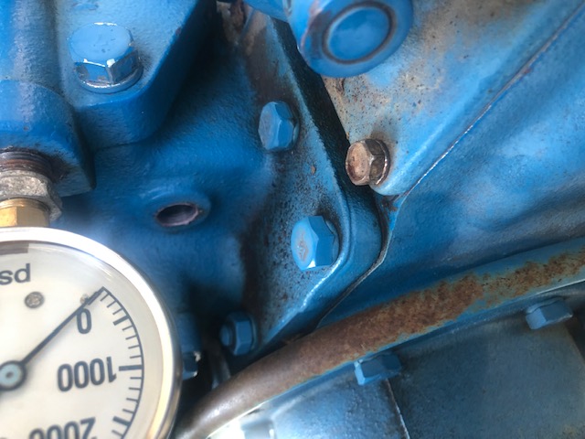

I am about plumb out of ideas, but couple of more things to do.
1- Look at the pics where I put a 3000 psi oil filled pressure gauge and run the tractor , raise and lower the lift arm handle and see what you read there and report. I bought mine from Northen Tools for under $15 ten years ago.
2- look at the pics that show lift arm on the right side of the tractor. There is a feedback arm that brings the the 3point spool to the neutral position and any given height of the 3 point. Take the cutter pin our and remove the pin. Be extremely careful not to get your fingers jammed as it will be very dangerous. Grab the end of the rod with a vice-grip. Have some one else start the tractor and manipulate the lift arm. See if arms lift, then rotate the rod left and right and manipulate to see if there is any change and report back.
If you have pressure reading and cannot raise the arm then there is good chance that your lift spool valve is bad and that is not a good thing, or cheap to fix.

I have the gauge. I have zero pressure when lifting the arm handle.
I removed the pin. It moves back and forth with ease, even with the tractor running. Not sure if that means anything. Nothing moved when I manipulated it.

I have zero reading on the gauge. The needle never moves.

Position control lever is the lever you use to raise and lower the 3 point lift arm. What I meant was to raise and lower the lever and observe the pressure in the gauge to see if it changes.
When the oil comes out of the spool valve does it appear to have a lot of pressure. Having oil coming out of spool and not registering any pressure means all of the oil is diverted to diffy and points at some defective element within your spool. i never took my spool valve apart to give you guidance there.

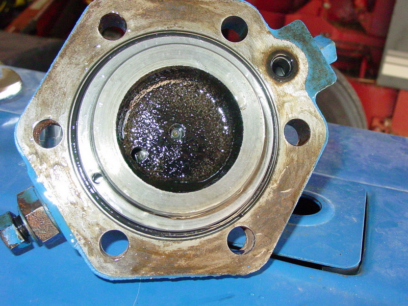

I have another crazy idea, on your second picture the hole on the lift cover with the o-ring is pressure port or oil port going to 3 point lift cylinder head. why don't you get an rubber tipped air nozzle to see if you can push any air in to the oil passage way. while you are doing that have someone raise and lower the position control lever. I am hoping something is stuck there and yo might be able to push it out.
Pressure is made when oil flow from the pump hit the pressure regulator spring against the poppet valve. so if the spring pressure is not enough or adjusted in enough that may not allow a lot of pressure made. Turning the screw on the outside of the relief device increase the spring tension hence more pressure. Might want to turn the adjustment screw clockwise a turn and two and see if you can read any pressure at the gauge.
I wish there was easy way to put a pressure gauge between the pump and the relief device to see if your pump is actually making any pressure.
let me know, we should solve this problem one way or another, it is getting ridiculous
PS. Pt your rubber tipped air nozzle in the hole and put air in and the manipulate the lift arm.
You can also take off the pressure regulator cover off and see if yiu can get some air coming out of that fitting. I am trying to establish if the oil path is open. Second picture on post #41. see if any air comes out of the fitting.
