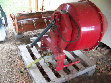

100_3793.JPGHmmmmmmmmmmmmmmmmmmm! Just yesterday I had my 3 point concrete mixer on. It is somewhat modified to make it work on my ym2002d. When I operate it I close the stop valve to lock the lift in the top position. I have an auxiliary outlet that I then operate with the 3 point control. Because of a balance situation the lower lift arms will actually kick up when I start the dump procedure. I chain it to the hitch to prevent it from doing that. Said all that to say my lift arms can be raised by hand even though the lift is locked out. I have never heard of a 3 point lift locking from going up, only down.
I like the scaffold idea. Only problem I don't have a roll bar. I do have a home made brush piler that goes on my loader and I attach a platform to that to use as a work scaffold.

View attachment 290964Hmmmmmmmmmmmmmmmmmmm Said all that to say my lift arms can be raised by hand even though the lift is locked out. I have never heard of a 3 point lift locking from going up, only down.
Winston, i know u know why the arms can be lifted up when there locked, i figured id sasy this for those who dont. its because the shaft that drives the 3pt arms is not connected to the cylinder that lifts them, allowing it to be pulled free but not pushed down against the fluid, holding the pressure. i think its more that the arms are locked, which i think is irrelevant here but because he is lifting the front and the rear is anchored to ground by BB that instead of rotating on rear axle or roling rear a bit i think it just lifts the whole tractor as the curl pushes tractor backwards?
