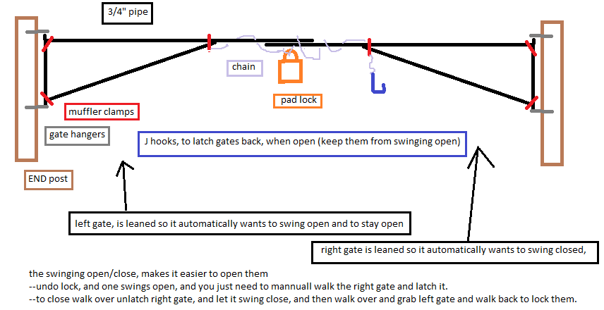

one the gates here on the property....
no live stock to deal with. so there is no need to keep a gate that is right against the ground. hence the A frame style pipe gate. it keeps atvs/utvs/cars/trucks from going through.
i did try a "chain" or metal cable style gate. but the stupid chain and/or cable would get tangled up. and i nearly ran through it myself a couple times. (very hard to see), why i don't mind idea of getting vengeance idea, i did not like the idea of it back firing and taking out one of my own vehicles or tractors (1st time ok, getting use to it, 2nd time it was wrapped across front grill of the blazer (it went bye bye)). so chain and cable idea didn't last very long. also wind would whip any "no trespassing signs" off the chain / cable in even light wind, so was useless.
end result gate is more of a deterrent, that still makes it easy to use. and i was not purposely leaving a driveway open, so i was not having to battle trying to catch folks and report them. they were just blocked by gate, and that was the end of it. the fields here get cash cropped out, so the one farm gets a key to pad lock, and immediate family gets a key, no friends, teenagers, etc.. get a key. if they want to do something they ask. like it should be.

I like the tilting idea to make opening/closing less of a chore! :thumbsup:

Good simple gates there Boggen. My piece of fencing wire is still effective, although there is no way to get off the road between the highway and the farm yard, so a lock is not really necessary in my situation. I just tie wire two 6" sections of bright yellow irrigation pipe on it, and nobody can miss it - even me. The pipe needs replaced about every two to three years.
