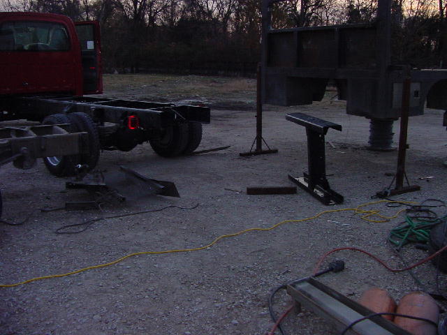

<font color=blue>The pictures aren't the best. Heck, I make things, just don't take good pictures or do well at describing....... </font color=blue>
The picture just needed a little lightening {see attached} and I think you describe them just fine.
Didn't you get just a little nervous, even though you measured 3 times, as you began to cut the frame of that new truck?

<font color=blue>You take like cutting that plate at an angle so when the bed is lifted the chances of a hangup are minimized.</font color=blue>
w-h, do you have a picture of this? I'm having trouble visualizing this.
w-h, do you have a picture of this? I'm having trouble visualizing this.</font color=blue>
Think of it like how paper cups nestle nicely inside one & other. as soon as you pull the top one up, there is space everywhere between it and the cup below. Contrast this with two pipes that fit perfectly inside each other. As you move one relative to the other, it is always in contact.
