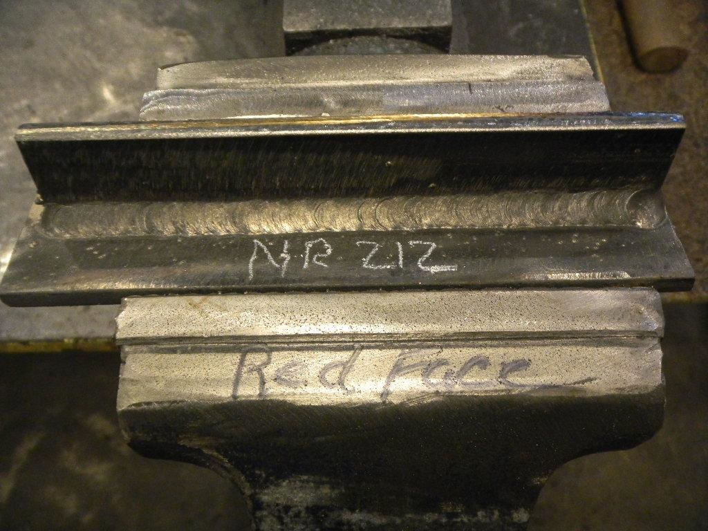

frugalangler if you haven't pick out a self shielded wire yet. This is .045" Lincoln NR-212. Run with a 1966 CC only engine drive welder.
yea, sweet, not bad for a beginner - oh, yea, you been welding for a couple weeks now!! you are my idol LOL but I'll likely never lay a bead that sweet cause I drank way way too much coffee and coca-cola - I can't even carry a cup of coffee now without spritzing the floor a little - and to think I'm gonna give tig a shot??

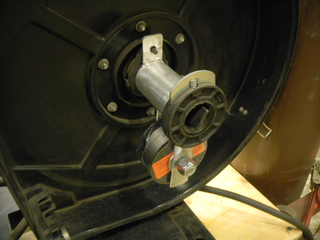

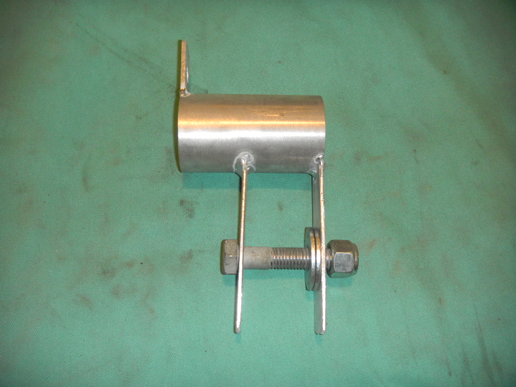

Here are a couple pictures of an adapter I made to run 1-pound spools on one of my wire feeders. Might give you some ideas, how to build one.
Awesome! Thanks, I'd not thought of something that simple, duh! Again, TBN rocks thru, thanks SA
