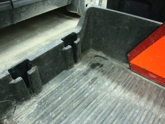

Had a chance to do something new today. I pitched a large log into the back of the Gator CX when it was below O and cracked the plastic bed. So I went into town to the body shop and asked what kind of glue they use on car bumper covers because this plastic looks to be the same or very close.. The guy said we don't we solder them up. Solder them up I asked??? He said sure. He said if it is black plastic it is easy, if it is yellow plastic your out of luck. So I asked him how he does it. He said just get a old solder iron with the big blade and heat it up and melt it into the crack and weld a bead of extra plastic in as you go along. I said sounds good I have one of those solder irons, do they sell the plastic filler because I don稚 have any extra plastic to fill it with. He said hold on and he went and got a old broken inner plastic fender well and said just cut some strips out of this and give it a try. It works great and I learned something new today. :thumbsup:

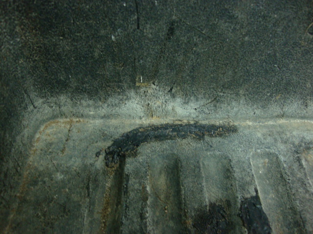

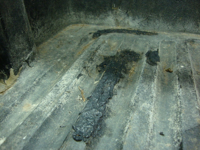

Not much to show but I took some shots for you. I just wanted to fix the crack so I did not grind it smooth or anything but he told me you can work it out if need be like they do on bumper covers. I pushed hard on it and it seems to be as strong as new. Far as I can tell. This old Gator CX is over ten years old and has more than 1,800 hard hours on her so I just wanted to seal up the cracks.

I try not to be a hack, that said, yeah, we all do. I did do the other area in the bed that had cracked 6 to 8 years ago. That fix was a hack. I had to remove what I had used but the way he said to do it was melt all the way through adding the plastic as you penetrate the thickness of the plastic and it will be good. MY second repair is much better with the iron hotter and the filling process better. I may get this yet. As for now I think my bed is fixed. :thumbsup:
