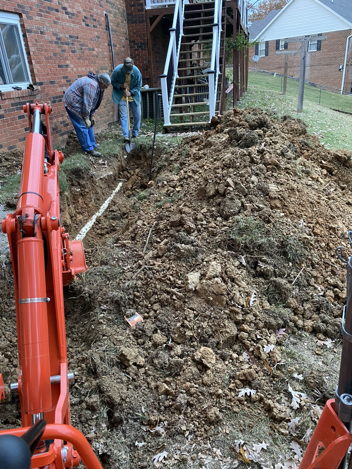

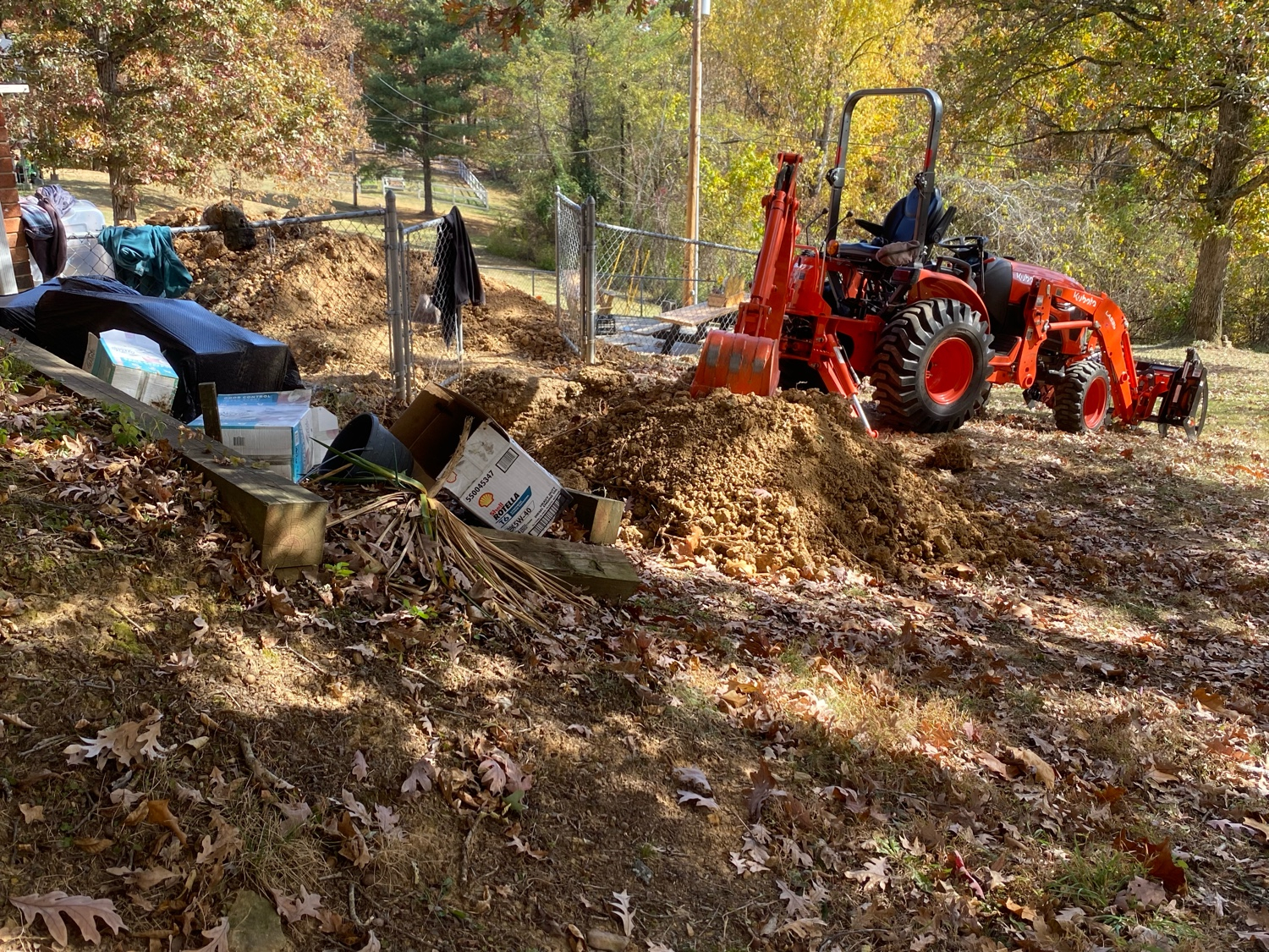

I like the 16” bucket.
You can move much more dirt with the 16” vs 12”.
Also, the 16” doesn’t pack with clay as quick as the 12”. The two photos above, the spoils are 90% clay, and damp.
There is a big difference in power between the BH77 and BX backhoe.
