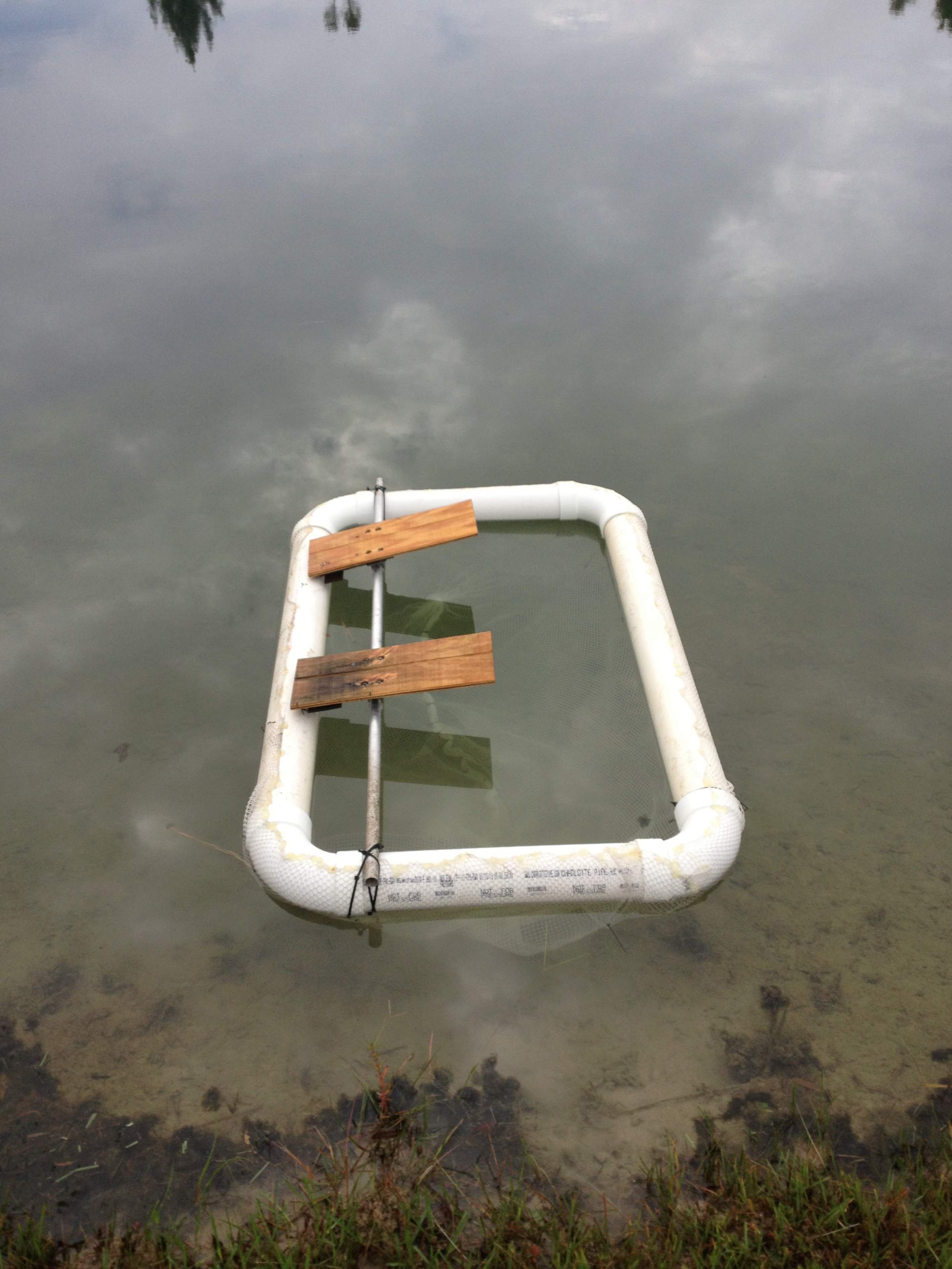

My Dad and I recently built a turtle trap for my pond and the thing works pretty well.
I got the idea from the internet and the rough dimensions. It is made from 4 inch pvc (schedule 40)
(I would try to get a lighter grade PVC if I had to do it again - this thing is a Heavy)
It is about 36 inches by 43 inches with a net that is about 2 feet deep. I really have to give all the credit to my Dad ( who just turned 89) he designed the flipper boards and balanced them out perfect, they work great.
When the turtle walks out, the board flips down putting them in the trap and then resets.

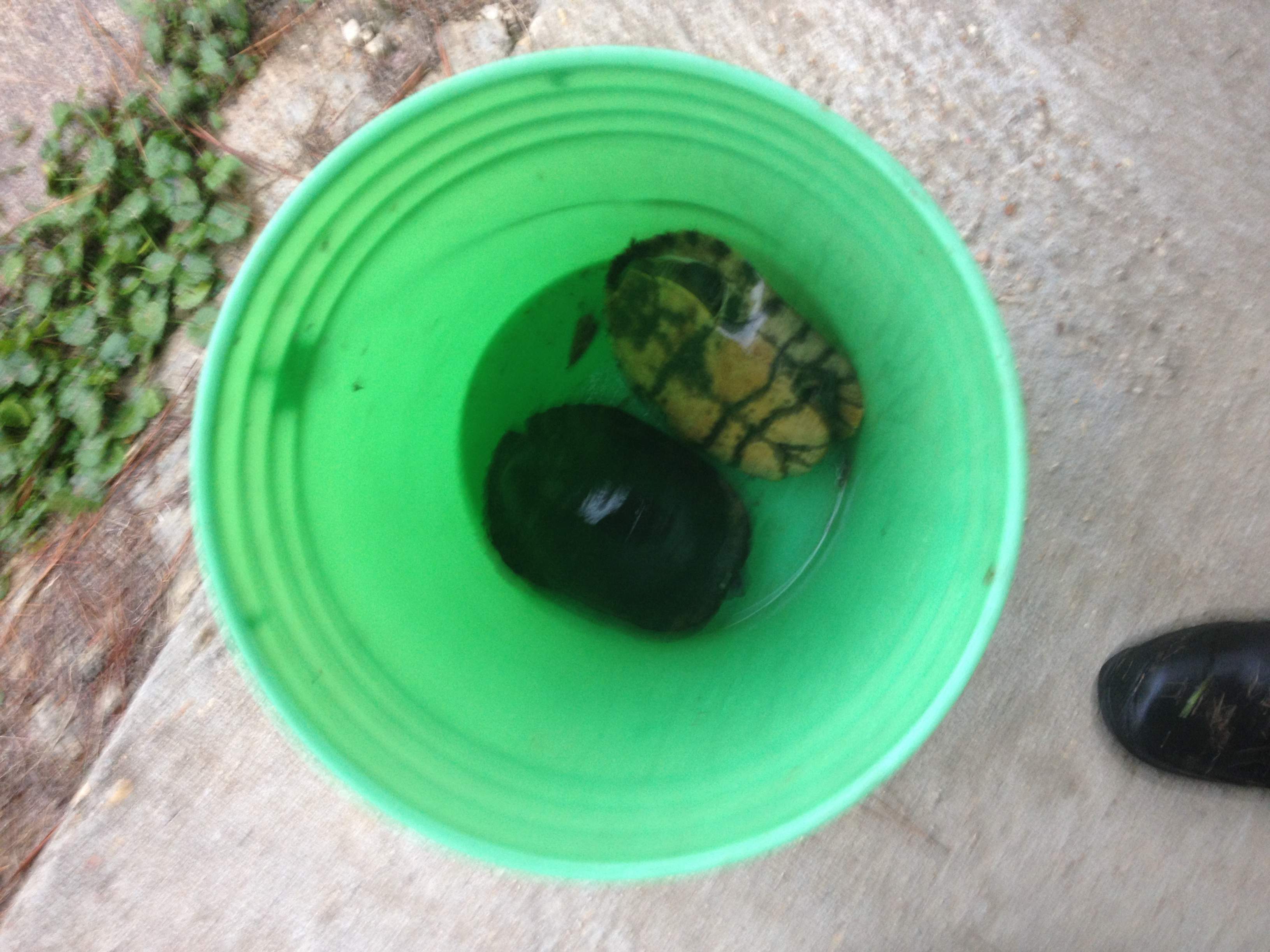

The only close up picture I have of the trap is when I did the test float. (We really weren't sure it would float ! but it does fine) . I do not have a close up picture of the attachment boards that actually float in the water so they can swim up on to the board. The attachment board that goes in the water is the key, it must extend enough into the water so that they can easily swim onto the board and climb up. I scoop the turtles out and relocate them to a nearby river.
