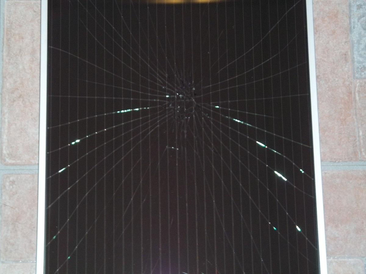

I'm using a HF 12v 45W Solar System to keep my Tractor battery full. Well, last night it was Windy and 2 of the Panels fell and cracked :mad::(, pix below. I tested the darn thing and it's still working, just the Top Glass is bad.
I'm wondering if any of you had this happened to and found a way to fix them? Or any suggestions would be really helpful!
Should I just get a Glass cut to fit and Silicon on Top or it?

45 watts is a bit much to keep your battery topped off. I use the 5 watt panels and they work great. But answer your question I think the glass is fused to the panel. If that's the case a thin bead of silicon along the cracks should work.
Good luck.
/ Solar Charging Help! #3
you need a piece of glass. If you silcone it there will shade on lots of the cells with cracks like that and then not just that cell but a whole row of cells will probably shut down. It varies with different manufactured panels.
/ Solar Charging Help! #4
I would place a complete glass over it to prevent any dirt/humidity to get to the panel. Place a long silicon bead around the frame and then drop the glass on top of it.
Try to secure the panels better. I bought the same system but was not satisfied with the frame that came with it. I build my own frame from angle iron. Details here, second article from the top:
Link
P.S. 45W is overkill as stated above. I have attached a small $20 5W panel to my container and trickle charge my tractor battery.

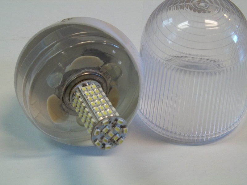

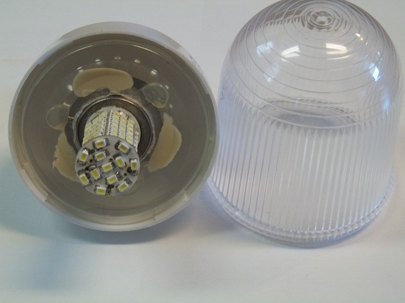

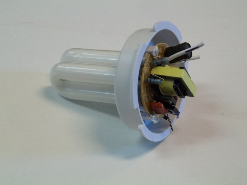

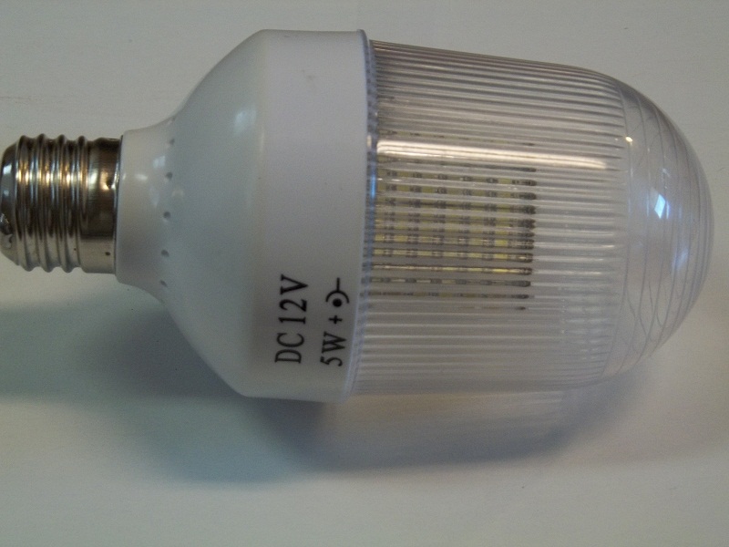

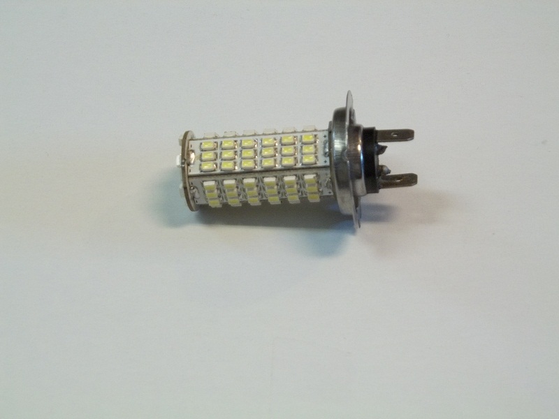

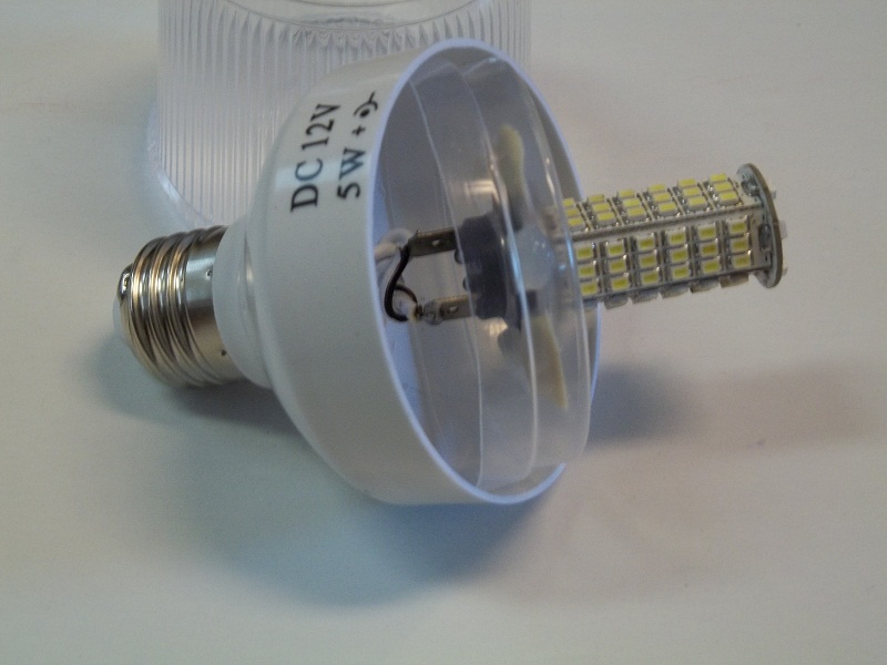

:thumbsup: I am able to help you with something else because it helped me alot. You know the 2 Lights that came with the Kit. Once the Bulb is burnt or Bad, don't throw it out the Housing. You can use the Housing and put in a T7 102 LED 3020SMD Bulb. I use the bottom of Large Dunkin Donut Cups and cut & drill a hole in there and then use Liquid Nails to attached the Bulb, solder the +/- then spin the wire tight intil it fit perfectly (See Pix).
Actually, I didn't like the Brightness and the Battery Drainaged by the CFL. So I found the LED Bulbs on Ebay, 2 for $6.89 Ebay Item: 360418648196 http://www.ebay.com/itm/2X-H7-12V-1...Parts_Accessories&vxp=mtr&hash=item53eaa02084. I took out the CFL inside and convert it to the LED ( See Pix Below). It's much Brighter and the Amps usage is only 0.17 per bulb. The CFL is like 1.6 Amp :( per bulb.
So if you are trying to save some Powers or Reserve them, this is the Best LED I found for that purpose. You can have 4 of these running and it's the same Amps usage as the 2 CFL's and with 4 you get ultra brightness. :D Rated at 400LM but I would say 350LM. Also it can run at 9v too :)
I also order the 120SMD 3528 LED, that really suck alot of Power and the Brightness is worst, strange... Anyway, if you have questions, just ask!
