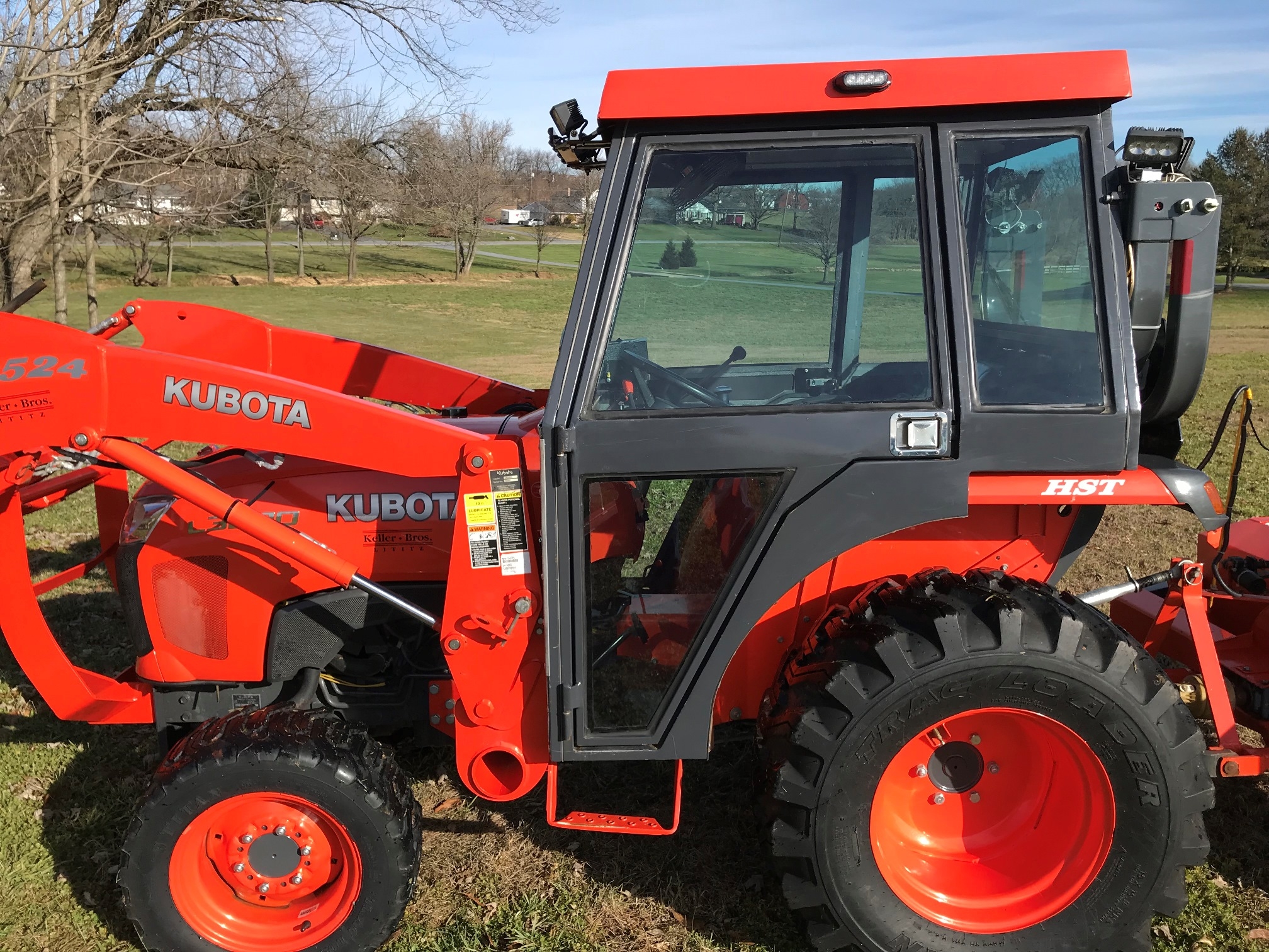

After seeing the shortcomings of soft cabs, I built a cab from steel and glass for the last Kubota. It cost me around $1200 and lots of hours.

/ Soft cab enclosure for winter. #7
Very nice cab. Did you post a thread here on your build?

/ Soft cab enclosure for winter. #9
Thank you, and yes there's a very long (some would say boring) thread covering it from start to finish. We bought the L3200 in early 2012 and started the cab about 6 months later. The cab was nice, and with the doors off it was better than an open station in the Summer heat. However, when Wifey's brother suggested I'd live longer if I had a climate-controlled cab not having to breathe the dust and pollen. Late in 2018 we bought the L4240.
/ Soft cab enclosure for winter. #10
thanks very much. I'm going to read over it. Really nice looking cab that you built.
/ Soft cab enclosure for winter. #11
Key quote from your thread build:
"Not much of anything on it is anywhere near close to square, level, round or plumb. Like most tractors, the Kubota is a combination of different angled parts joined with French curves."
Now that you have a factory cab with AC, what is your opinion on doing a DIY cab versus the factory cab?

/ Soft cab enclosure for winter. #13
I wouldn't hesitate to build a cab if A/C wasn't desired. I did some checking on adding A/C to the DIY cab. It wouldn't have been impossible - but darn near. Plus, I wanted to mow more than 6' wide and the L3200 didn't have the spare horses for a larger deck and A/C. My rough guess was +5HP for the A/C and +5HP for a wider RFM above the 32HP the L3200 had = 42HP. The L4240 fit that requirement.
There's no substitute for A/C for me, and the factory cab is way quieter. Obviously it is more comfortable with being able to pick the temperature inside the cab in any weather. It also eliminates coughing up "lung fung" the morning after stirring up dust and pollen. Depending upon the weather, there are often various bugs that seem to like heading for ears and eyes - particularly at night. For a few weeks each year there are deer flies that are a real nuisance.
The DIY cab's main purpose was to keep me warm and dry in the Winter. It did that very well. It was also a little more comfortable than open station tractors I've had (that didn't have canopies). Had 3 of them before the L3200 used in the project. With the doors removed and a small "bus driver" fan it was livable in the heat. Exposure to pollen and dust wasn't different from being on an open station.
Given a choice, I'd get a factory cab. Building the cab was a fun and sometimes challenging project. It was a lot of work compared with most of what I do. I love tinkering and making stuff.

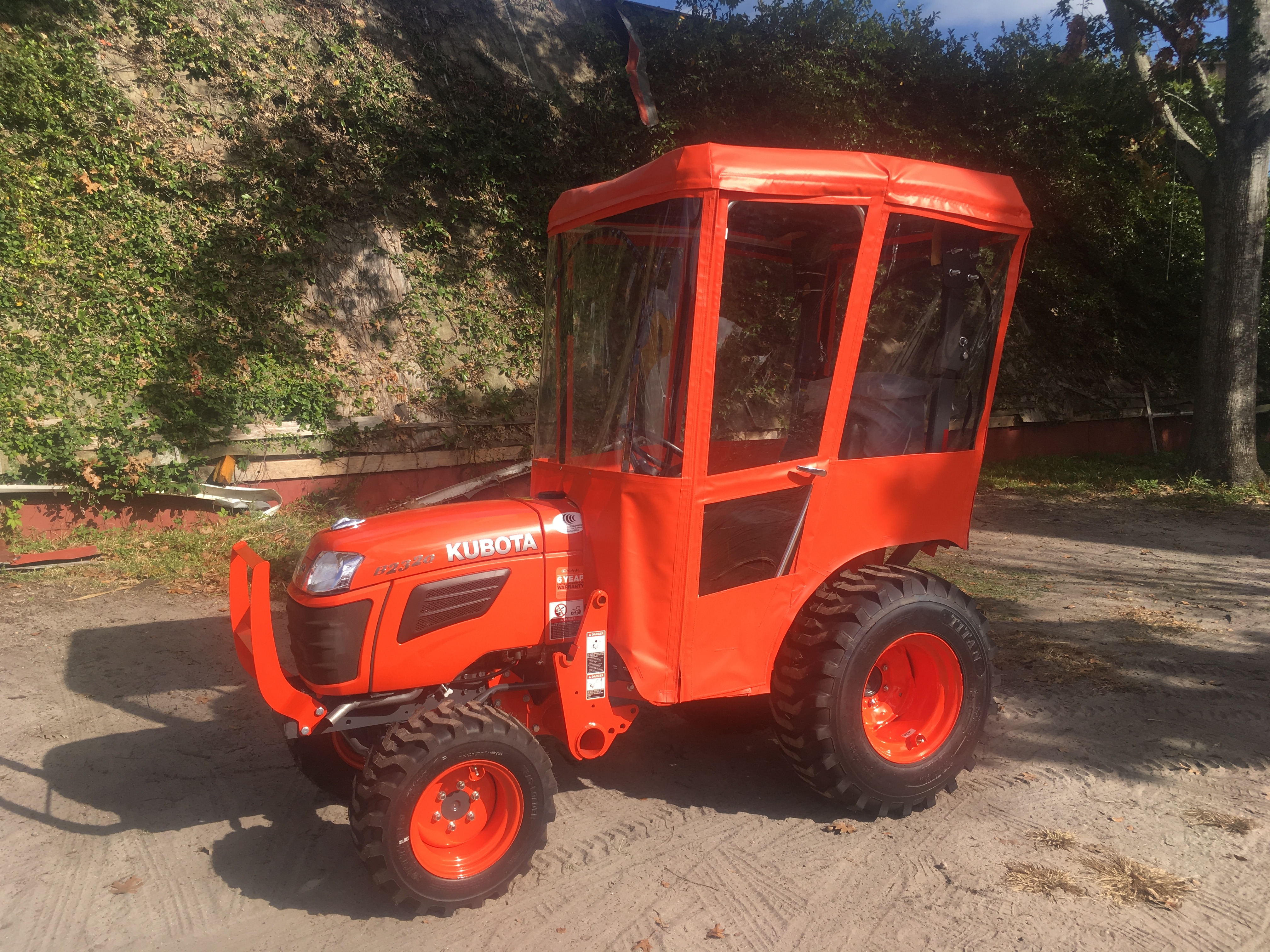

/ Soft cab enclosure for winter. #16
covermytractor.com seems to have quite a few soft cabs for different makes and models. They also have storage covers if you aren't going to be using them.
