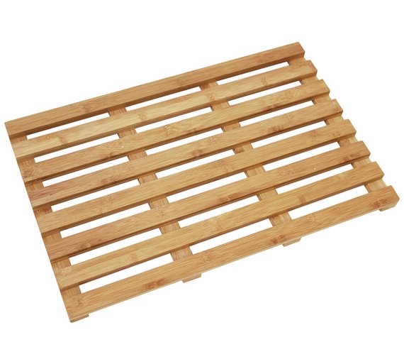

What is duckboard?
I'm planning to add a layer of gravel then more concrete over the old concrete, just haven't got around to it yet. Stall mats are a good idea.

Almost looks like pallets. Way too many places for me to loose stuff, found out years ago I can make a socket disappear in a empty 5 gal bucket. I'll probably stick with concrete, sometimes have to use a sump pump for water, concrete is easier to clean.

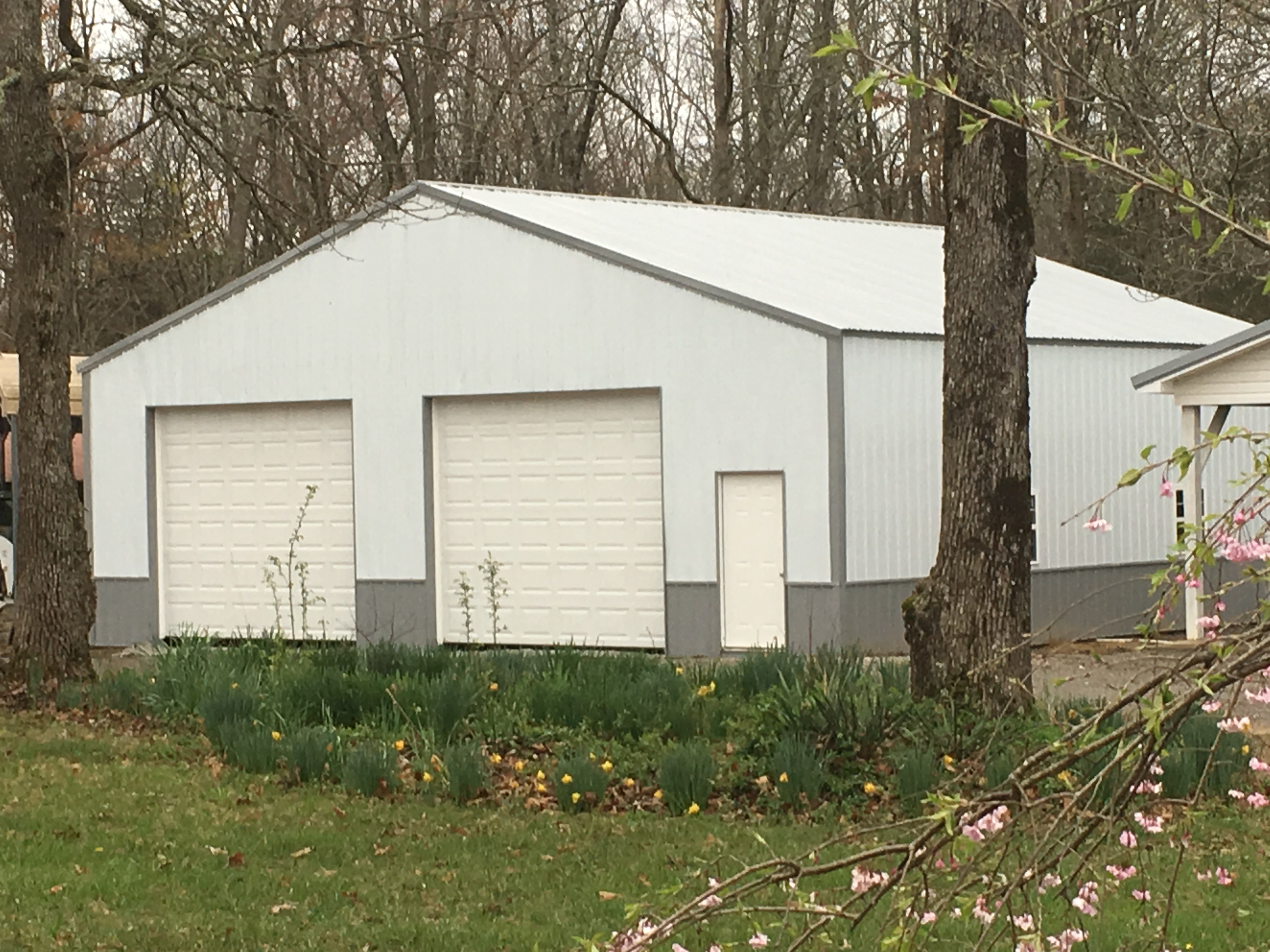

Here is one for you, make sure you place your garage door 6 feet from the edge of the building. Why? Cause you will more than likely put shelving or storage equipment along the walls, and if you pull a car in to work on it you will reduce your working space along the side of the car. I have two bay door with 12 feet between them, it was the note from my neighbor.
