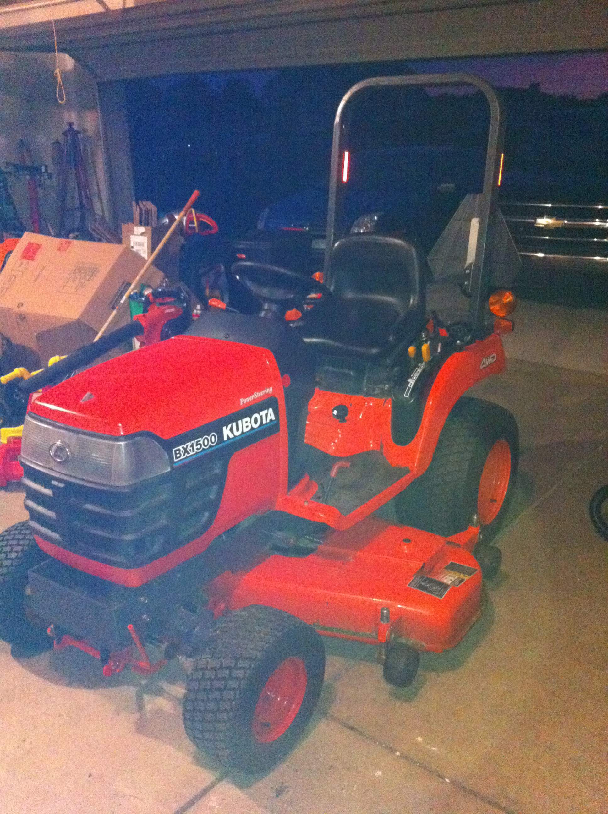

Just figuring out how to post pics
/ So I goofed #9
<img src="http://www.tractorbynet.com/forums/attachment.php?attachmentid=321201"/>
LOL! Cars outside, tractor inside just as it should be!

/ So I goofed
Well, considering I paid more for the Kubota than the Tahoe.....:laughing:
