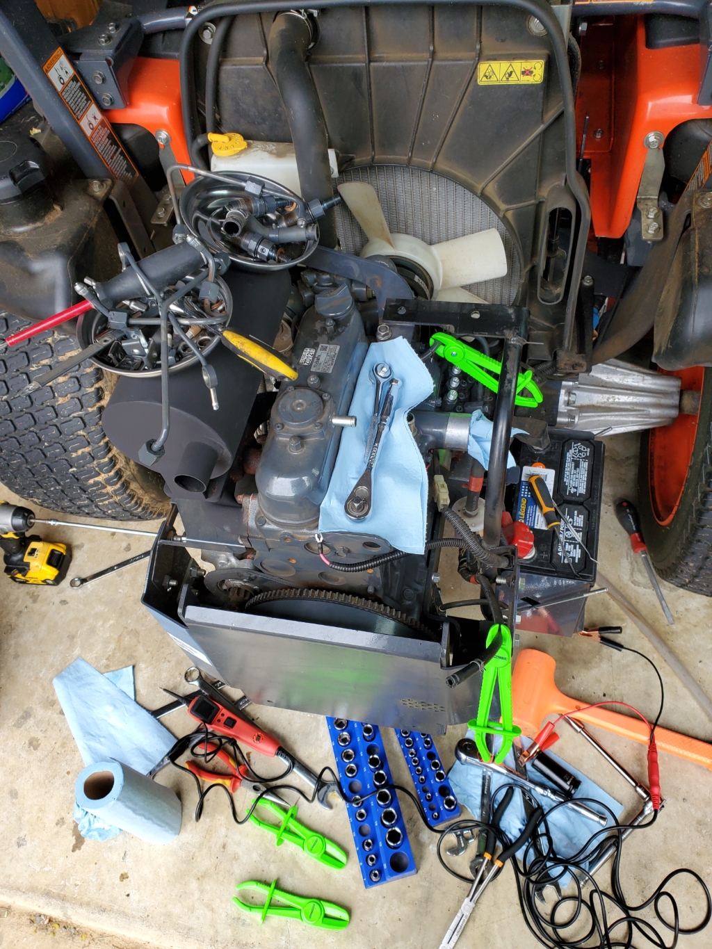

Thanks of the comments. I thought I'd share a picture for those who might be curious. I've covered the injector and glow plug holes with a paper towel to keep them protected.
I suppose the logical step is to start from the top, so I plan to remove the valve cover first. Then, I'll see what's inside before considering whether to proceed to the cylinder head. Surprisingly, the motor turns smoothly, albeit only for a quarter of a turn. It has always been meticulously serviced before each season. This mower is for my personal use and I'm particular about maintenance.
The mower functioned perfectly last season and was fine when I parked it. Although I'd prefer not to dig into an almost new engine (I estimate it has less than 400 hours of use, but I'll need to confirm), it seems I might not have much choice. Given that it's spring, my local Kubota dealer is likely overwhelmed, based on previously experience. I've purchased a lot from them, and they know me on a first-name basis, but I suspect any service would take months.

I think I may have identified the problem.
Next, I need to determine if there was any damage. Given that seeds can compress somewhat, I'm hopeful for a positive outcome. My plan is to use a depth micrometer to measure the clearance between the pistons and the cylinder head deck. If the measurements are consistent across all pistons, I can reasonably assume that the connecting rods are undamaged. That's my rationale anyway.
I haven't removed the cylinder head yet. Due to the weather conditions, I've decided to postpone this task until Monday.
I checked and the varmint did not come in through the air cleaner. It's amazing the thing could get into the muffler and crawl all the way through the nastiness.

When I began working on the engine this morning, I removed the paper towel shown in the previous picture and shone a light down the hole where the fuel injector goes, to see if I could catch a reflection of coolant. At this point, I could see what looked like seeds in one of the injector holes. I didn't recall noticing this yesterday and was a bit puzzled as to how anything could have gotten in there. I proceeded to remove the header and a bunch of seed spilled out.
