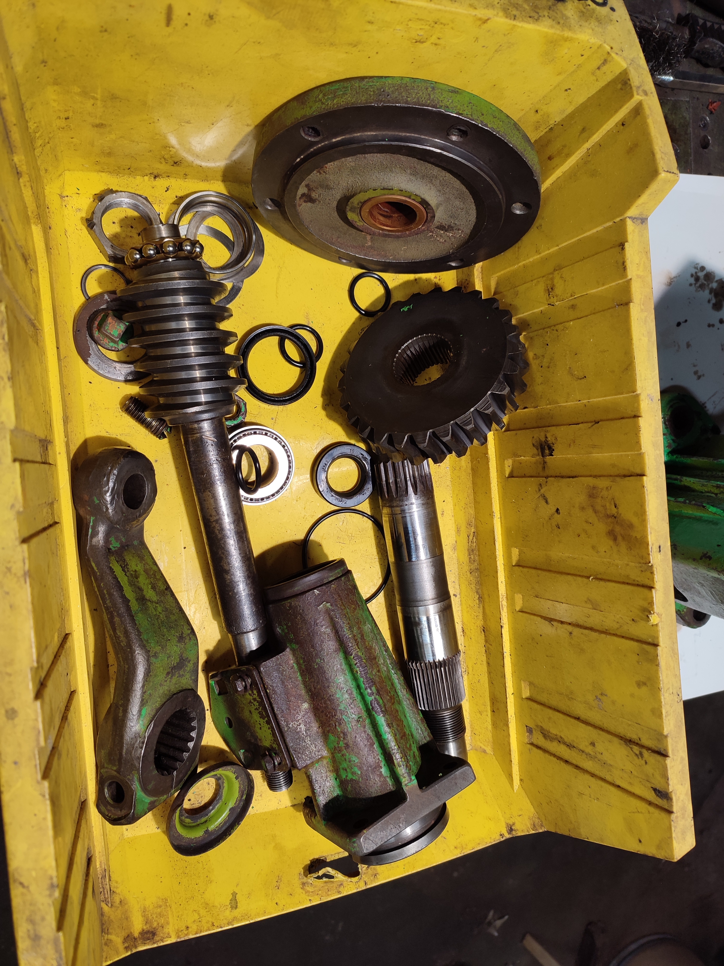

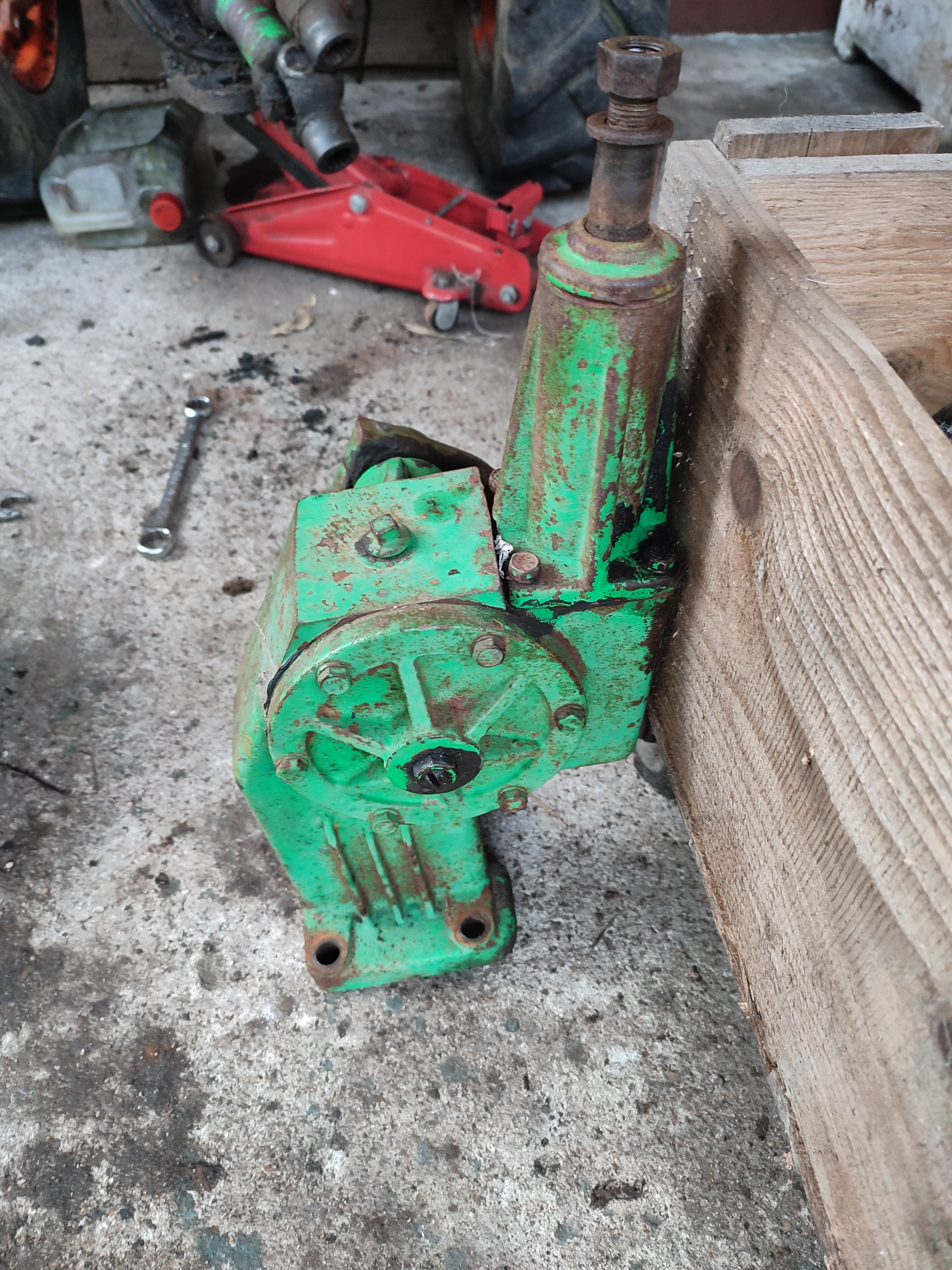

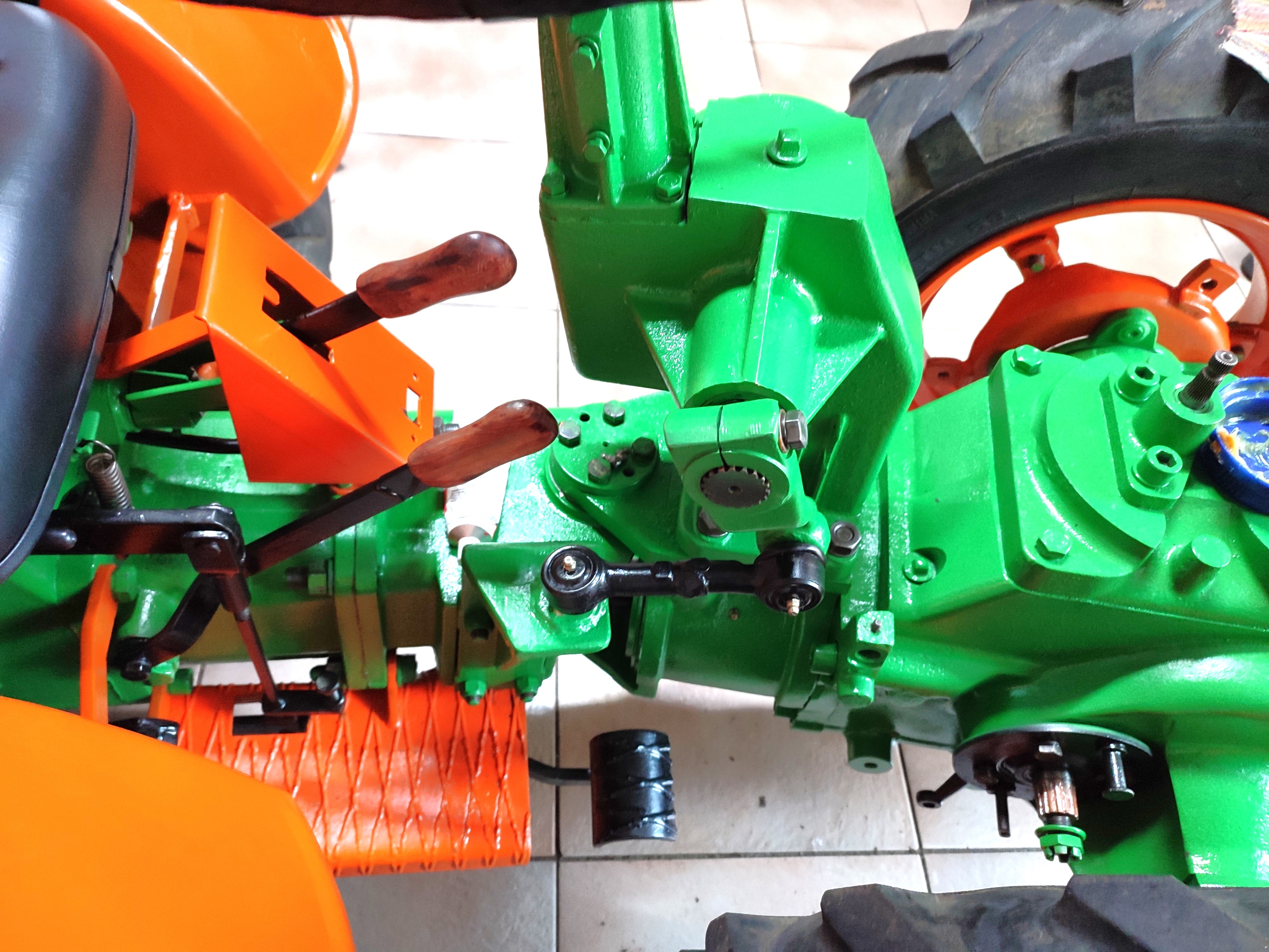

How does the steering work?
On mine, there is this really big and heavy duty steering box (pic #1) mounted in the front half of the tractor. Inside, it's a worm drive and a big gear (pic #2). Then, out the output shaft where the pitman arm mounts. Two steering ball joints, welded back to back, connect the pitman arm to the rear half of the tractor. Hopefully the picture #3 makes it more clear than my explanation.
