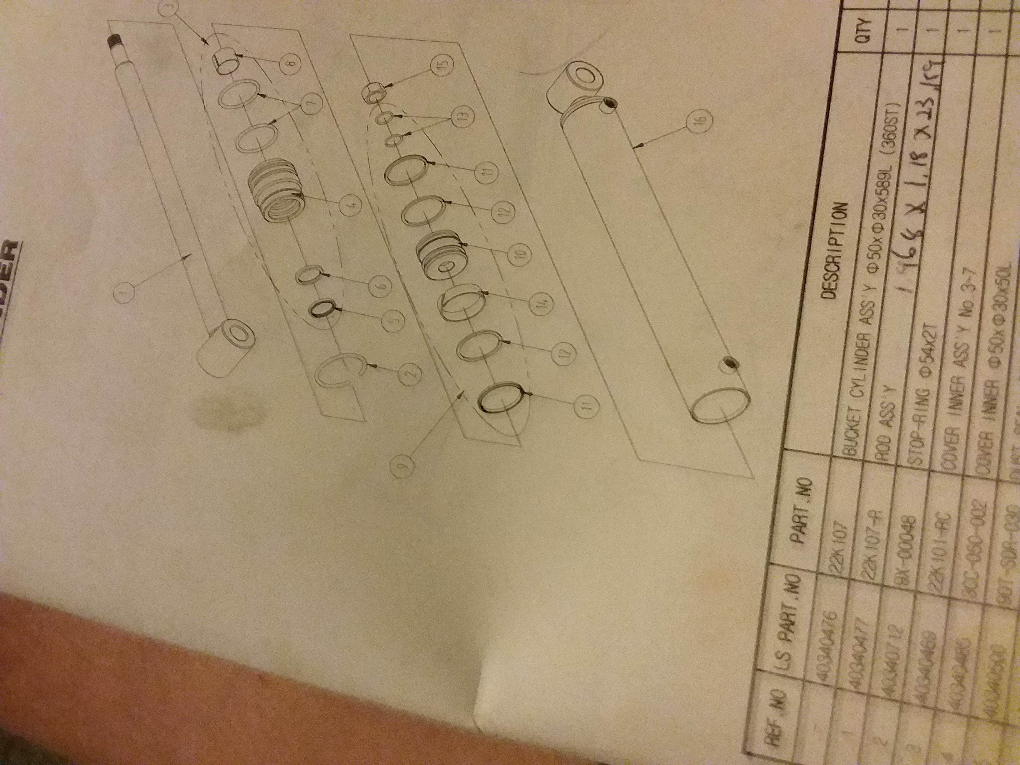

My is not a spin off. I can see the ring, going to take to friends shop today between the 2 of uswe should be able to get it. 20170610_035901.jpg
   / So I busted my curl cylinder ... can't find parts to fix it #34
They covered under warranty. I found the reason for the delay in another thread. LS changed something in their supply system about the time My dealer ordered the part.
I was not completely down. I bought some plugs and capped off the broken cylinder, so I still had some function. With the bad cylinder connected 5he bucket will not curl, if you disconnect and cap/plugs the 2 lines it will work just at 1/2 capacity.
DO NOT do what I did and chain the bucket up. I ended up damaging all 4 of the steel lines. However I did learn a couple of things: that cover behind the bucket is attached to the line stays, if gets bent it could damage the lines. Most important those lines are an off size but they have 3/8 JIC fittings so 3/8 steel hydraulic tube will work.
   / So I busted my curl cylinder ... can't find parts to fix it #35
Got the curl cylinder back together. It was not a rod failure but a nut failure. Looks like a grade 3 nut
