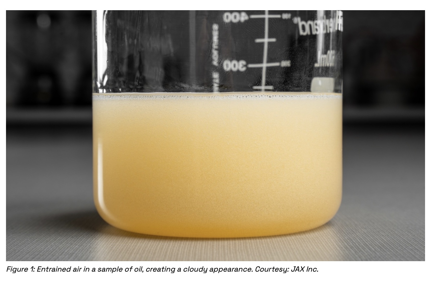

It's easy to tell if you have a suction air leak. Cold hydraulic fluid that has set overnight is clear.
If you pull a sample of oil from the sump when it is hot and you see that the fluid is still clear like it was when the fluid was cold then the tractor doesn't have a suction air leak problem.
But if the hydraulic fluid has air entrained in it the fluid will look cloudy like this photo. Fluid that looks like that is filled with microbubbles of air and will cause the cylinders to be "spongy".
