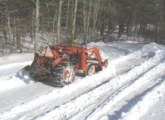

Northland; you could add transverse/diagonal links between the 4 link front chains using just ordinary chain and quick links.[terminology] I did this for my little Kubota 4 link chains and it did improve the ride.:D

Northland: A picture of the chains on the Toy Kubota. I just used ordinary chain and "Split links". The kind that can be spread open and then hammered closed. They are easily available at hardware stores. :D
