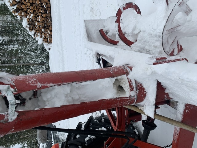

First snows of the year (in this area) are usually wet and packy, with unfrozen ground….. I’m yearning for -20. Keep a shovel with long handle onboard!

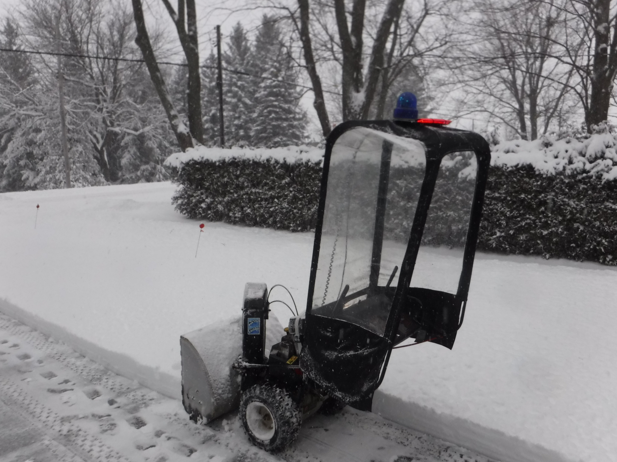

The 3 sided Canopy makes Snowblowing very pleasant. I fashioned an old 12VDC battery drill to the chute shaft and with a DPDT switch rotate the chute with fingertips. Lawn Tractor battery also powers rotating blue light and rear red LED display. Because I can. 10 overnight in Ontario Canada North of Hamilton.

I have a 3 sided "cab" on my snow blower also. Makes a HUGE difference in comfort level for me when getting rid of snow. I also "cobbled" together an air collector off the front of the engine and have it ducted to the front window of the cab. The warm air off the engine does wonders keeping the front window clear.
I have to keep the end of the driveway open. Usually it is at night. While I have a headlight, there was no rear illumination. Not being as energetic, I simply tie wrap a couple of bicycle LED tail lights to the upright posts of the cab. I set one to flash, the other to steady light to provide some warning behind me that I am in the road with the snow blower.
