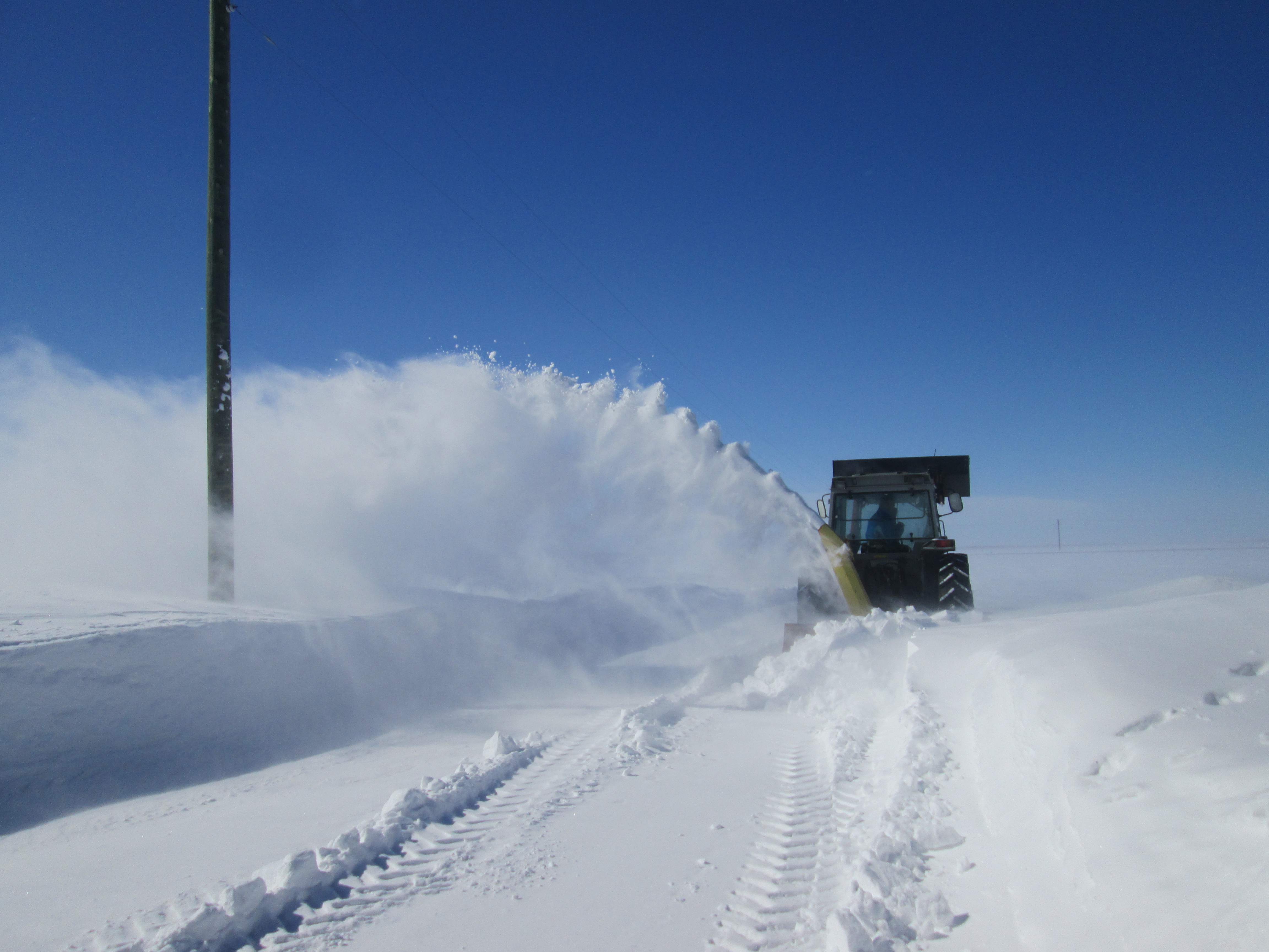

It will work , Just depends how much you have to do . I used to have a 84 inch blower on a JD 2130 and it was painfully slow and underpowered . Right now I have 88hp on a 96 inch Schulte because bigger tractors are loading grain and again it is not enough 110hp is more comfortable . Clearing a yard we find loaders are faster and only use blowers for driveways where you don't want ridging to occur .
