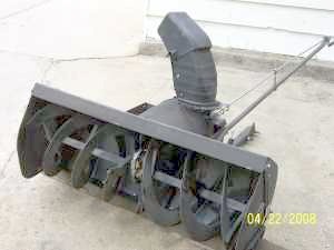

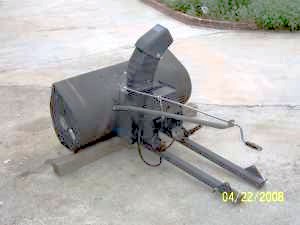

What is a typical speed for a snowblower impeller? Auger? Impeller:auger ratio? I have web searched and searched and mostly find the speeds not listed in mfg specs and in other sources just too much info that does not apply to my specific needs.
Here's what's up. Yesterday I purchased a 46" "garden tractor" snowblower for $250 (a great deal...I think) and I want to convert it to run off my bx23 pto. There are no make/model numbers on the unit but it would seem to be similar to a Berco, more or less. Owner says he purchased from Orchard supply (now Sears?) ten years ago to run on his Kubota scut pto but never got to it, moved to a lower elevation and now moving again and he is "lightening up". The machine has never been used, original paint without a scuff on it but faded for living ouside a number of years, still turns over freely but seems a tad bit stiff. I suspect some disassembly, clean up and fresh lube change will improve that. Alas, no manual.
Here's a couple of photos.
MY unit has a 12" dia four blade impeller and a 16" dia auger. The impeller to auger ratio is 10:1 impeller:auger.
Here are a few example specs:
Kubota B2781 rear 50" 17.5 dia impeller rpm not given, 14" dia auger 286rpm
Kubota BX2750C front 10" 16" dia impeller 903rpm, 12.8" dia auger rpm not given
Puma 48" rear, 20" dia impeller 540rpm, 16" auger rpm not given
Berco snowblowers - impeller/auger dia and rpm's not given
With my smaller impeller (12"dia) and 10:1 impeller:auger ratio I am thinking I need to run faster than any of the above, something like 1000 - 1500 impeller rpm w/ 100 - 150 rpm auger speed. Too fast? Maybe it should run even faster.
If anyone has the missing specs for the examples above that may help. If anyone has a blower similar to mine (or similar specs) that would really help. If anyone has any general observations/comments regarding impeller/auger speeds that would be most appreciated.
Bottom line is I am looking for informed suggestions regarding what speed I should run my impeller.
Thanks - Ray

So I"m reading old TNB posts. Impeller speeds seem to be all about tip velocity. From several examples common tip velocities seem to be between 3000 and 4000 ft/min. For these velocities my 12" dia impeller should be run between 955 and 1273 rmp. Seem right?
This would have a fairly slow auger speed with my 1:10 ratio impeller:auger. My auger flighting is 3" wide whereas I see some specs w/ 1 1/4" and 1 1/2" flighting. Maybe the wider 3" flighting can be run slower? Seems reasonable. Might even run better on our wet snow than thinner flighting turning faster(?).

Based on a 3pt hitch single-stage direct drive snow thrower I once had, 3k -4k ft/min tip speed is on the slow side. Dry snow will fly 20-25 feet but wet slushy stuff will fall 8 or 10 feet away. That may be enough unless you are clearing a double-width driveway area. I found that a tip speed up around 4500 did a good job under most conditions. There's some talk of tip speed scattered in this thread about adding a 2nd pto speed to my tractor.

Thanks rbargeron, your reply and especially your linked post was quite helpful. I think I am going to up my target velocity a bit and try for at least 4000, maybe 4200ft/min. This would put my impeller rpm around 1000, 1200. If my mod works I think the unit can handle the increased rpm's.

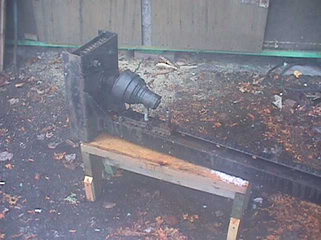

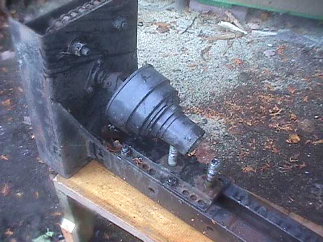

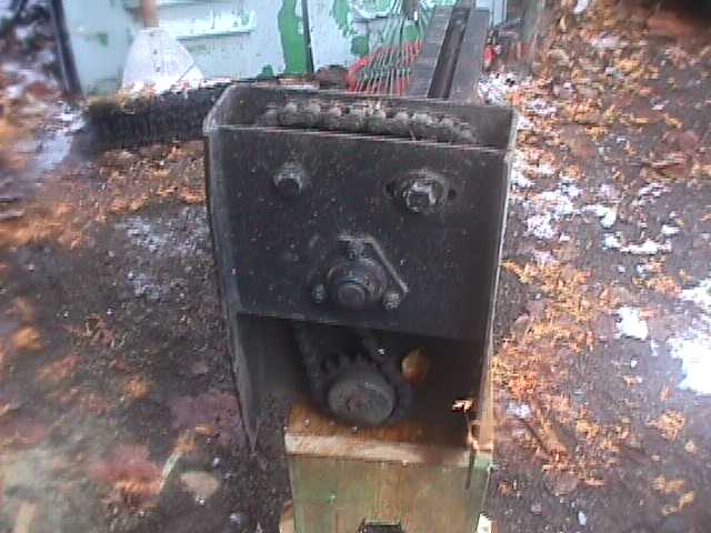

.............. I need to reverse direction and this is a challenge mechanically.......
Yes - I noticed the chute was on the opposite side from most machines. In past years Bervac made an interesting adapter for putting a rear-mount up front - they used an extra sprocket to change pto direction. There would be some opportunity to change speed with sprocket sizes. pics below. Erskine's chain box is enclosed running in oil. But for homeowner use an exposed setup might hold up well enough.
Boy, would that be a handy item for me to have right now. Anyone got one to let go?
I have searched for a suitable gear box on the web and come up empty. Lots of boxes available, especially right angle ones, but parallel shaft in the 2:1 range are not to be found. Anyone know a source?
I had a better reply written then accidentally closed the page before sending. Hate it when that happens. Here's the condensed version.
Buddy came and we brainstormed a pulley/belt solution. Seemed better than my chain/sprocket. Hours of struggling to get it developed on CAD just led to the conclusion it would not work. Too many twists in confined spaces. Belt would have jumped the sprockets. I'm now reviving a previously dicarded concept using spur gears. The design came out well and the plan is off to Owen for look-see-comment.
I had to sacrifice 200 rpm from the belt design to keep cost comparable and keep the conversion package within the confines of the blower body. If I use the bigger gears material cost goes up 40% and the gears need more complicated support. I should get 1080 rpm, 4000ft/min impeller tip velocity. Hope that is enough. I don't need to throw but about 10' -15', 20' - 25' would be a bonus. Too bad wet snow is what we normally get.
I'm also having trouble finding a web source for American gears. Found a great metric gear place, Quality Transmission Components, qtcgears.com compleate with detailed measurements and cad drawings of thousands of gears. But no one like it for fractional gears. Owen is a quality machinist so we will bore out metric gears if we need to but finding the right bores in the first place could save that step. Anyone know a source?
