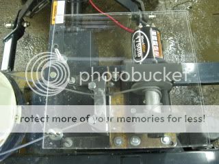

First question: I have had no problems with my chute control. The system that I used is very simple(read cheap) and is made with components that are built for a hostile environment.
2nd:The power draw is light enough that any alternator upgrades are not required.
If you would like a picture run down of the chute control I can post.
Dan
TGReaper- I'd like more info about what you used, where can it be purchased and how you attached it. Thanks
/ Snowblower dealers in MA? #36

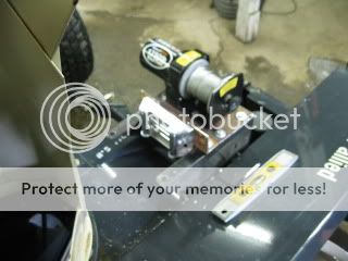

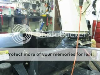

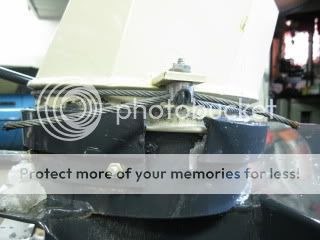

149 Owner:
The easiest way for me to respond to your question is to post some pic's,if you have further questions after you look at them just ask.
Dan
This is a standard ATV winch available at Princess Auto/Harbour Frt.etc.
$45to$75

That's a pretty slick setup you've got TGReaper! I see Harbor Freight has a similar 2K unit on sale for $70 but with a 20% off coupon it's only $64. It looks like you can spin the chute 360 degrees so you must have to keep a close eye on it when rotating it so you don't get a faceful of snow.
/ Snowblower dealers in MA? #39
And I just picked up one at HF with wireless remote for 59.99. Actually it was two weeks ago. Not sure if they have sold them all off or not.
