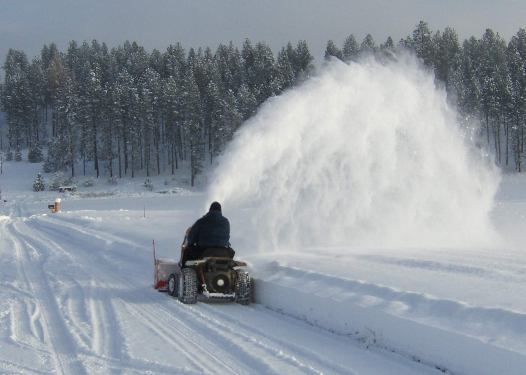

/ Snowblower Conversion - Pics #42
Gravely 816 tractor, 48" blower, ~20" snow. I did about 1/2 mile of road several times, and several driveways. Was fun to really use the blower. the "tunnel" had been ballooned out from previous owner, impeller worn. I took and cut some old tire tread and bolted to impeller to reduce tip clearance. It blows what ever snow I encounter now.

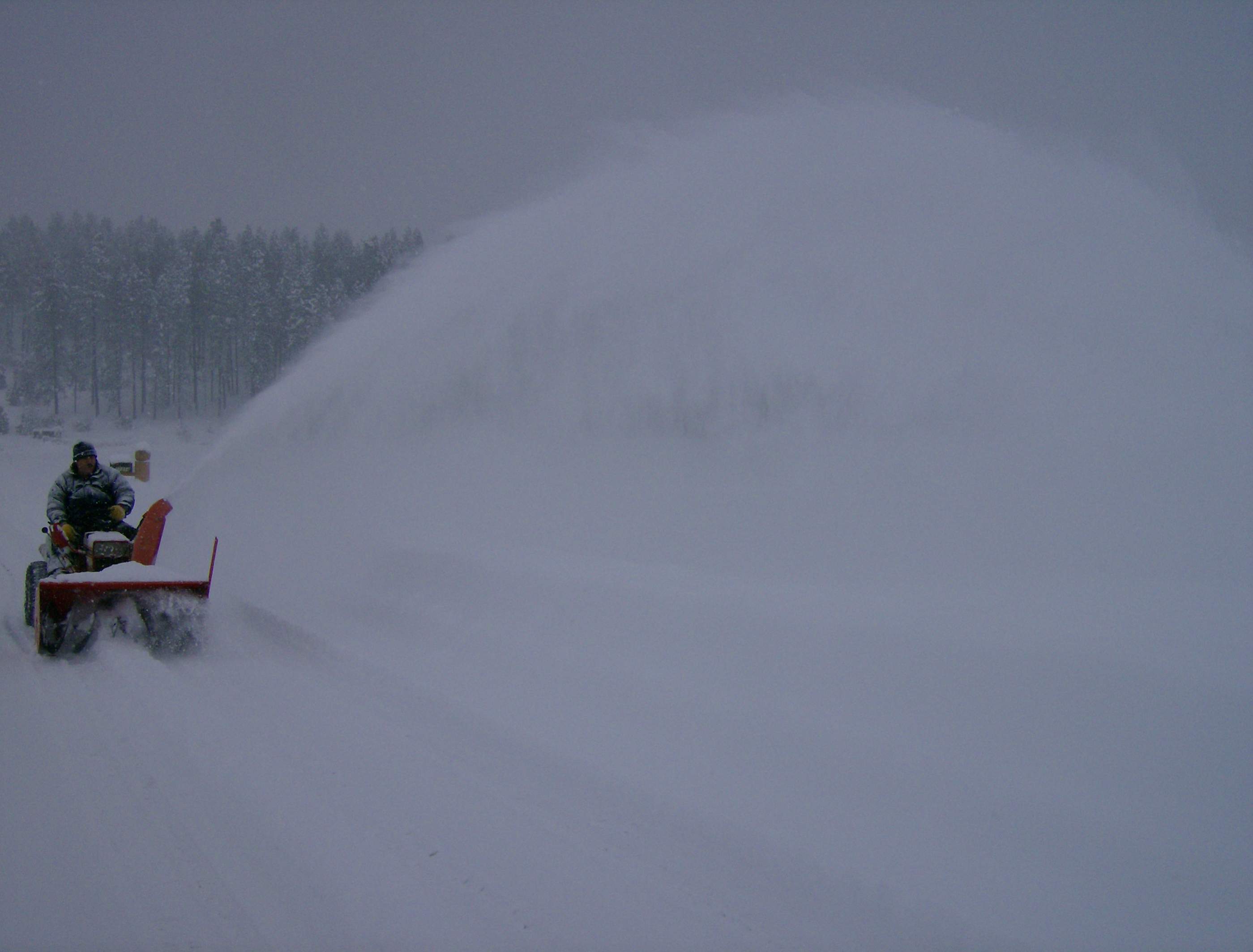

/ Snowblower Conversion - Pics #44
Gravely tractors have blowers on the front. No 3pt available. Hydraulic lift to raise it, crank easily reached sitting down to change chute direction, cable pull to change chute distance.

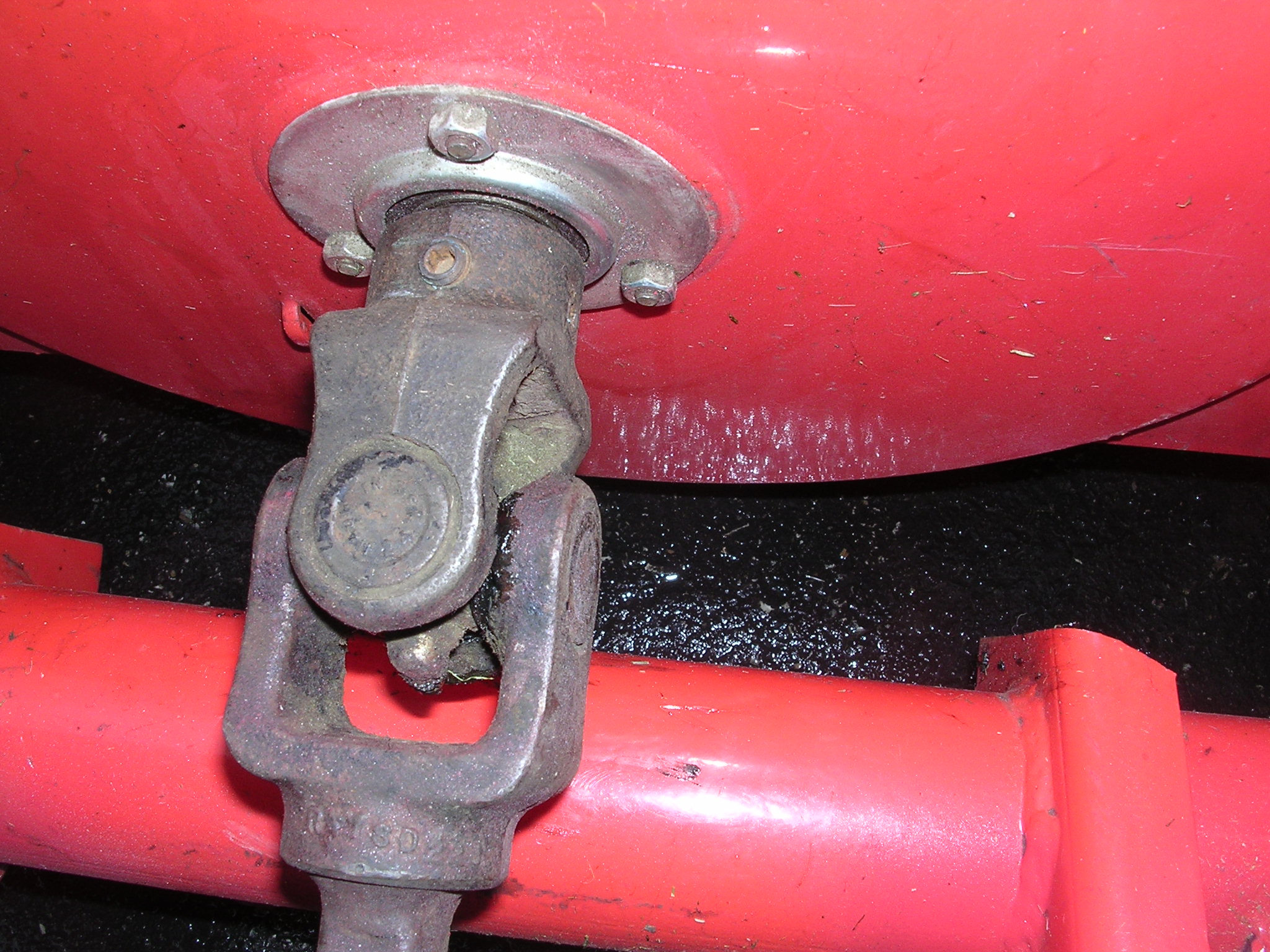

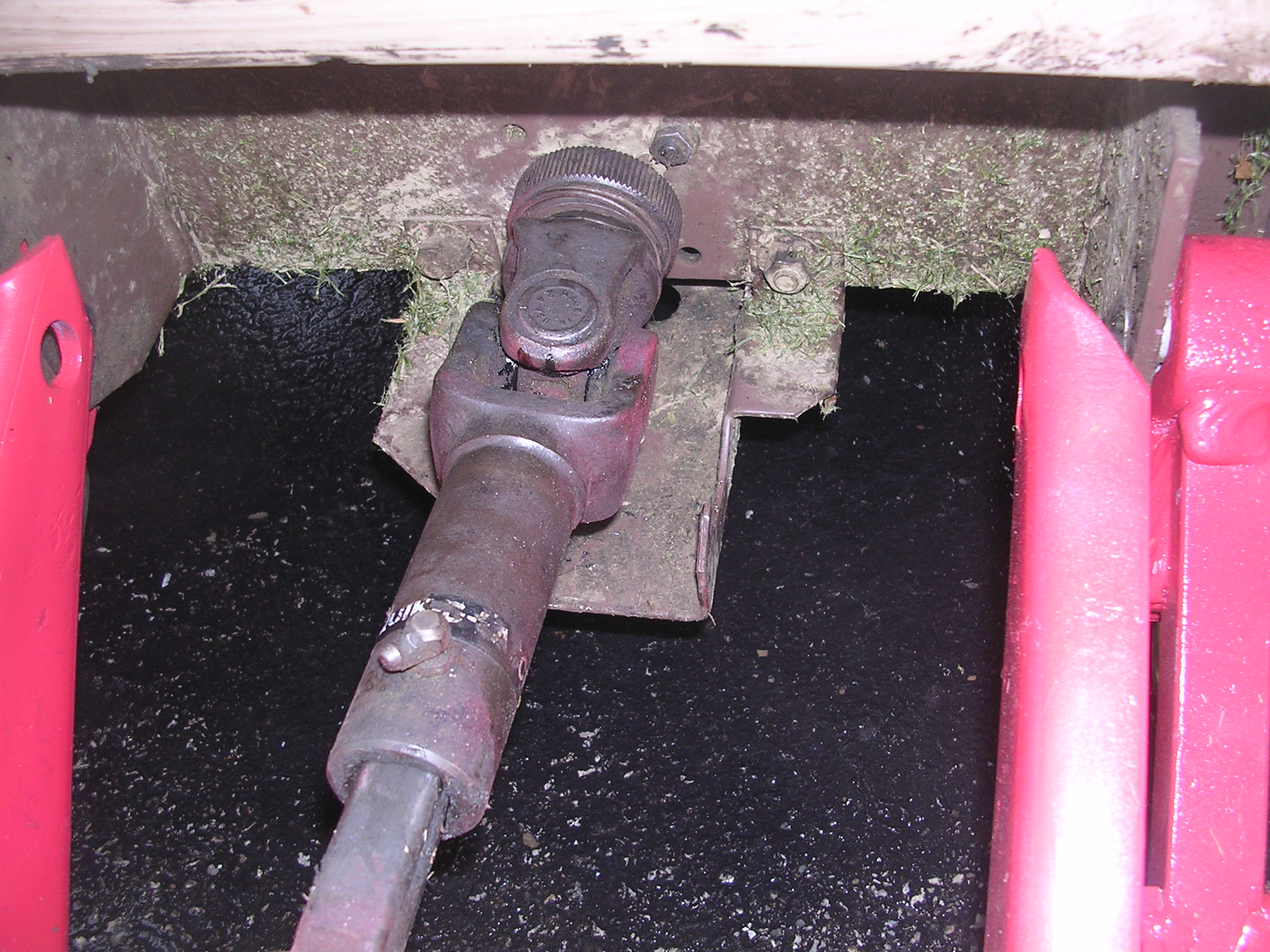

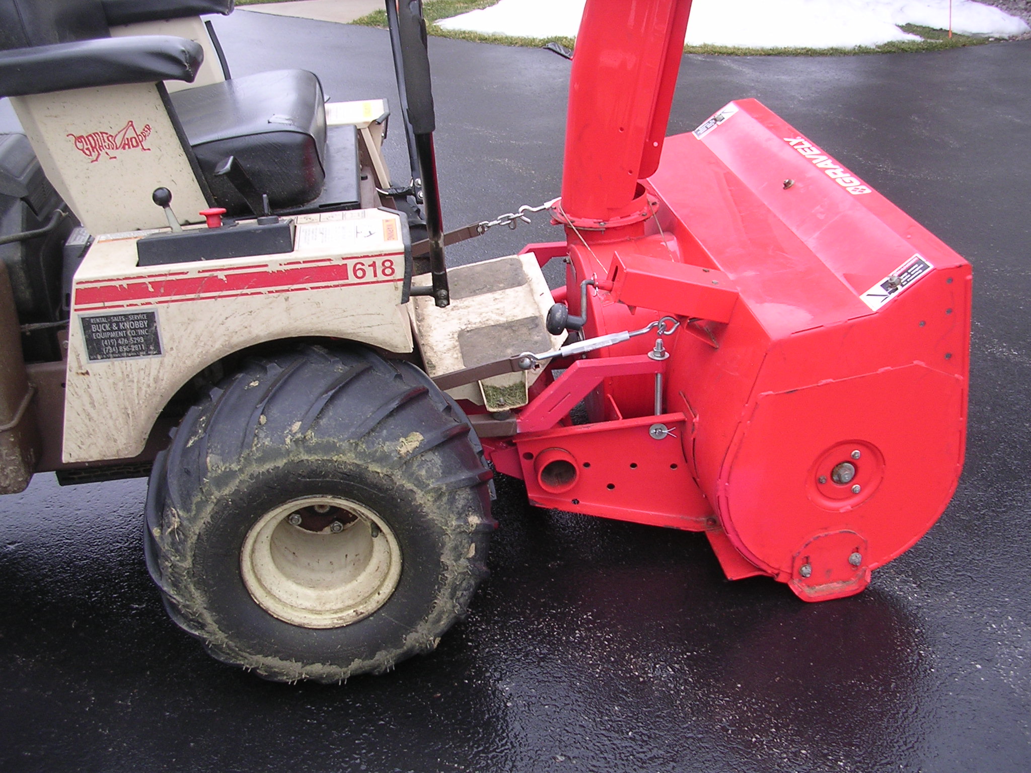

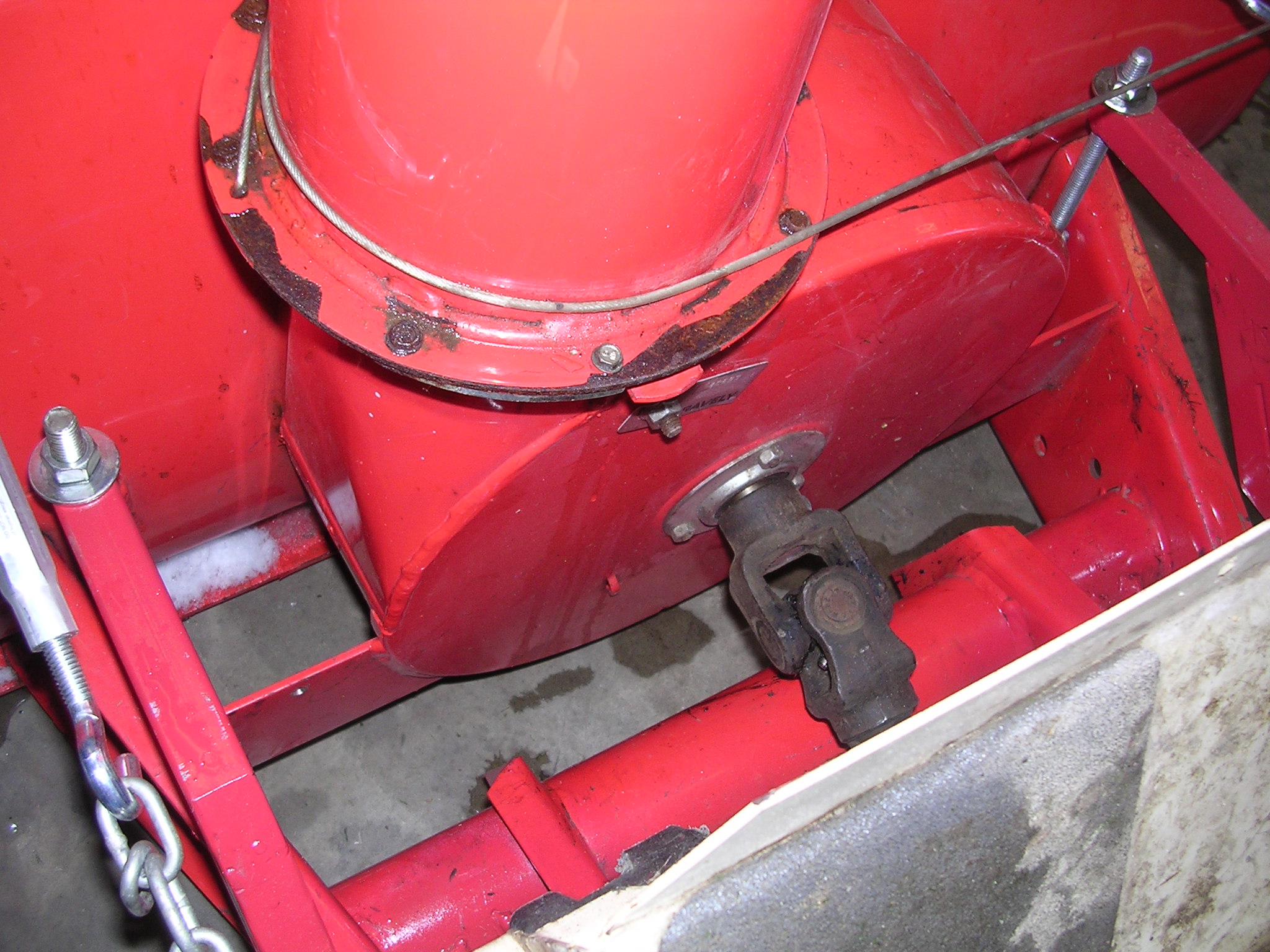

/ Snowblower Conversion - Pics #47
Hi RedDirt, I noticed your post from a while ago on changing the shaft direction on your snow blower project. I have the same type of problem that you had. I purchased a Gravely 40 inch new snow blower that I converted to mount on the front of my 618 Grasshopper mower, everthing worked fine and the pto. shaft seems to turn at the proper rpm, but rotates in the wrong direction. I was thinking about using some spur gears like I noticed that you did. I think that i could use two gears that have the same tooth count and about 2inch dia. with a 1in. bore. I have very limited space to work in. I don t know if the spur gears will work ok without running in some lubricant. I am already over budget and don t know if I should continue with this project. I will try to send some photos in hope that maybe you could give some advice on this project. thanks Dave
