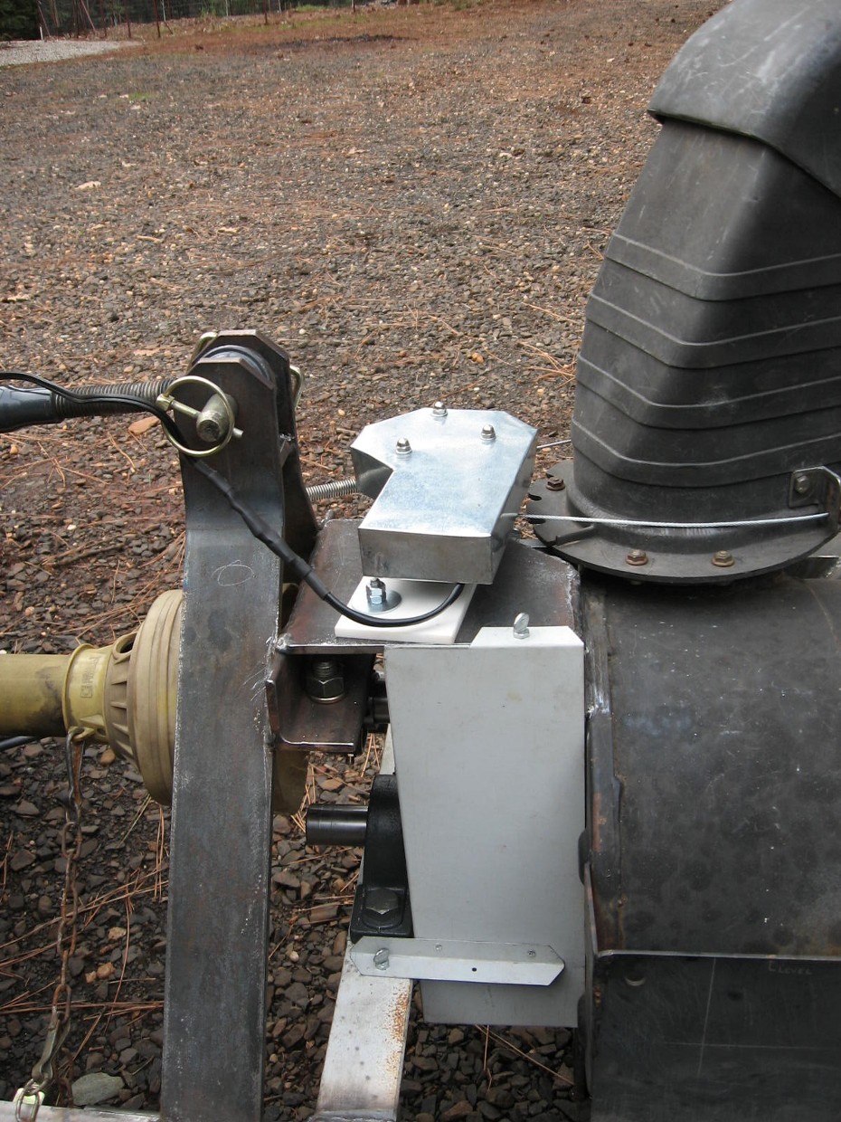

My gears are open and I intend to manually grease about every ten hrs +/- when I grease the bearings and PTO. The gears are protected by sheet metal covers as a safety precaution and also to contain the grease that will be slung out. Being a winter snow machine I don't anticipate dust and dirt contamination to be an issue.
I have not used the blower at all except for a full speed test with no load. Still waiting for winter to arrive. I know a lot of the country is getting severe conditions but not here yet.
For gear selection check out the engineering tool at rushgears.com. Using the tool I was able to match the strength of my gears to the tractor's PTO HP. Rush Gears just makes custom one-off gears so buying there is out of the question. I bought my gears from McMaster Carr. They have a decent selection but the 20 degree pitch angle gears I would have preferred (a bit stronger) were not available and I had to settle for 14 1/2 PA gears.
Eyeball engineering said my small gear should not be less than 3" dia ($87+/-). My 1:2 ration dictated the large gear then at 6" ($140). The gears come without keyways or setscrew bores so you'll need to provide them yourself.

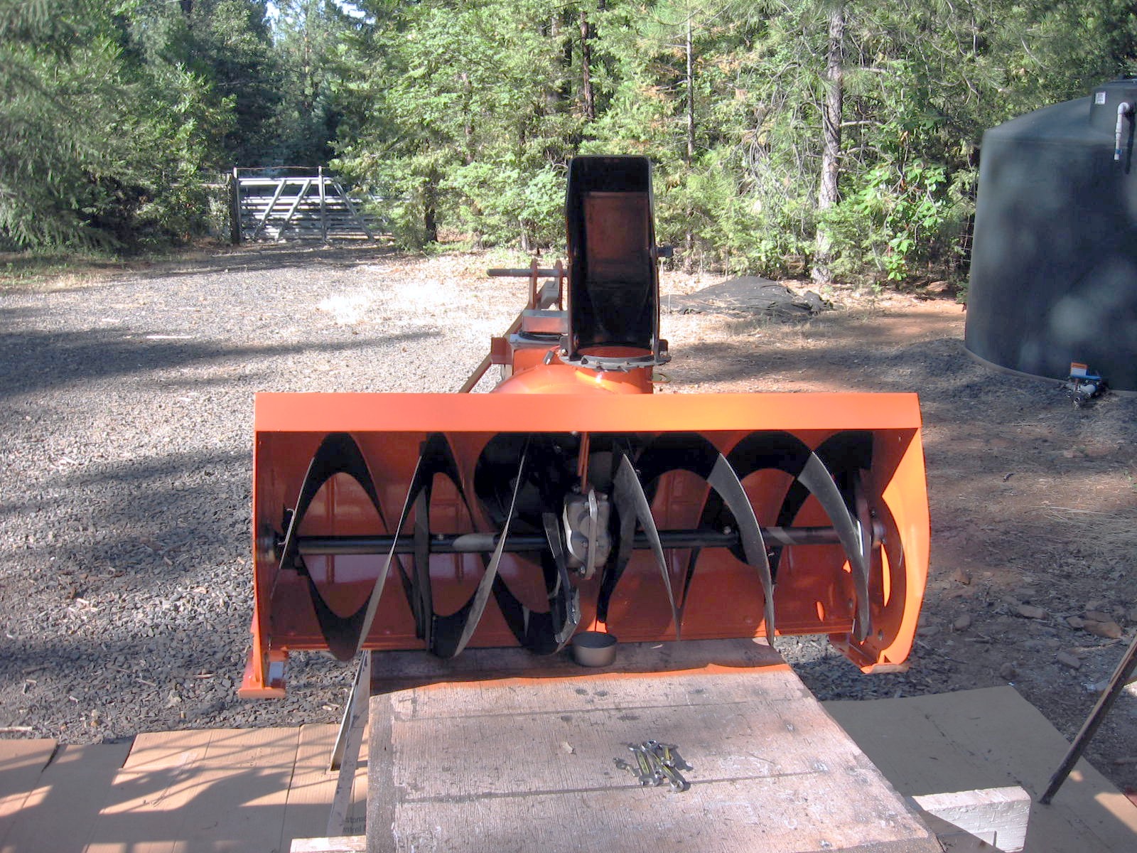

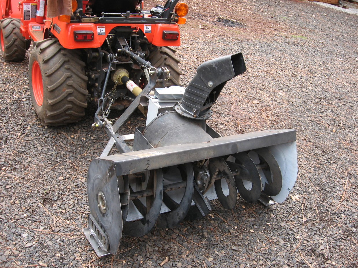

I realize I never posted any finished pictures of the converted blower so here are a few. It was finished several weeks ago and I've been waiting for snow to test it out.

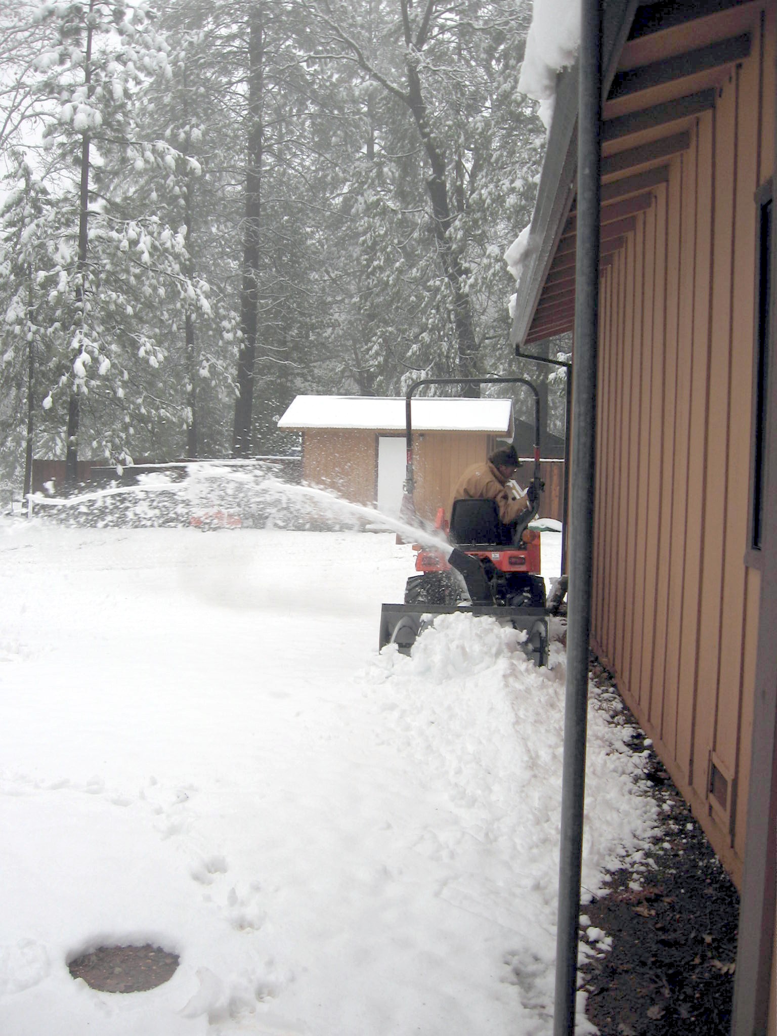

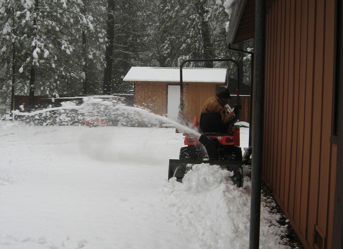

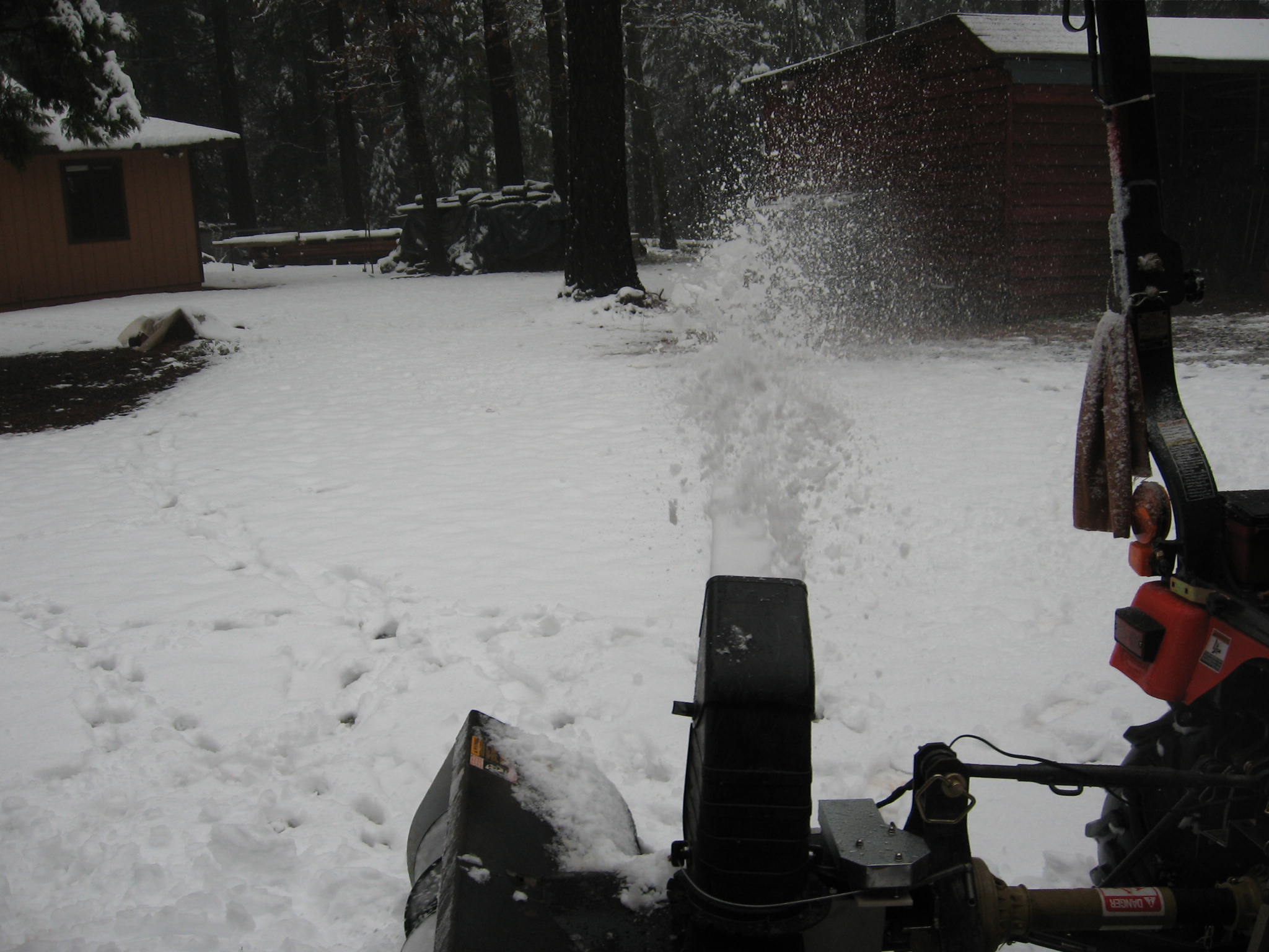

We finally got a little snow; a measly 3". With the blower set two inches above gravel I had to blow the stuff that had slid off the roof in order to get a bit of volume in the blower.
Over all I was satisfied. I'm getting about 12ft-15ft throw with VERY heavy wet show. This is a bit less distance I was looking for so when I tear down in the spring to paint I might add the impeller rebuild rubbers that have been discussed elsewhere on TBN. Currently my impeller to housing clearance is about 1/4 -5/16 inch. The add-on rubbers will close this gap to almost zero and my throw should be increased.

The 4000ft/min worked OK for me. We never got enough snow last season to give it a workout so at one light snow I had to test it at the eave drop of my roof. This is some wet, slushy stuff.

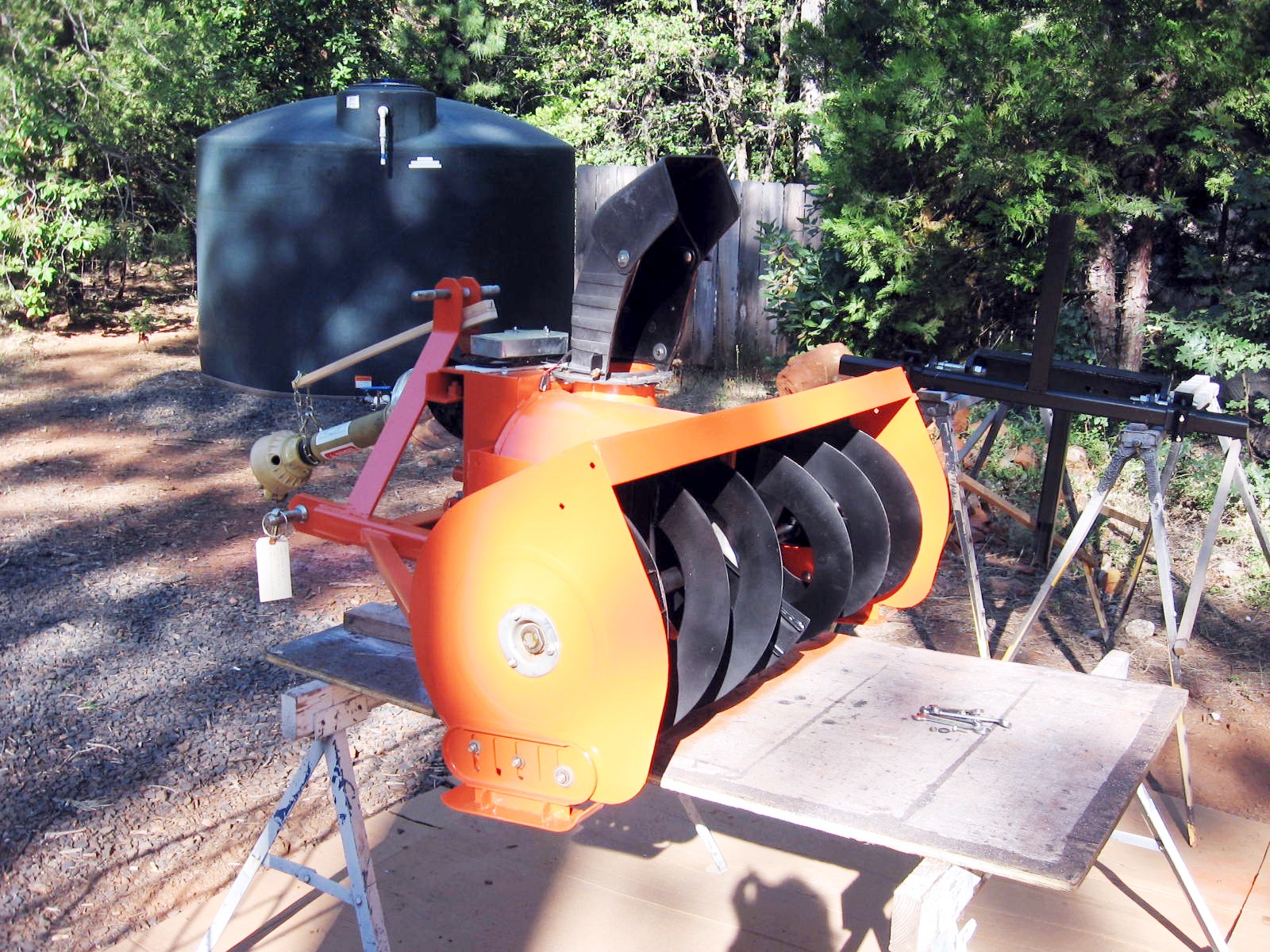

And I just finished painting last season's 7 build projects. Here's the blower.
