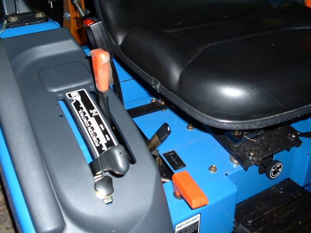

Dave,
Here is a pic of the control lever next to the parking brake set lever

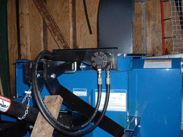

/ Snowblower - chute rotation question #13
And finally a pic of the chute and the hydraulic motor. I was impressed with the setup. Hope these pics help.
Brad

/ Snowblower - chute rotation question #16
Thanks for the pictures Brad. Very nice setup. So on your rear axle you have two remotes. I assume there is no hose that snakes from the back to the front then? If you don't mind me asking how much did the basic blower cost?
/ Snowblower - chute rotation question #17
Dave,
From what I understand, the tractor comes from the factory ready for the rear remotes. The dealer added the kit which taps into the hydraulic system.
The basic blower showed up on the invoice as $1400, but that was part of a package. Most places I checked had the blowers at around $1700 in the 49" to 54" range.
Brad
