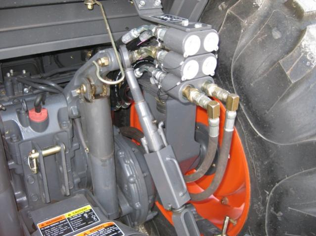

The pic here shows a stack of 3 remotes on a similar Kubota. There will be 3 levers in the cab to separately control these outlets.

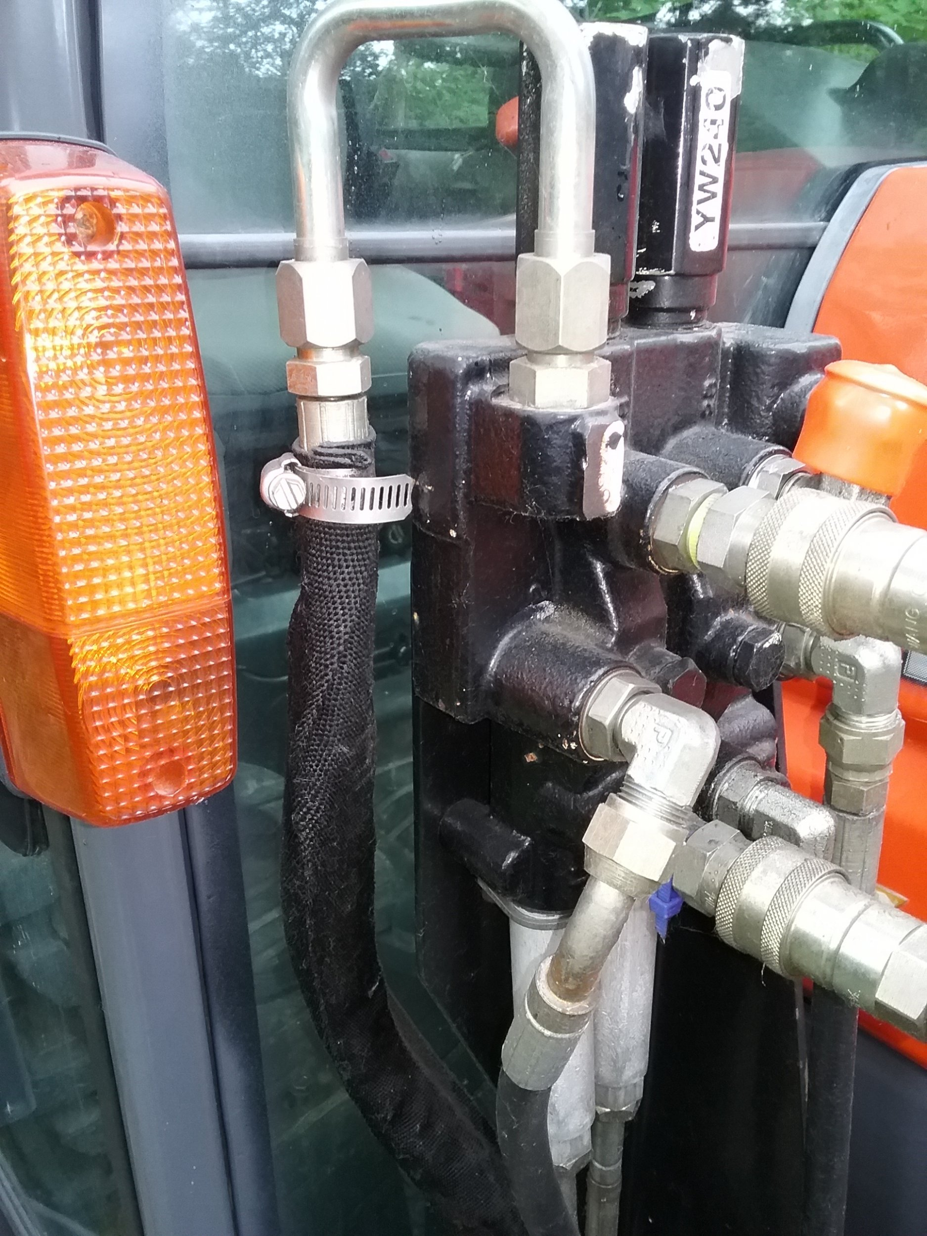

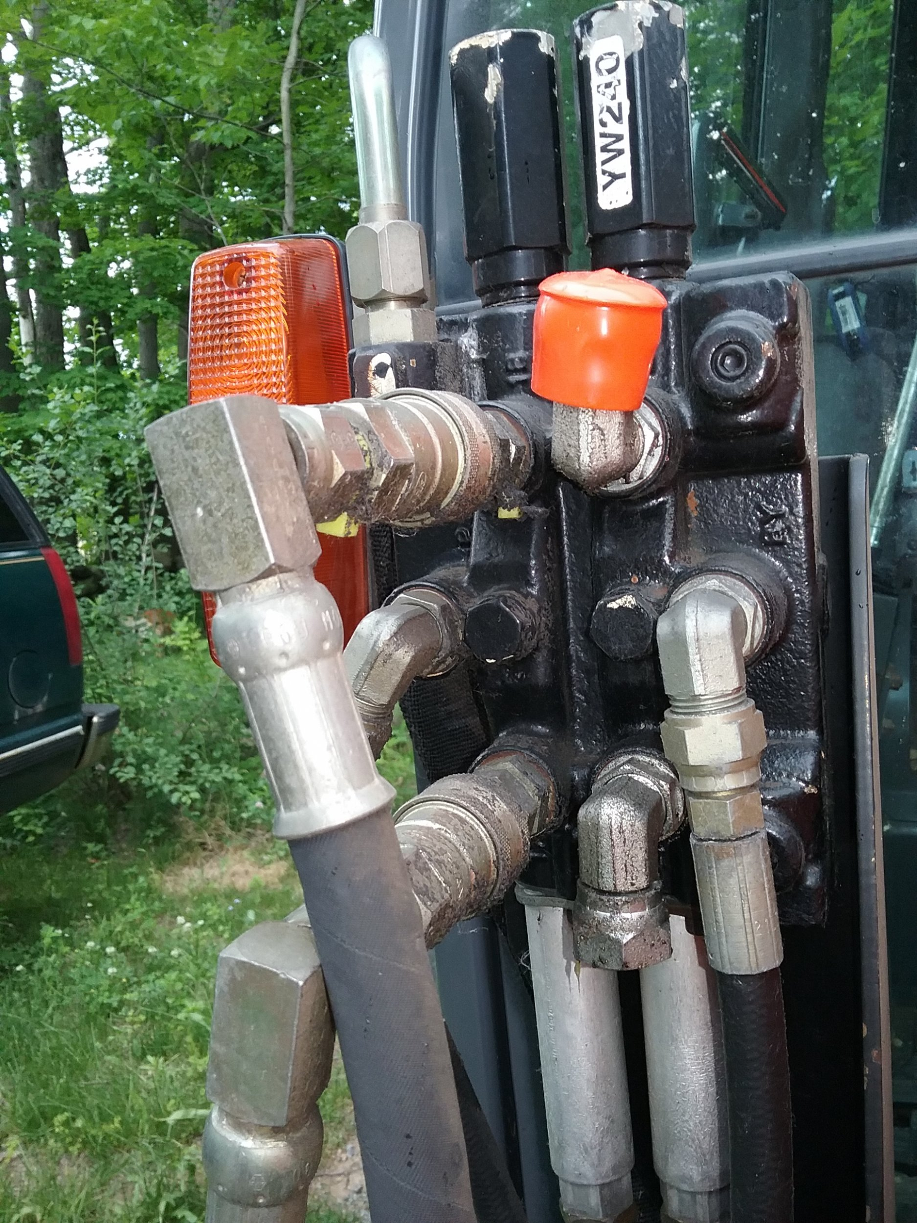

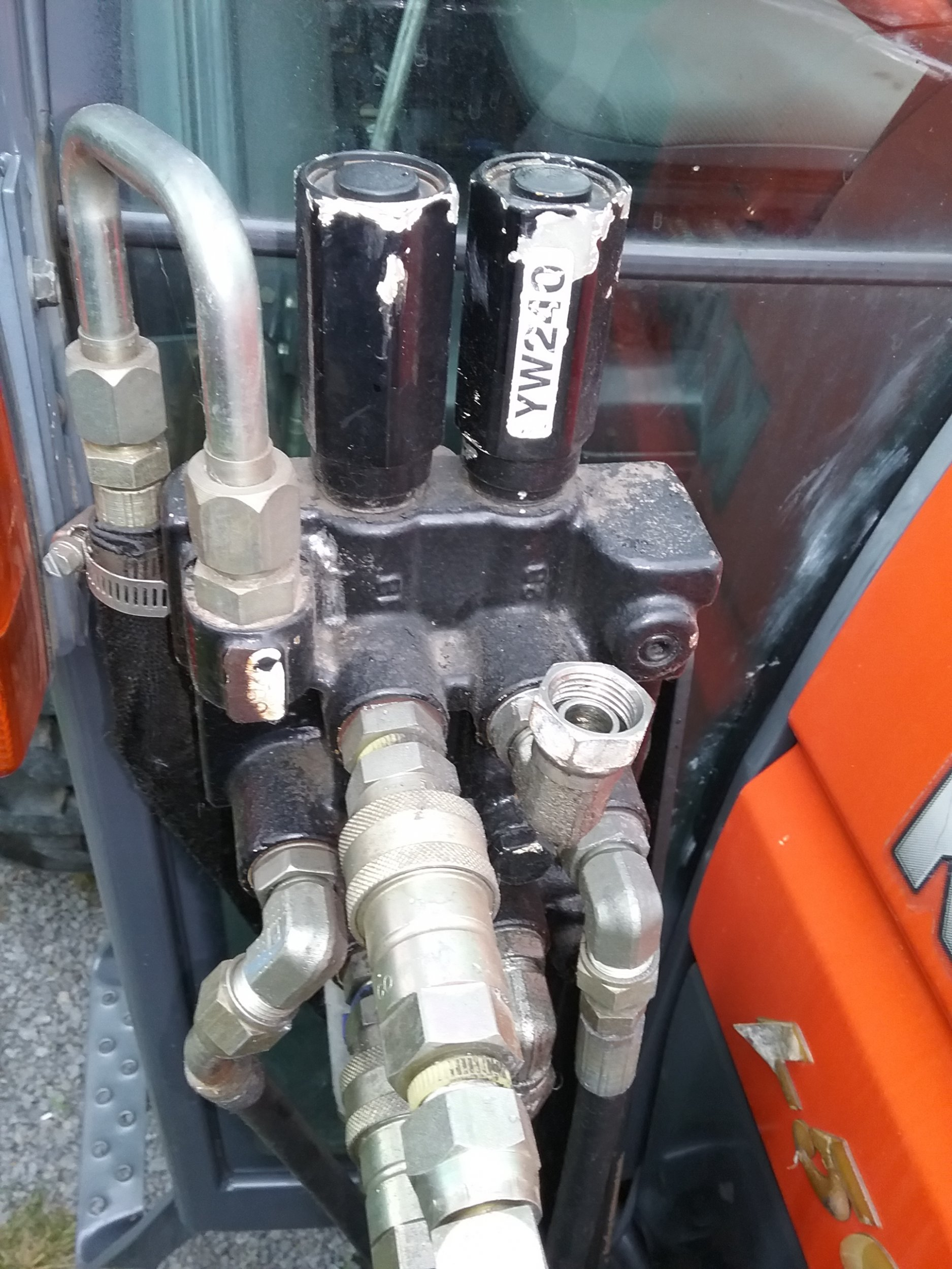

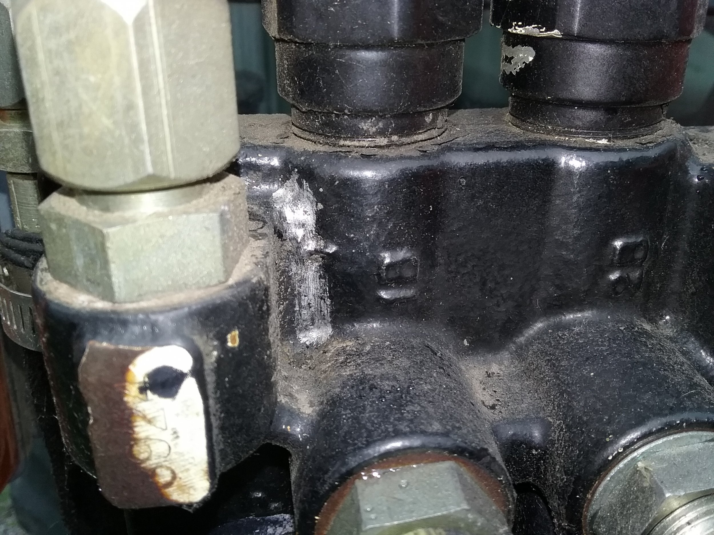

This thing is challenging to figure out for me while I'm working nights and sleeping days. So... the joystick is cable operated to a valve body where two hoses leave there and become the rear remote. It "looks" like power beyond is routed back into the system right now due to no loader or other implements. Apparently, this tractor wasn't sold with installed remotes, as there's no valve body/port box or levers under the slots where they would be. I'm thinking I could get the kit with a diverter valve and remote with hoses and plumb it into where the loader hoses would go, and run them to the back for a second remote with a flow restrictor in line for the hyd. motor for the rotator. Just need to figure out which hoses go to which ports, and what to do with the pwr. beyond circuit. FUN STUFF.

Looking at your post #9, it looks to me like you have a loader valve with cable activation.
The valve in your 4th photo is it at the rear of your tractor or the mid area?
It appears that there are two male couplings mounted to the valve with hoses and female couplings. Are thes the lines that are going to the rear of your tractor?
The other valve has open hose ends in the pictures. What where they connected to?
That is the second spool of the two spool loader valve.
"I'm thinking I could get the kit with a diverter valve and remote with hoses and plumb it into where the loader hoses would go, and run them to the back for a second remote with a flow restrictor in line for the hyd. motor for the rotator. Just need to figure out which hoses go to which ports, and what to do with the pwr. beyond circuit. FUN STUFF."
If the two hoses on the cable operated valve go to the rear for remotes, all you would need for a second set of rear remotes would be hoses and couplers.
The two ports with elbow fittings are the output ports for the second spool of that valve.
You do not need to do anything with the power beyond circuit.

Lou, you nailed it. It took me a bit before I realized the joystick operated by cables. The only only others I've ever used were direct hydraulic plumbed. Not used to these new-fangled gizmos yet! So, yes. I'll be using the other two open ports on the loader circuit to run hoses back to the rear and stack them on top of the set that the previous owner put there (4th photo you referred to). I'll also use flow restrictors in line on both devices. I found a parts diagram online from the manufacturer of the blower, and they plumbed in reducing bushings to serve that purpose. I'll likely do the same. gotta spend a few minutes on a day off to do some measuring for all these hoses, put a material list together for all the components and then find my checkbook to go buy it all.
