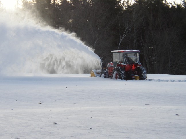

Once you have a snowblower there might not be any big piles left to move. A blower will chew up a pile - and if you point the chute right you should rarely need to handle the snow a second time. A good place to start is a big rear-facing back-up style blower. They are rugged and simple and not too expensive (the White you are looking at is a good example). Lots of owners say they like rear blowers because the front loader is still available.
I take off the loader in winter even with a rear mount blower - much better maneuverability in tight spots. For your DK50 the Cadillac blower would the Erskine front mount (driven from the rear pto). If the gods were really smiling, you'd find a decent used one somewhere, 78" wide, and priced under the national debt :cool:.

For a 1/4 mile driveway I would not want to have deal with long periods of twisting my neck to go in reverse. If you can find a front mount you will not regret it. I have had both and sold the rear mount a few years ago. We get a ton of snow and I have needed the loader. The blower will move any pile you can throw at it....

I'd think about a rear mount, forward facing blower like this. If you're related to the Exorcist the rear facing style is probably fine, but my neck got really sore.
