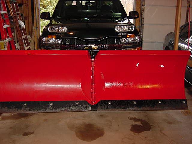

I tried the wax thing before and it worked wonderfully...for about three times. Problem is it wears off. Then what? Can't do a very good wax job at anything below 50 degrees. Ski wax works (not the cross-country type!) but the cost of things like F4 makes that pretty expensive! Pam works, and so does WD-40, no matter how cold or sloppy it gets. So that's what I use...when I remember.
Pete

I must have too much time on my hands. Today coated 1/2 the blade with Turtle Car Wax and the other 1/2 with WD40. Will run my own unscientific test to see which if either is better. Will try Pam if these don't work.
Locals I've talked to made comments similar to your's on the wax being worn off by the sand/grit that ends up in the snow.
Interesting discussions on the pros and cons of using WD40. TBN is an excellent place for people to voice their opinions, advice, etc. as long as it stays clean, etc. per Board Guidelines.
penokee /forums/images/graemlins/smile.gif
ps: Attached a picture of the blade - As you look at it, the right side is coated with WD40 and the left side with Turtle Car Wax. The WD40 appears to have given it a glossier finish.
