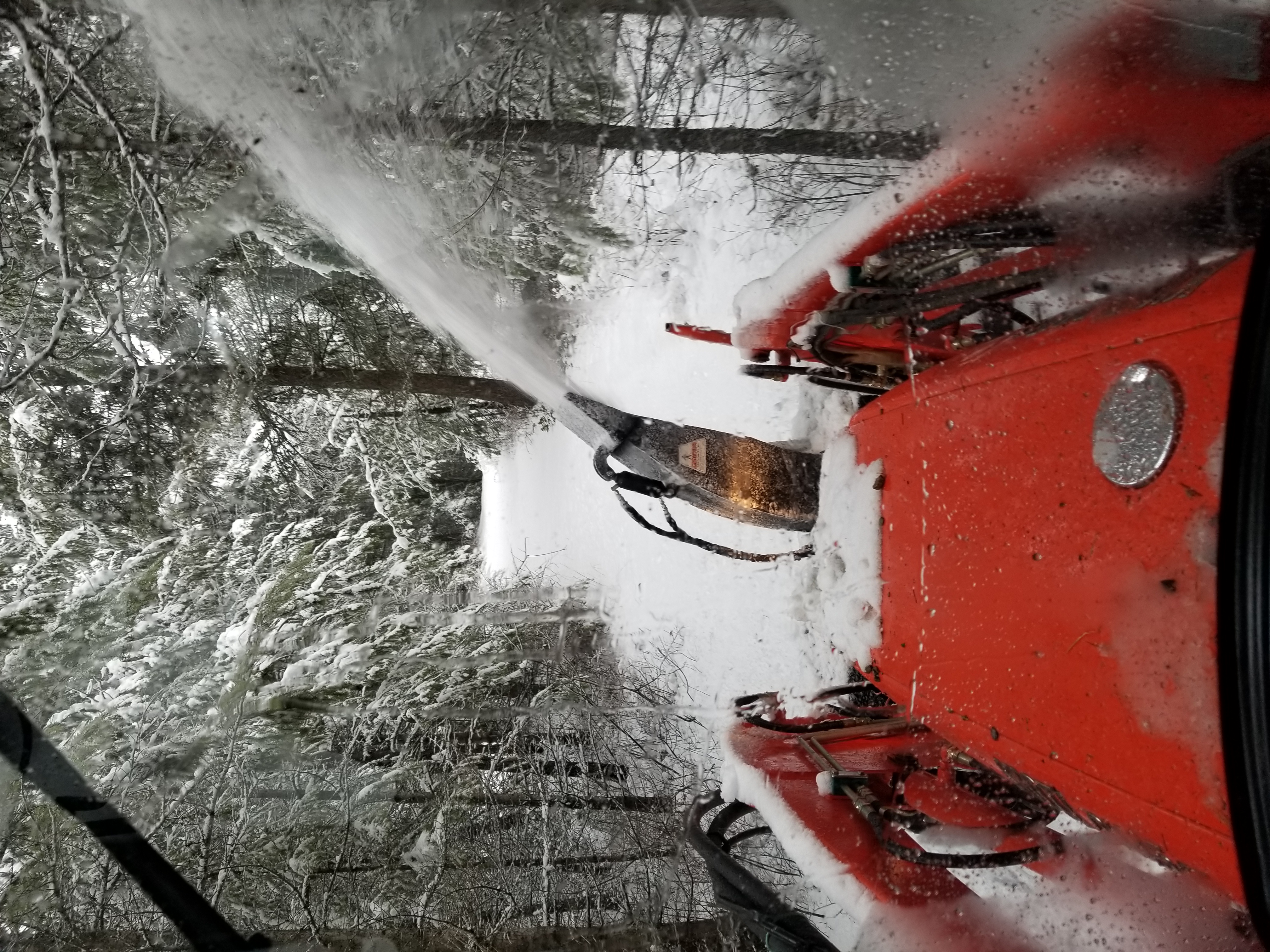

4F7A4B64-E463-48B2-94D6-E177640DC441.jpegHave about 9-10 so far... still coming down. I blew snow earlier this evening so as not to be overwhelmed tomorrow. Have loaded mounted blower with 3 point hydraulic tank and rear pto pump.

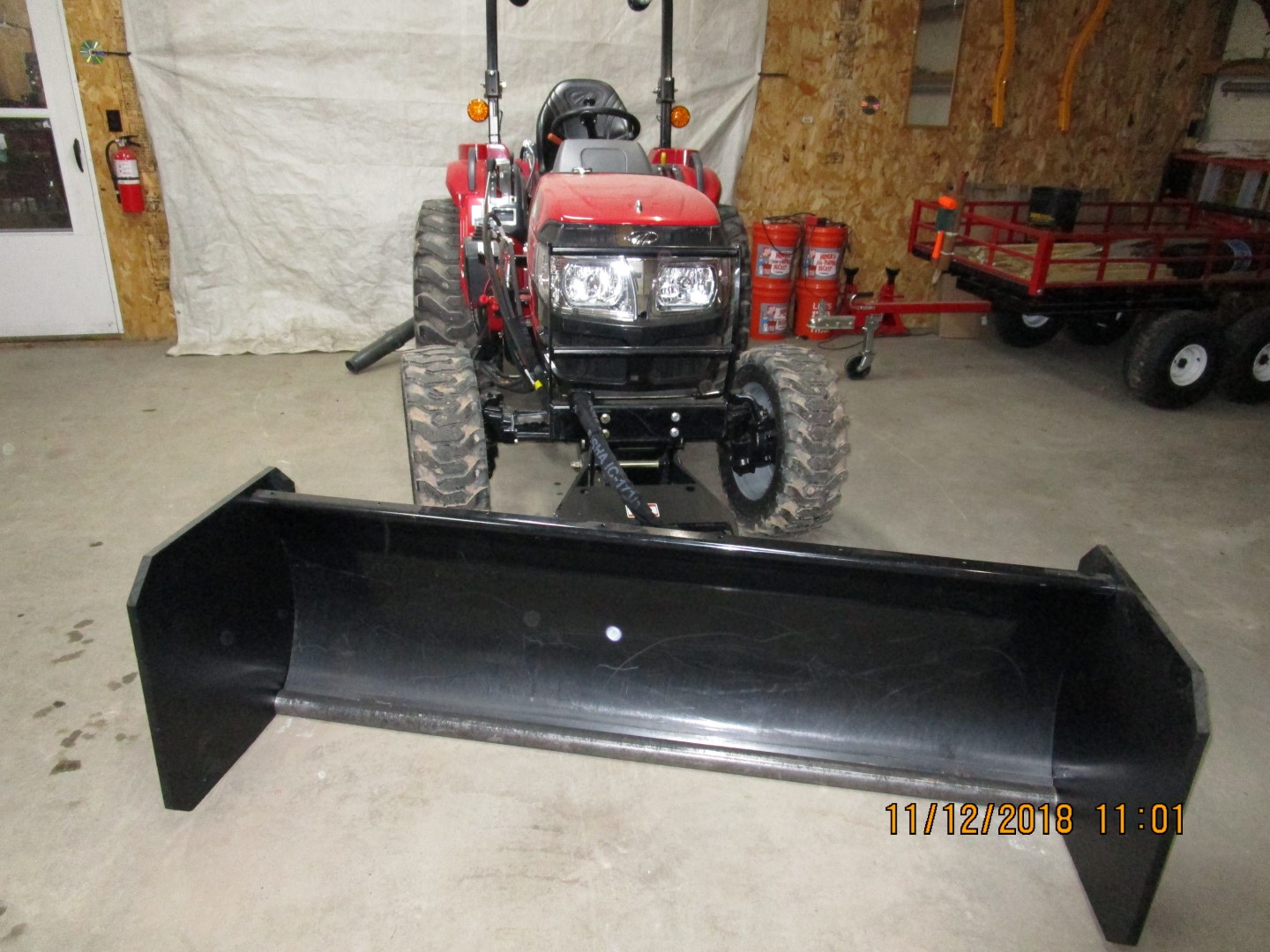

Plowing [ or blowing snow on ] gravel is always a pain until you get the top surface to freeze up. You will then still run into soft spots near mailboxes and the edge of the road. If the roadway is froze, you will still dig in if you get over onto areas that have been covered with snow that you are widening out. On your 94" front blade, you could add a steel pipe over your cutting edge that will help a lot. But it will still dig in if the ground gets soft. Our local machining/steel outfits make and stock them in quantity. But you can make one out of 2" I.D. schedule 80 [ 1/4" wall ] steel pipe. You cut a slot in the pipe with a plasma cutter that will allow you to slide the pipe onto the blade. Then add a couple tabs welded onto the pipe, then bolted onto the blade to keep it in place. Does not take much to keep it on. You can go bigger pipe, but 2" seems to be the norm up here. I used to use ABS pipe, and tried bigger sizes. At some point it will just ride up on top too much. I have them on both of my blowers and my little front blade. Not perfect, but works better.
