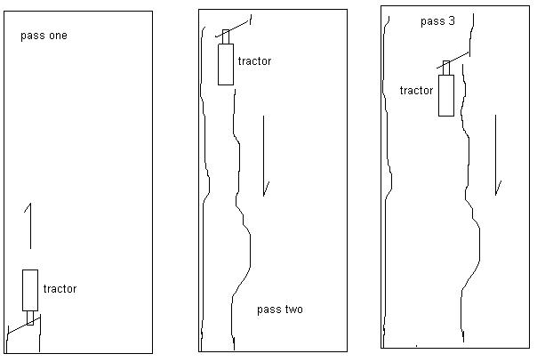

Yes by all means, don't let it get to deep.
This is how I did it last time and it seemed to work ok. Note that I have taken advantage of my blade's offset to set it. On my LP blade, I had to unbolt it and move the cutting edge over and then bolt it back on, but it works pretty good. :)

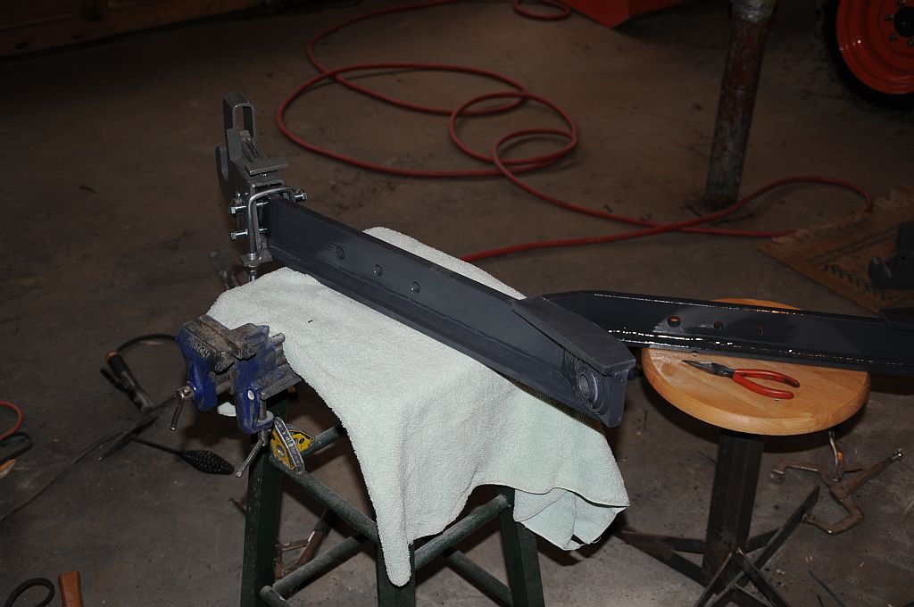

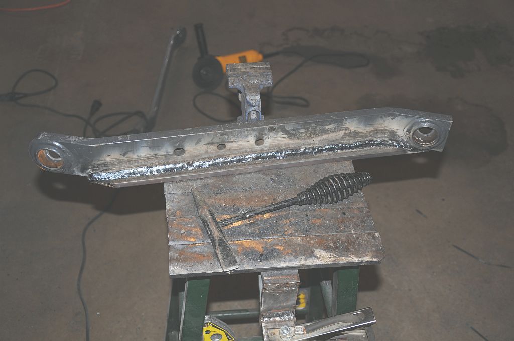

/ Snow removal strategy #17
I just came on here and did a search for "arms" because I broke one of mine this past weekend! Pushing 5' woods blade with my BX2350 backwards, caught the lip of a sandstone in my walkway, and crack. Snapped the 3pt hitch arm right in half, quickhitch smashed into my taillight and broke the lense, and bent the 3ph adjuster.
Don't know what I'm going to do yet. Have my brother weld it, or get a replacement.
I bent my links on my previous tractor by catching a frozen snow bank with the outer edge of my blade a few years back. 3RRL suggested a fix, which was adding a piece of flat stock to the bottom of the straightened link. I had no further bending over 4 years using it that way, but I also added skid shoes to my blade and go much more cautiously now. I purchased new links and made the modification to the new ones.... after I straightened the old link and did the modification just for the welding practice. When I got my new tractor, the first project I did was to reinforce the links as shown in the pictures. I use my blade a lot pushing it backwards like a plow, but have the shoes set for about 1/2 an inch and don't fetch up on things like I did when the blade had no shoes. Good luck.
