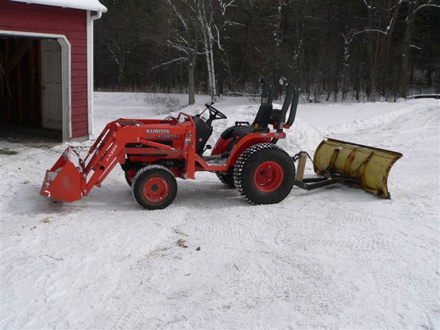

i purchased a 2320 in Jan of this year and plowed my 145' driveway all winter long with just the bucket (no rear ballast, no filled tired) and it worked great.
I have been plowing my fathers driveway for the last 25 years with the FEL bucket on his 2wd 2440 but i have been using chains because without4wd you second you hit an ice patch your all done.
This year i will be using a snowplow on my 2320 that i made, not that the bucket didnt work great, i just wanted the side to side tilt that a plow offers. It makes plowing a little faster with not so many passes.
Is spending is a concern, i would just stick with the bucket for this season... woeks just fine, plus, you can stack the snow higher!

I have a 200 ft flat, paved driveway that I plow with my 2305 FEL. I place the bucket flat on the pavement then slightly curl it so the edge isn't touching the driveway. I push from the road to the end of the driveway (usually in 4WD). Once there I stop just short of the end so I don't dig up the lawn. I lift the bucket 6 inches off the ground and push the pile a few feet onto the lawn.
This gets the majority of snow. I have to go back and pick up the windrows and dump them but that isn't too bad. Nothing wrong with a little FEL work!

I also use my 2305 with the FEL to plow and it works great. Just take your time and get used to using it on a driveway. Never got stuck in 4 wheel drive with the turf tires. I do run my box blade just for weight but I do not have loaded tires or wheel weights. The weight box is over kill.
This year I might try a carry all and put my walkbehind snowblower on it. That way if I need it I just drop the 3 point and clean a walk with the blower. I have to see if the weight will work.

We just got about 16" of lake effect snow here in NY and I had no trouble clearing it with my Kubota B7610 (24HP) with FEL, loaded turfs, a Woods RB60 rear blade, and NO chains. I normally clear four driveways; two of my own, about 150' each and two neighbors, both 100' or less...all are flat, two are paved.
This combination works so well, I keep putting off the snowblower that I intended to buy. With the right angle on the bucket, the FEL makes a very effective snow pusher for getting accumulation out of the way; while the rear blade lets me get down to bare pavement.
Beyond 4WD, the key seems to be the fluid in the rear tires and the fact that the RB60 can be allowed to float on the tilt axis. Cheaper rear blades don't allow this, so if the tractor is tilted (side-to-side), so is the blade....potentially causing the low end to dig in. Floating on the tilt axis allows the blade to conform to the angle of the plowed surface regardless of tractor tilt. The RB60 is more than a KK or Howse blade, but at $450 plus tax it shouldn't break the bank....and it'll be more help than carrying a box of rocks back there.
On the unpaved drives and when I wander off the side onto the grass, the rear blade will, of course, dig in if used normally. If the ground isn't frozen hard, turf comes up. But if you back into the snow with the convex side (rear) of the rear blade moving forward, you ride up over the gravel and turf doing little or no damage while still clearing the snow.
I have a larger 4WD tractor with 7' blade, FEL and loaded Ags. When I first saw this recent snowfall, I thought I'd need it for sure. Not so. The little B7610 had zero problems and did an excellent job. What you're proposing should be easily possible with the right rear blade and some fluid in the tires.
