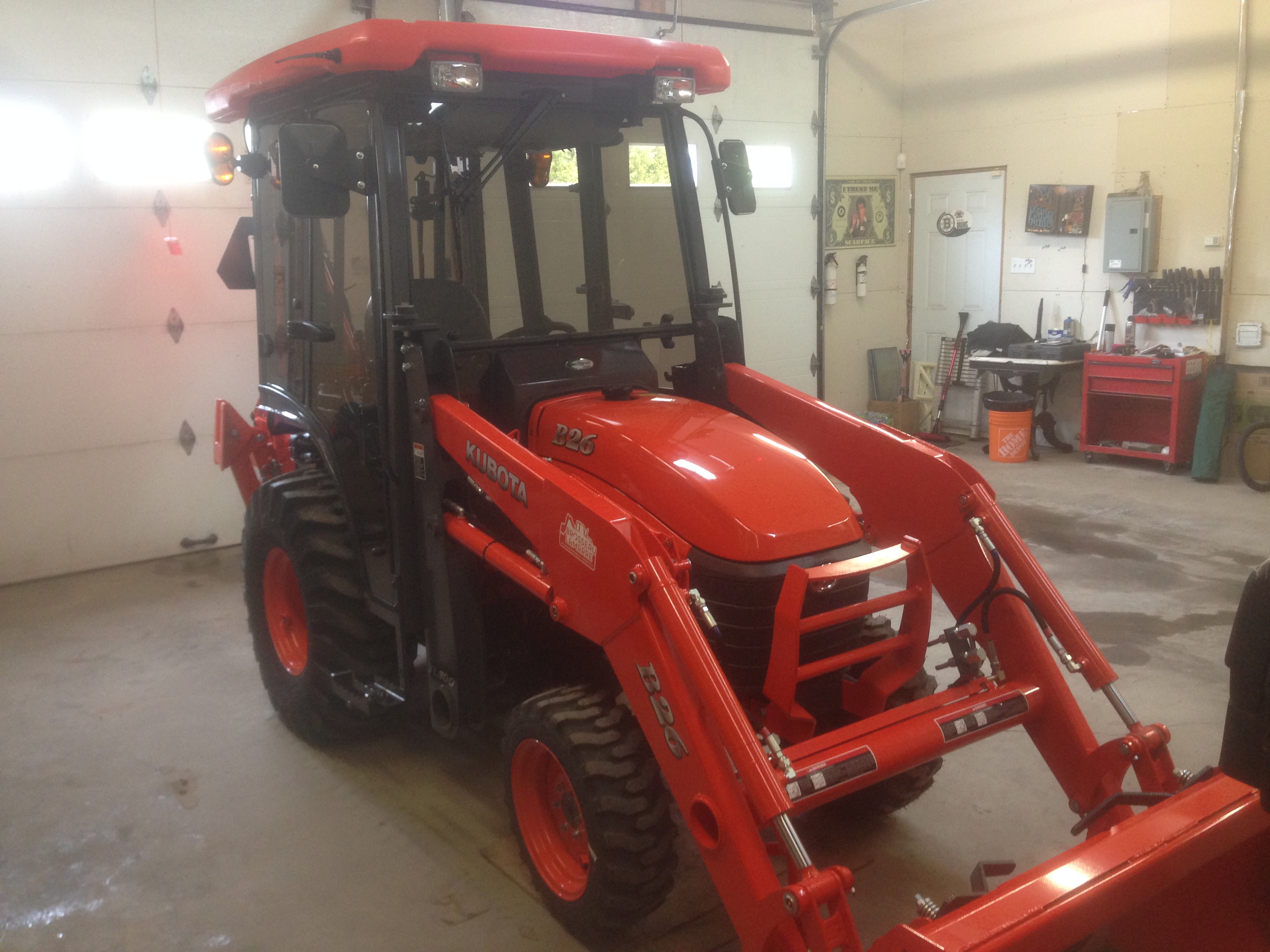

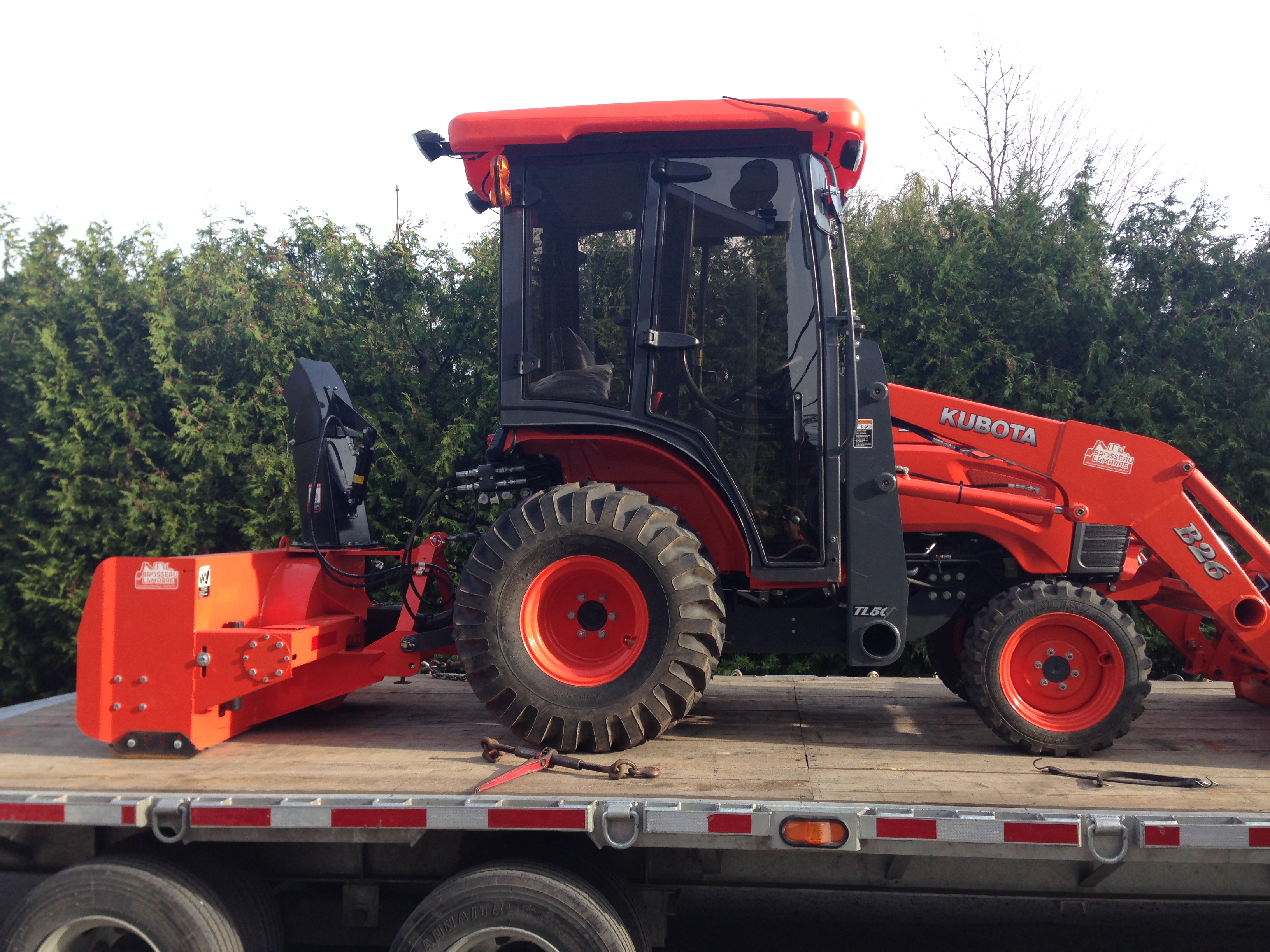

Here's my set up with a b26,64" rear blower and a laurin cab with heat...now when I turn my tractor on.it does return the favour .... IMG_2431.JPG
/ Snow removal options #51
Welcome winter,and a belated Merry Christmas and a happy new year also to all..
Just a recap on snow set ups...people were wondering about the b26 and the 64" rear blower...well it does bog down when going too fast through deep snow..but it handles it very smoothly and awesome...honestly who snow blows at 10 miles an hr any how....no ballast or chains or spacers...haven't got stuck yet! ( knock on wood ) ...with laurin cab and 64" kubota blower..is awesome and it handles snow quite well..people wanting and wondering if they should put rear blower on b26 please do..I recommend it..as for cramping neck by looking backwards easy fix..get side mirrors put on and adjust accordingly,.trial and error will get it all set right...where one would just use mirrors ....so on short b26,64" rear blower is awesome and handles it all...I do suggest if you got the means..laurin cab is the best....

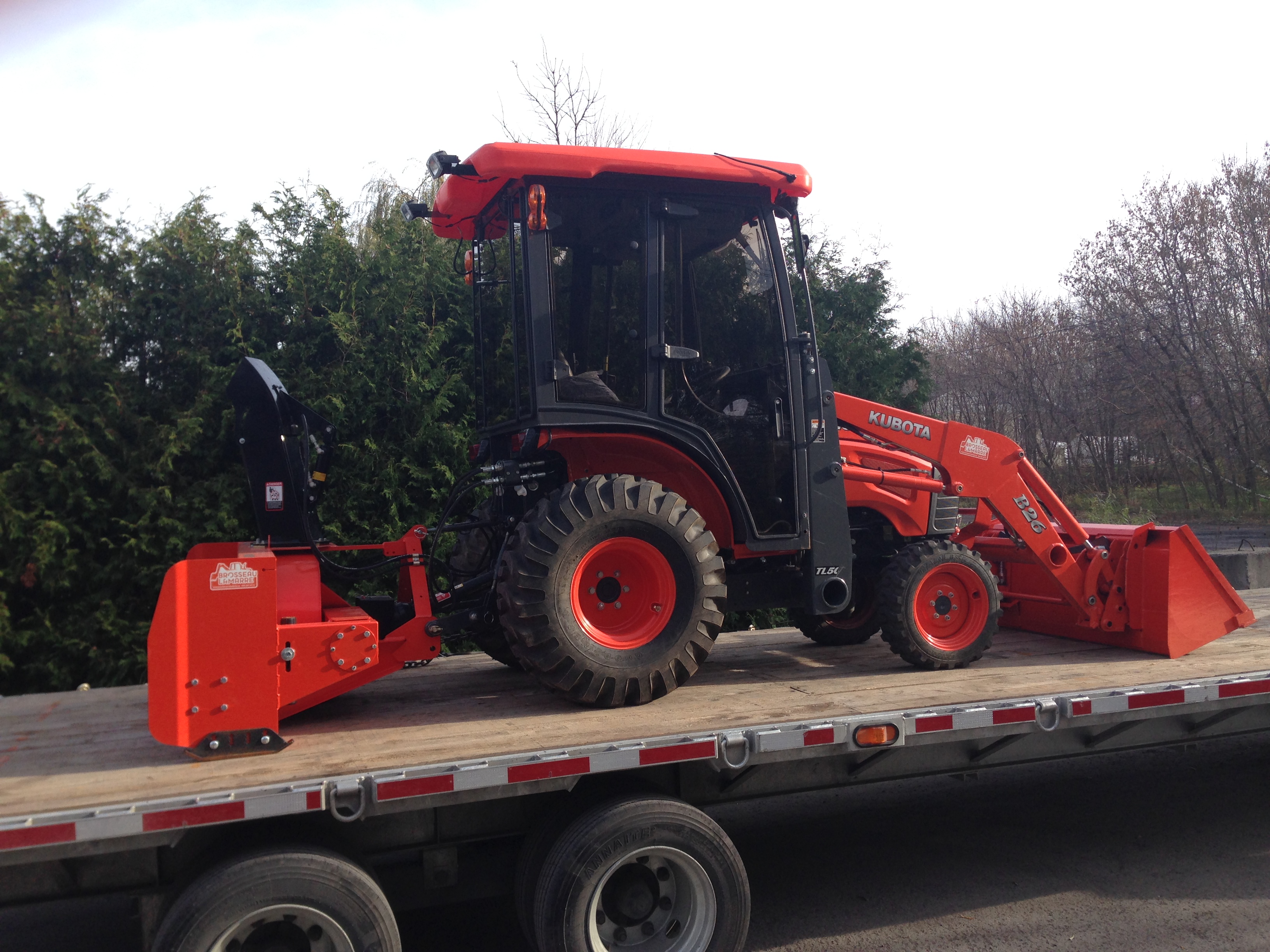

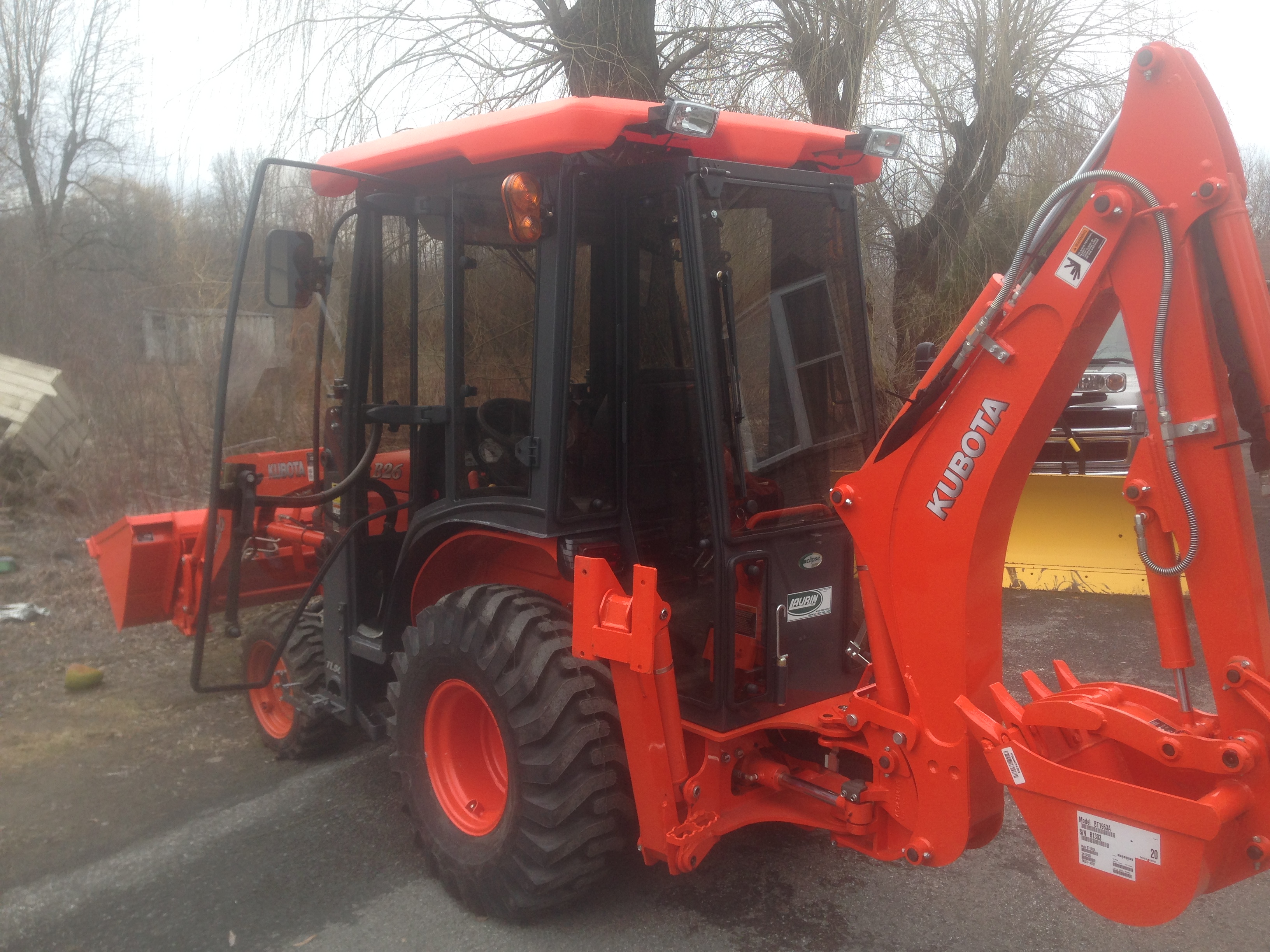

This is my first year with the B2650 and blower (64" like yours). I had no idea what to expect, with a 1000' gravel drive and huge parking areas, I had read all the stories of going through many shear pins.
We have had 3 measurable snowfalls so far, 2 of them (including the one I cleaned up yesterday) were wet heavy slushy and not nice to deal with. The blower and tractor (on turfs) performed flawlessly. No shear pins lost. Threw the wet snow like a champ.
Now I really baby my equipment, so I was going very slow taking my time, but so far I have zero complaints about my setup!20171210_101724.jpg
/ Snow removal options #53
Now I really baby my equipment, so I was going very slow taking my time, but so far I have zero complaints about my setup!View attachment 534650
Very nice setup , Nice and toasty warm :thumbsup:

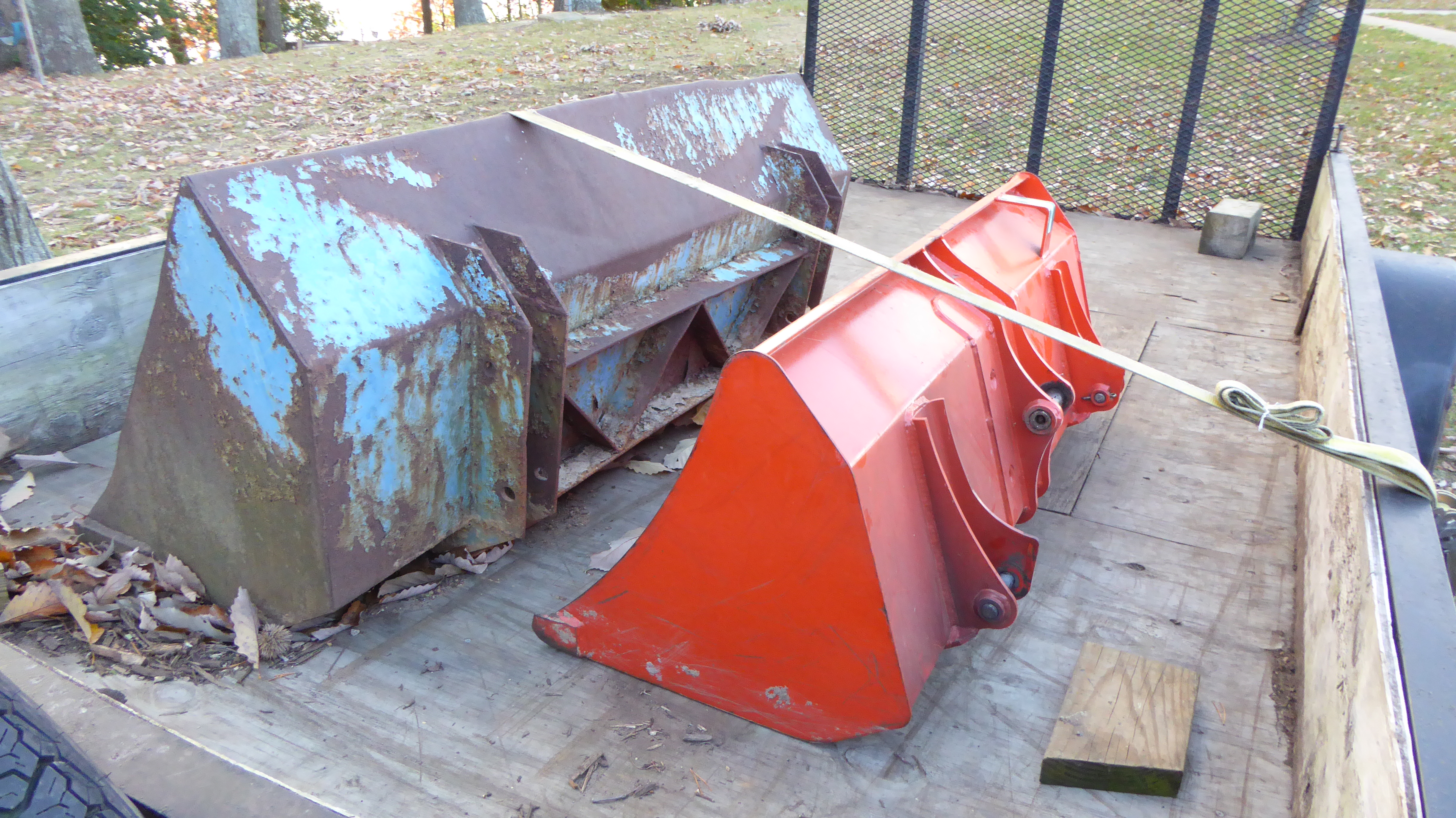

With those excuses, I found a beat up old used bucket (still very serviceable, not full of holes or rust damage) for $100 at auction; around 50% larger than the BX std bucket. Moves a LOT more snow per pass. I had a local Amish welding shop adapt the old bucket to fit the mount on my BX loader frame by putting some new mounting holes on the bucket. ($100) The welding shop also had some 1/2" thick hard plastic scrap (do not know if it is ultra high density super stuff or not.) I had him cut me 4 "skids" around 3" wide and a foot long for the bottom of the bigger bucket. I bolted those on using carriage bolts so i could minimize the heads sticking out. A few cans of black spray paint and minor grinding and wire brushing for looks. Total project under $250.
