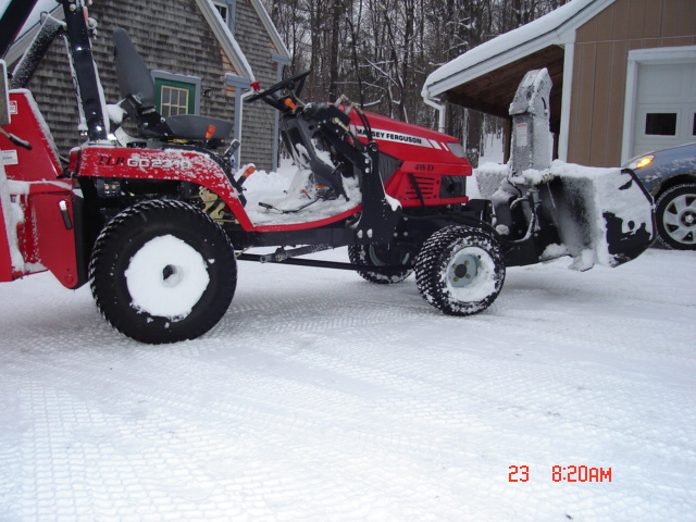

I have a B21 and rear mount blade for the winter and a 28" walk behind blower to clear the woodpile, pathways, oil tank, and tight spots. Drive is about 200' with a large paved area 50x70 to clear. I use the FEL going forward and in reverse drop the back blade so get FW/BW clearing.
Considered using some bucket edge but once it is broken in (rounded a bit) it doesnt dig in to the pavement unless I am removing ice/packed snow. The snowblower helps with deeper snow too where I have limited push areas due to large Rhodendron's lining the driveway.
So it sounds like you have a good setup now and if/when needed you can add a rear blade when you move to another area w/o a lot of expense.

I have a B26 too but my driveway is in gravel and hilly. I bought a Pronovost rear mounted blower and I use the FEL to clear small spots here and there. The blower is top quality but the only complaint I have (which isn't really the blower's fault) is broken shear bolts. Even though I'd rather have a broken shear bolt than something a lot more expensive break, it's still a PIA to take my gloves off at -30c to change a shear bolt. I sort of got lazy and bought a small Pelican case which I bolted to the top of the blower. The waterproof case holds spare bolts and tools to change the bolt (1/4 socket wrench, socket, small vice grip etc).

I just got some literature from Skid Steer Attachments - Bobcat - Compact Tractor - Loader - Attachments Direct, Inc. and they have a 3-point rear pull PTO snowblower. Not sure how well it would work in deep snow, considering your tractor needs to be able to drive through the snow before clearing it. Plus the fact that its packing it down as you drive over it. Looks good though. I'll start another thread and see if anyone out there is using one.
/ Snow removal options #34
If you go to www.plowsite.com you will se a lot of folks with inverted blowers but they are using larger heavier tractors that will sink in the snow and have no issues with traction and with an open station tractor, very messy if the wind shifts if you do not have a spout extension.
Inverted blowers are designed for cramped areas that a front or rear mount blower would be unable to take care of as there is no room to throw it with accuracy; typically the inverted will throw it forward to the left or right depending upon the attachment point on the blower housing.
The pronovost line has three of them from what I remember.
You may be better off buying a pair of front mounted snow blowers
(having one as a spare) for (1) MTD Cub Cadet of 24+ horse power and get a soft cab, Chains, and wheel weights for it, as you will have spent less money if you dont want a standard rear mount blower.
the nice thing about a rear mount forward casting blower is if you travel slowly you dont have worry about constantly looking forward and back as the front wheels will be following the rear wheels following the blower housing.
