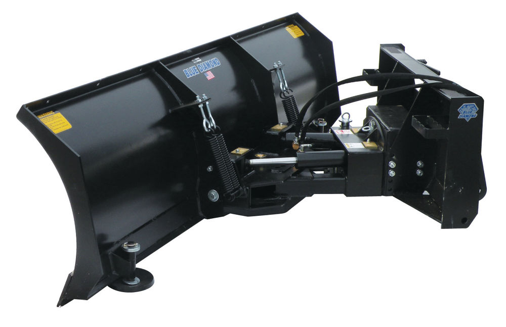

Most center around the dozer blade - it is a sunk cost after all - thought that I would attach a picture:
Note that this is not a reversible blade - it cannot be pulled, only can push.

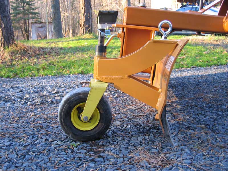

The gauge wheel idea is intriguing...perhaps a pair of brush hog tail wheels? Would need to weld on new yoke brackets higher up the blade as the existing skid shoe brackets are too close to the ground. Would be nice if the wheel assy swiveled....easier on the driveway, I would think.

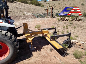

Something like this, except on a rear blade instead. Everything attachments wants $339 for a set of bush hog wheels. Pricey but they look stout and have good floatation.
