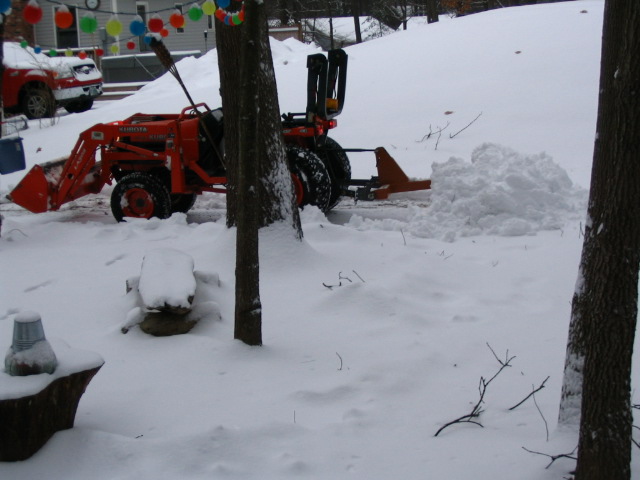

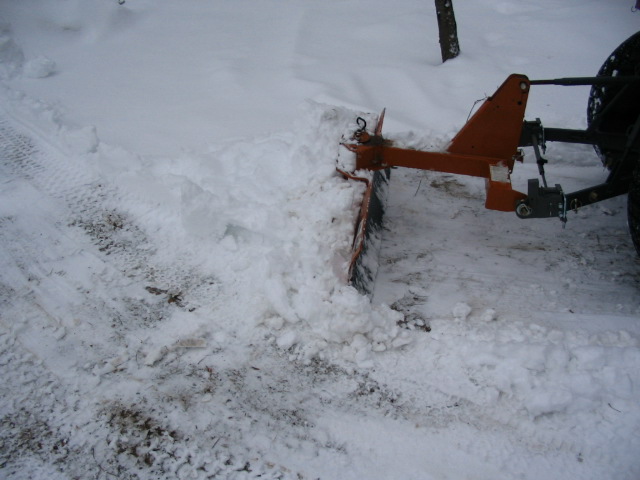

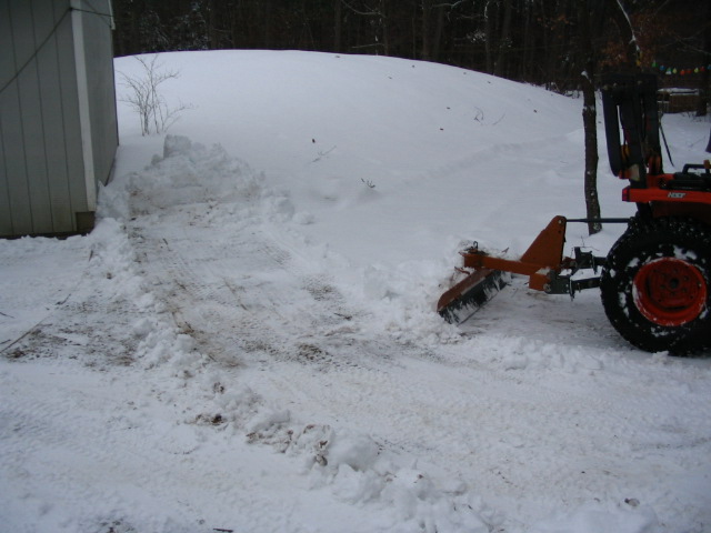

I have 4 surface types that I need to clear on my property, Asphalt driveway, compacted nit-pak parking area, pea stone parking area, and my rear lawn...
Yes, I said lawn.. Just a path to my fire pit and cord wood for heating.
I have at my disposal My FEL, 6.5 foot plow mounted to my bucket, my 5' rear grader blade, and my walk behind JD snow blower.
The last one is out, Who wants to use a walk behind when we can be hving fun on the tractor.....
Both my pea stone area and lawn are uneven terrain, There are even raised roots by my canvas garage out back....
This winter has been cold, warm, cold so the ground is less than frozen..No matter how careful I am with my FEL in/out of float, my plow or the grader blade the pea stone and lawn take a BEATING.....
NOT Today..Think ouside the box.... I ended up pushing the snow in reverse with the back of the grader blade and it worked Great. The reverse curve, Floats nicely over the uneven terrain, no hard corners to gouge into the earth, and surprisingly remained in good contact with the surface and still managed to push a large pile of the white stuff....
If you have those "sensitive" areas, give it a try.....

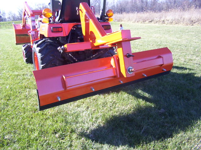

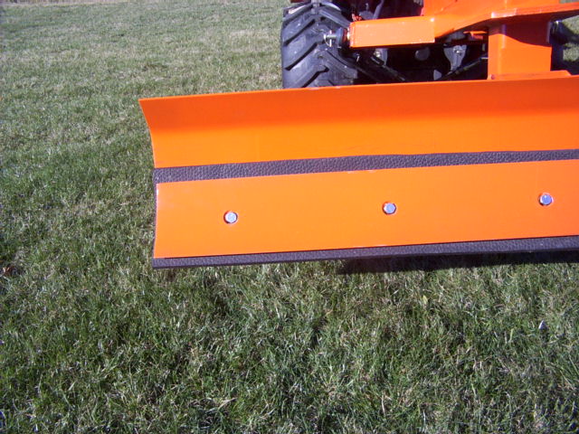

I do it the same way as Ace3 does except I don't turn it back around to do the road mainly because it isn't frozen hard enough yet.
LQPAPPY suggested I use a 3" piece of PVC pipe. Cut a slit in it and slide it over the blade so there won't be a sharp edge.
Someone else suggested to cut a piece of horse stall mat and sandwich it between the cutting edge and the blade letting a little hang down so the edge won't cut. Anyone want to split the cost of a stall mat?:rolleyes:
Think I might try that. It's snowing/sleeting here now so we will see what happens.
The horse mat is not too cheap, is it! I thought about cutting mine into strips and selling the extras on here :) Instead, I use the remainder of the mat to protect my floor when taking the loader on and off in the garage. If you know of one nearby, stop by a truck tire retread plant...they may have an old obsolete piece of tread that they might give you or sell cheap. It might not be as thick as the horse mat depending on what you can find, but worth a shot if you don't want to drop the $50 or so on the mat.

Wow Bandaman took the words out of my mouth, I cut a 5" strip off of a horse mat and mounted it between the blade and cutting edge. I keep the remainder as flooring on the cold concrete. When I wear out the strip (which at the rate of our mid Maryland snowfalls should be never) I'll just cut another 5" off.....
