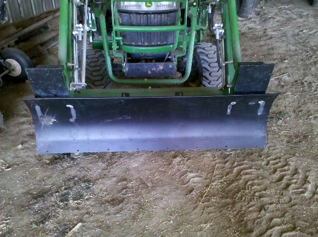

I had this welded up a while ago. Though it is just a blade not a pusher, it is 54" wide. I have ~250$ in it, both the blade and the QA brackets came from ebay. The plow is an ATV type and is the same is what they sell at cyclecountry.com. I have also mounted a piece of truck tire to use as the cutting edge.
They also sell on the same site sides to make the plow a box. The only problem with it is...I haven't been able to use it.
I got a chance to use it last night. I think it works real well. Though I can see where others do not like this setup as down pressure on the blade can cause your front tires to be off the ground :eek: But I don't have a big drop off or curves or a big hill either.
