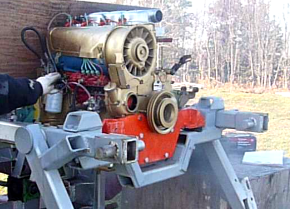

You might look into the clutch housings as used on irrigation engines. I know they make them for PTO shaft drives and would expect they have them for belt drive also. That would give you a set up that could take the side pull of belts. Lots of 6BTs are used for irrigation, so you might find one used.

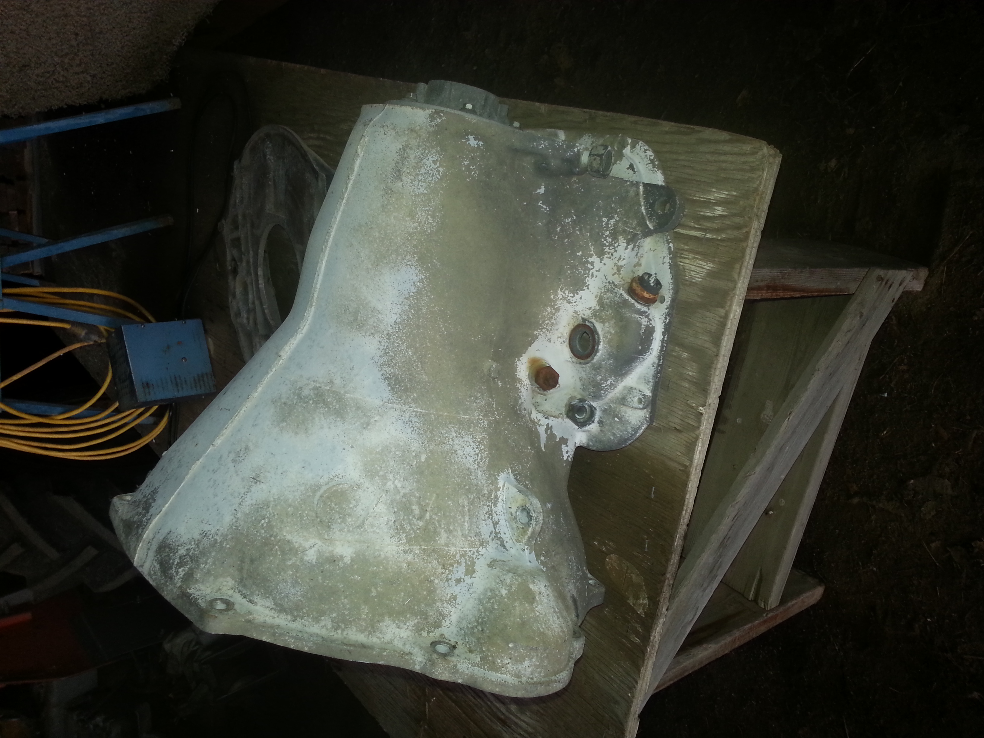

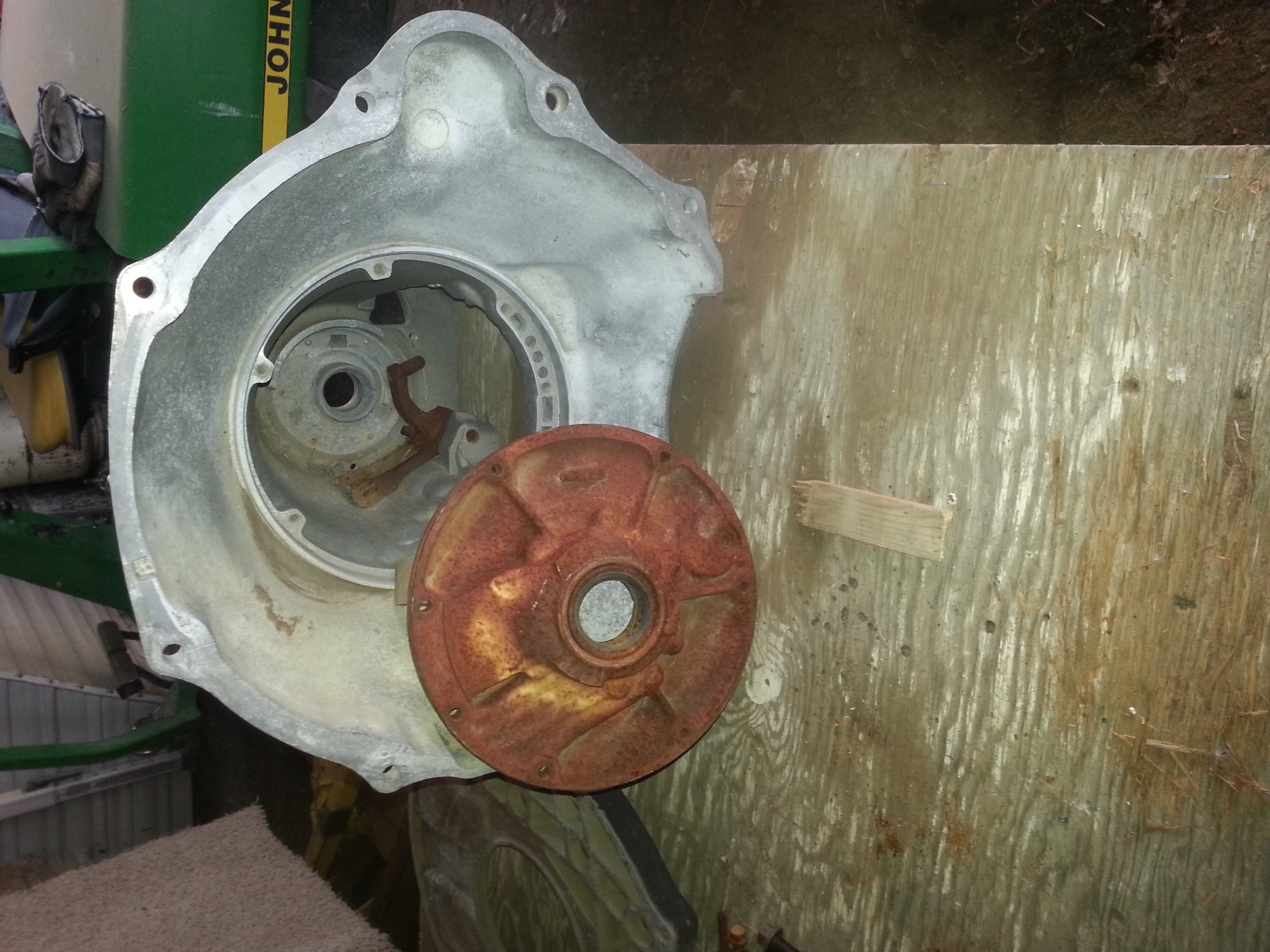

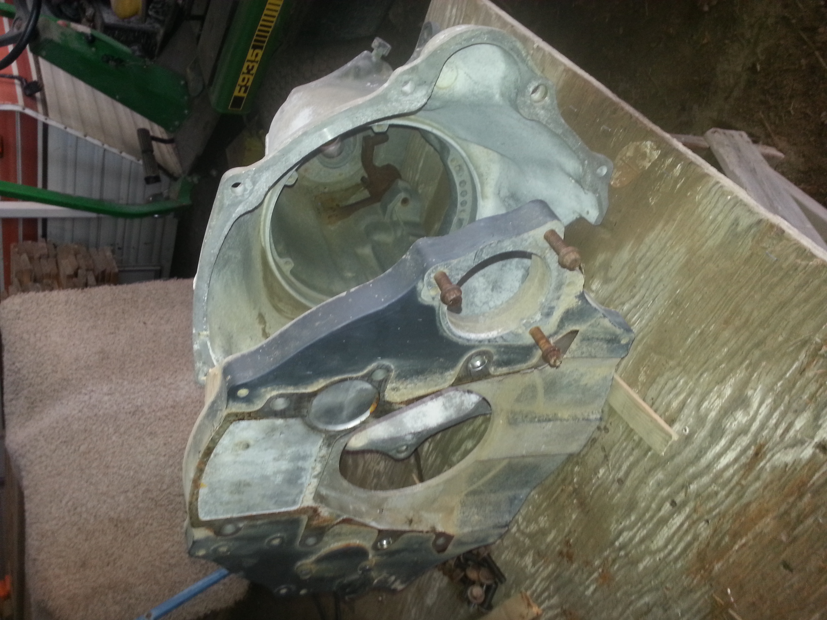

OK I sent these from my phone and I'll edit them on my laptop because that's just easier.
The first picture shows an adaptor and bell housing from a wreaked Chrysler 727 transmission. Notice the starter bolts and the 8 holes where it bolts onto the engine. I noticed that the Cummins you have still has this adaptor installed. They come in different configurations for different transmissions and flywheels. Notice how much narrower it is than the picture of the SAE housing I posted in post #108.
The second picture is of the pump housing of the 727. This would be really easy to machine out for a support bearing for an output shaft.
The third picture shows the transmission case from the side. It would be easy enough to modify the case so that you can run a belt if you end up going that way.

Did you get my email? I'll revisit his topic in due time but if I use a transmission it's likely to be a manual, my ideas for an automatic have pretty well been shot down in flames here. If I use a transmission then the stock front and mid-side mount will be ok but if i use belts then I gotta have side-supports right there at he flywheel. I'm not sure if I would have the guts to start chopping an aluminum housing but for a belt, if I cannot find an industrial adaptor with side support provisions, I thought of a 7/16" adaptor plate cut out as a ring and snuk in under the flywheel adaptor using longer bolts, and on the sides forming two supports. It would in effect be a single mount with two side attachment points to the frame. I did something vaguely similar with the Deutz front end for increased stability and safety.

Your idea for a 7/16" adaptor will work but you can't put it between the adaptor plate and the engine. It'll move the relationship of the starter to the flywheel. Just bolt it onto the adaptor.
I just posted the pictures of the various bell housing arrangements so that you and others could see that there are different options when it comes to a Cummins.
There are several different automatics from through the years. Automotive manuals include a Getrag on the 1st gens. Then came the New Process 4500 and 5600. The last one is a Mercedes G-56.
The adaptor/bellhousing assembly I posted in post #108 is to install an Eaton/Fuller roadranger style transmission behind a Cummins. Actually Allison automatics out of a larger truck could also be installed with the same bellhousing as it has an SAE 2 or 3 flange. I don't remember which. As soon as you have an SAE flange then anything with a corresponding flange can be made to work. Your options then are just about unlimited.
